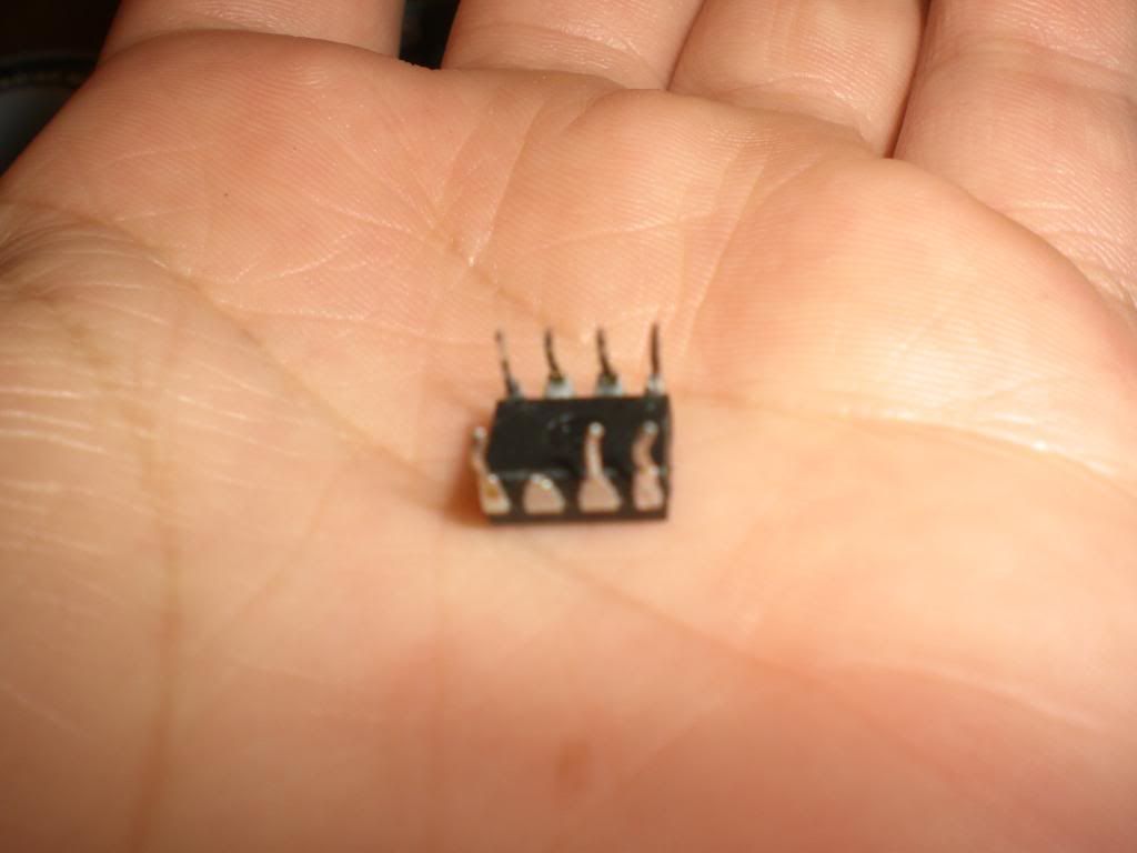

Alright, well I'll just sort of bank on that I didn't break any with heat...I'll look into that more when I have no other choices.
Personally, I would just get a new one and insert it into the socket that I would solder in there. it is possible to solder a small wire onto the broken leg, but... How did the new one get broken? if it was removed from something by desoldering it, I'd just throw it away.
It broke off during one of the times I was messing with soldering and re-soldering it. I figured I'd just have to get a new one.
A socket? Like something that goes in there and then you can easily insert and take out different chips? I have one of those. Tried it twice, both times no luck, but I'll try again and buy a new chip to try out.

Thanks so much for the help, it really has shined some light on my situation. I'll try buying a new chip online, installing the socket and try out the new chip.
Does it matter which way the chip is oriented when I install it? Also does it matter which way the socket is oriented?
Thanks again for the help!
-Elliot
Yes, one of those. If you can solder the the chip in there, there is no reason that you can't solder a socket, although some have smaller pins than the IC does. Here is a link to an 8 pin DIP socket from Radio Shack - socket That is a cheap one, better ones have a ceramic body and / or gold plated pins.
Yes, the chip must be in the right way to function and not get blown instantly on power up, although not every chip will necessarily be blown if reversed. There may be a marking on the top of the board, like just a "1" (or a "pin 1) indicating pin 1. Otherwise, if you don't know, try and find a pic of it installed in your unit. The notch on one end of the chip is what you index - hold the chip in front of you with the notch toward the ceiling. The pin on the top left is #1. No, the socket does not have to be oriented any particular way.
The pins on an IC are spaced just a bit wider than the socket, actually, they are angled outward, and you have to adjust them a bit to be able to insert it in the socket. There is a thing called an insertion tool which does that, but I never used it. What I would do is press one side the IC down with one row of the pins down flat on the table and roll it a few degrees to bend all the pins evenly, and just a little bit. Then I would do the other side. The goal is to get them more perpendicular to the body of the chip so they will line up well with the socket pins.
