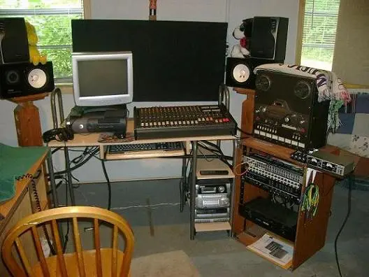

This is the best solution I've come up with so far. I didn't have the desk room, so I had to build a shelf for it. (See right). I've got easy access to the back, though I still have to bend down a good ways to see the meters when I'm in my chair.
