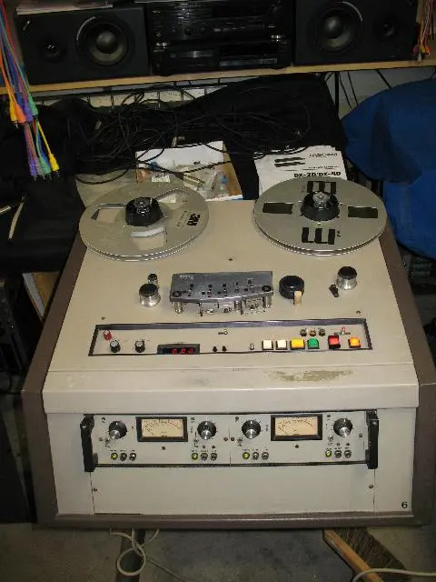

Well, I just got back from a trip from Portland to San Francisco over the weekend to puck up a deck that I bought.
It is a well maintained MCI JH-110A 1/4" halftrack. This unit can take 14" reels and plays at 7.5, 15 and 30 ips. Heads have low hours on a JRF relap and in general everything appears to work. Just a little dust.
It does have some red sockets.:eek: but they are looking OK. I'll get some time on the machine before I replace them.
This is my first MCI so I'm on the learning curve. I'm looking for a manual, notes, spare parts, 1/2" 2 track heads and rollers :) and all the other things that go with a deck. (operations and maintance manuals that is)
Oh yes, and some space to put it on the "studio".
It does have a noisy bearing on the pinch roller so Sweetbeats, where are you buying bearings?
Regards, Ethan

If I knew you were coming to the Bay Area, I'd have bought you a burrito :)
"It is a well maintained MCI JH-110A 1/4" halftrack. This unit can take 14" reels and plays at 7.5, 15 and 30 ips. Heads have low hours on a JRF relap and in general everything appears to work."
droooool!
nice deck!
Ethan, try VXB Bearing. That's where I got the bearings for my 440-8. The website is a little kludgey when trying to search for specifics but if you don't mind wading through all the 608Z bearings (for instance), its not bad. I spent a little more money for ABEC-7 bearings with ceramic balls, sealed and stainless races. Probably overkill but a pack of 10 was, like, $15.
Your MCI probably uses a fairly standard size...608, 622, etc.

SCORE! Looks just like mine (no red sockets though). There is a guy in Nashville, Chris Mara, who is an MCI guru.
I'm sure he would know where to get parts. PM me and Ill shoot you his contact info.
