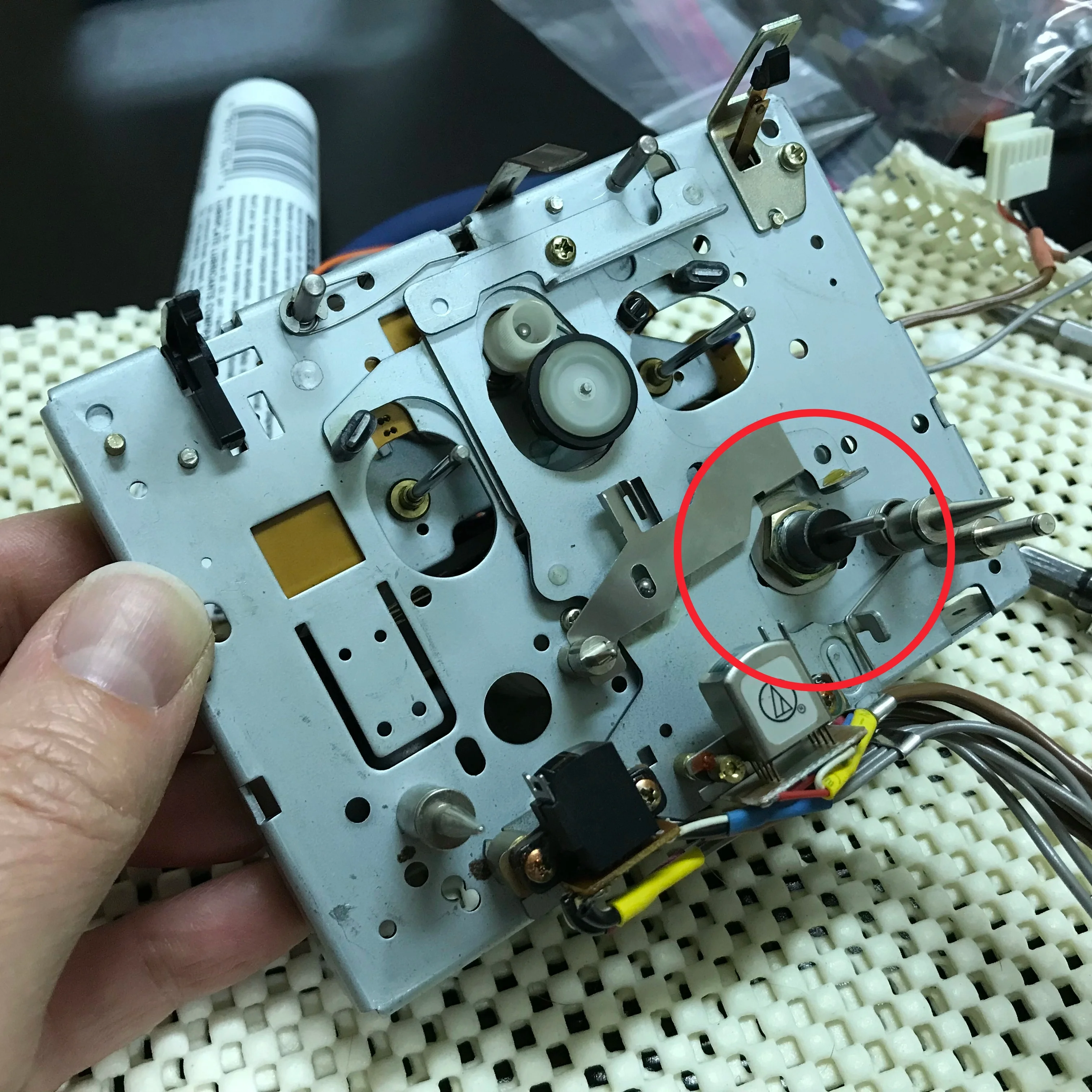

Is it easy to oil capstan motor by not disassembling it? Could you show me with an arrow in your pic below the right point I should oil in? I've oiled capstan shafts the common way by just removing washer , pull off spindle by hand & put 1 drop of oil. Here I can see there's another bronze washer underneath that first black "washer area"..
