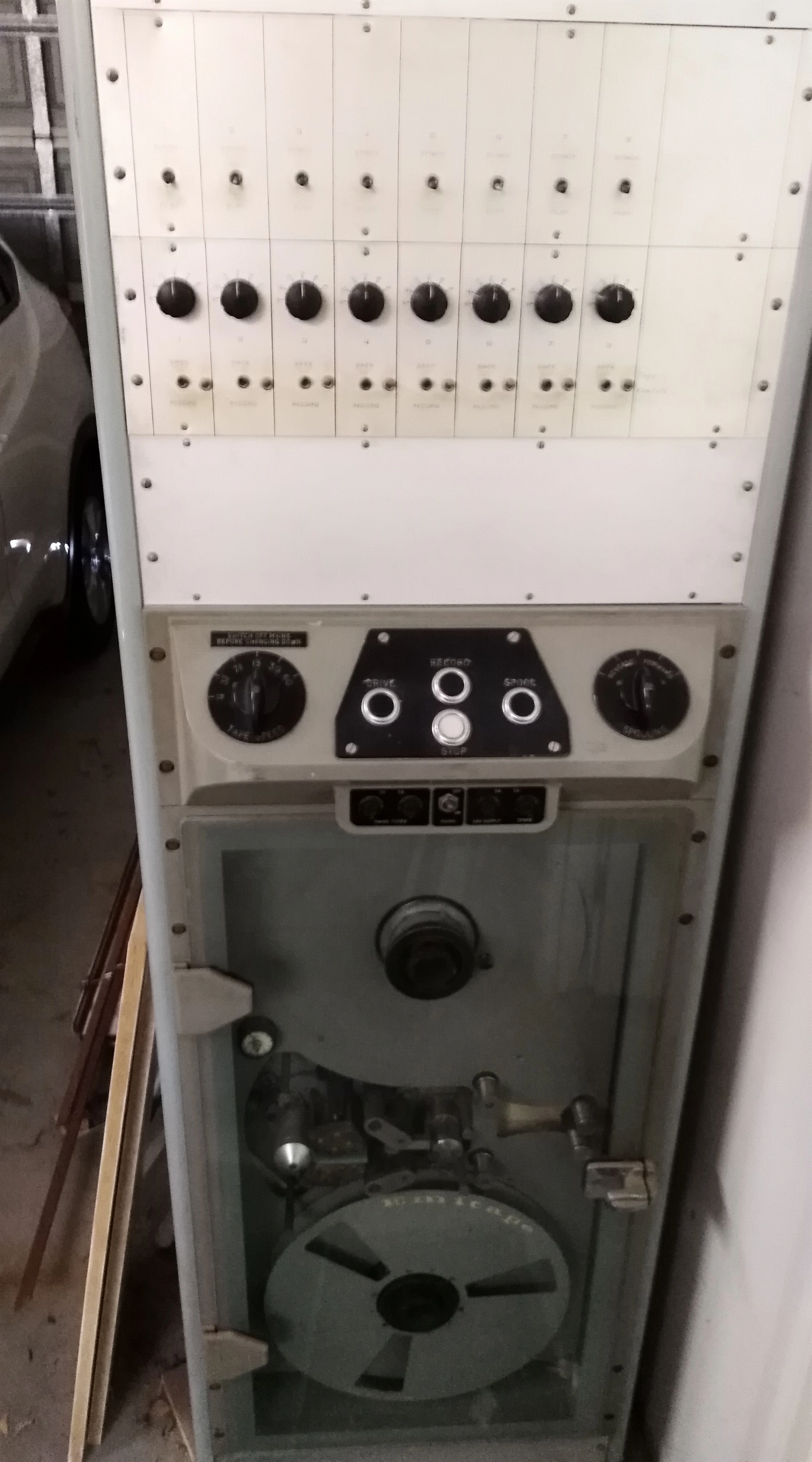

Re you request for info on the 8-track recorder, I have included at the end of this reply a photo (not a very good one !!!!) of the unit.
To answer your questions
The deck (an EMI Data Deck) was initially purchased by the local racing authority (about 1965) for their data logging, but between the time it had been ordered and delivered it had apparently been decided to go in a different direction. I happened to be in the Chief Engineer's office (on an unrelated matter) and saw the cardboard box containing the deck sitting in a corner. I asked what it was, what is was going to be used for, etc and was told that it was going to be dumped. I asked if I could have it and the rest is history.
I was responsible for building all of the electronics --- uses a most innovative circuit design --- I was very good at this type of design !!!!!
You will notice that the unit has no Vu meters, this is because at the same time a new console was also designed and built for a new studio I was constructing and as the recorder was going to be used exclusively with that console, it was decided (to save some money !!!) that the output stage of the console would be the input stage of the recorder, hence the console's meters were the recorder's meters as well.
For the heads I used what was, at the time possibly the most popular multi-track recorder brand's heads, those being Scully. The heads were placed such that the erase and record heads were mounted on a block (situated just above the bottom spool in the photo) and because of space limitations the playback head was placed almost directly above this block (just under where the top spool would be).
The result of this unusual head spacing, was that the distance from the record head, past the silver tipped roller (on the LHS) to the playback head was exactly 15 inches (this became most important later when the machine was put into use, but was not planned in the design stage), because at 15ips (the then standard professional recording speed) the time taken for the tape to travel between the record head and playback head was exactly 15 inches or exactly 1 second (or multiples or divides of that at the other speeds).
The actual speeds available in ips were -- 15/16th, 1 7/8th, 3 3/4, 7 1/2, 15, 30, 60, 120 (front switchable) and 11 1/4, 22 1/2, 45, 90 (selected from the rear of the recorder).
With all of these speeds coupled with the distance between the record and playback heads, the echo effects possible were amazing and resulted in effects that no other studio in the world (to the best of my knowledge) could achieve --- and effects that I doubt could be achieved today with most/any DAWs.
So consider the effect of (say) a guitar that had been recorded at 15ips which was then played back at (say) 7 1/2ips and an then a second guitar track then being recorded at this (say) 7 1/2 ips speed, while also looping the playback head of this second guitar track back into the new recorded track as it was being recorded.
Now the original guitar track would be heard at half speed and also an octave lower, so that when this overdub tack was being recorded while listening to the original track, it would now be possible for the guitarist to play twice the number of notes per bar. ALTHOUGH it was essential that the second guitar track was played in PERFECT sync with the original --- something that became VERY difficult and requiring only the best of guitarists (musicians), when the replay speed of the original 15ips track was played back and re-recorded at even lower speed.
Now when the recorder was returned to its normal 15ips speed, the 7 1/2ips overdubbed guitar would now be heard at an octave higher (more like a mandolin or similar) and the notes played at twice the speed. Add to this any looped echo that might have been recorded during this overdubbed recording and you can imagine quite an amazing sound would be heard.
Conversely if the original 15ips recording was played back at (say) 30ips and another guitar track was recorded at this speed (damn hard to get right !!!) when played back at 15ips it would be an octave lower in pitch and the sound quite drawn out, now also consider any loopng that might have been applied.
We used this effect mainly on guitars but also used it (with amazing sounds being produced) on flute and strings.
We were lucky to find a group of musicians who could actually handle all of this because what ever was being recorded by them was being heard through their headphones (echos and all). Most musicians (even the most highly sought after studio musicians) could not handle the recording method.
To give you an idea of what the recorder could do I have included a short snippet of a song (full song won a number of awards) that consisted of piano, 12string acoustic, 6 string electric and vocal and used all 12 speeds, with everything you hear being recorded as each track was being recorded --- there were absolutely no external or post recording effects used, everything was done within the recorder at the time of recording the individual track. The entire recording from memory took about 30+ hours to put down and consisted of the artist playing the instruments and singing with myself at the console making/recording all the sounds/effects --- 90+% of the sound was pure experimentation.
After the recording of the individual tracks (including a couple of track bounces to give us more tracks) all that had to be done was the actual mixing of the tracks to the stereo master.
I have "hopefully" uploaded a short segment of this track at the link below.
JJF by CSP | Free Listening on SoundCloud
Sorry if it doesn't work but I have tried about ten times and get an error message each time, so I have no idea how to upload it ----- bummer !!!
I have also included below the rather bad photo I took a few years ago of the 8-track recorder. The photo shows the unit with the head cover removed.
A coupler of things I did not mention was that there are two pinch rollers on either side of the capstan spindle (you can see one at about a 60deg angle just above the writing on the spool) and for tape tension there is a complicated system of two moving tension arms that unlike the tension arms on normal recorders always apply the exact correct voltage and therefore tension to the spools up to the point that the very last piece of tape passes over the capstan spindle --- providing that the recorder's piles don't play up !!!!!!!!!!!
You will also possibly note that the recorder can accommodate up to 14inch spools, although we only ever used 10 inch, so that a recorded tape could be taken by a client to another studio for extra recording if required.
You will also notice the glass door on the unit, this door is rubber sealed and inside there is a small pipe that by a clever blowing system (caused by the capstan motors cooling fans) causes a slight pressure build up and thus stops any dust from entering the tape area and possibly scratching the heads or falling onto the tape and thus damaging the tape (or heads) as the tape passes over the various components along the tape path.
Hope all the above answers your various questions.
David
