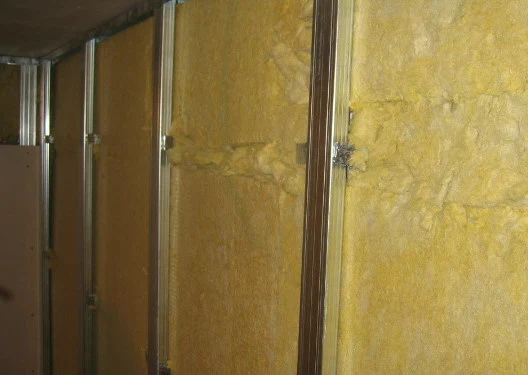

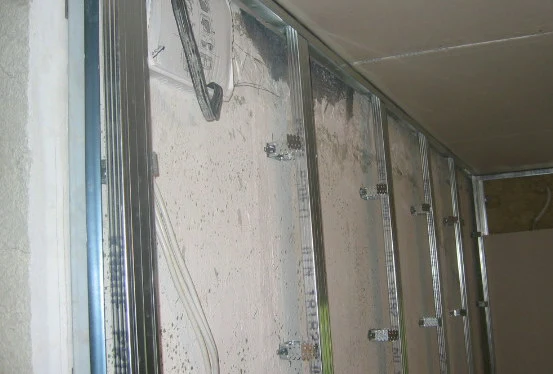

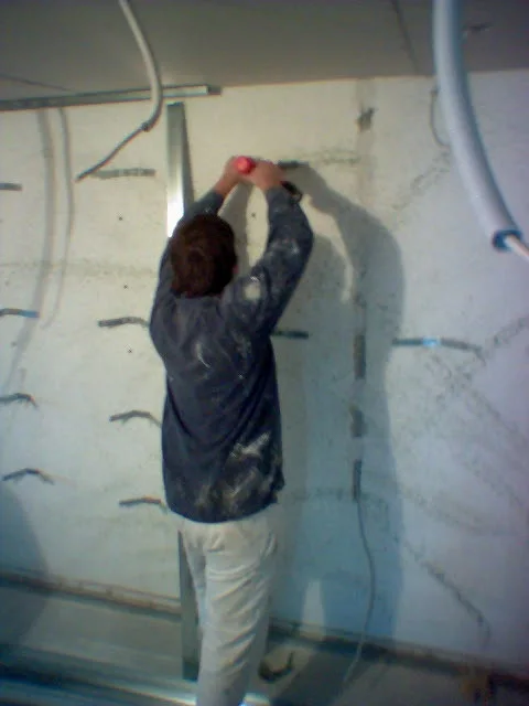

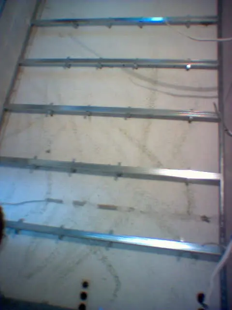

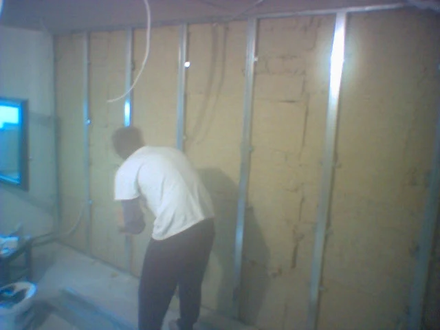

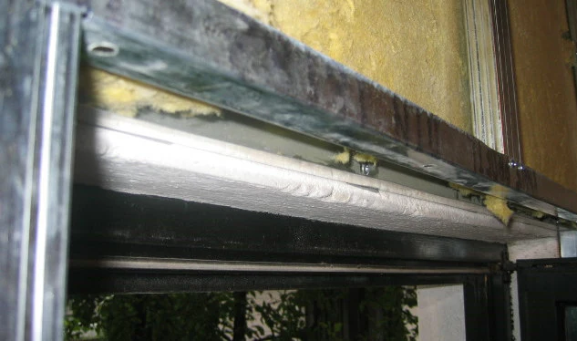

Previous photo's are from a stage we were building counstruction for the plasterboard. Between the palsterboard and the existing walls i put 2,5''rocwoll and an 1,5'' air gap. Dont know if it doeas anything though, but i had no choice beacuse of the construction panels, (width)

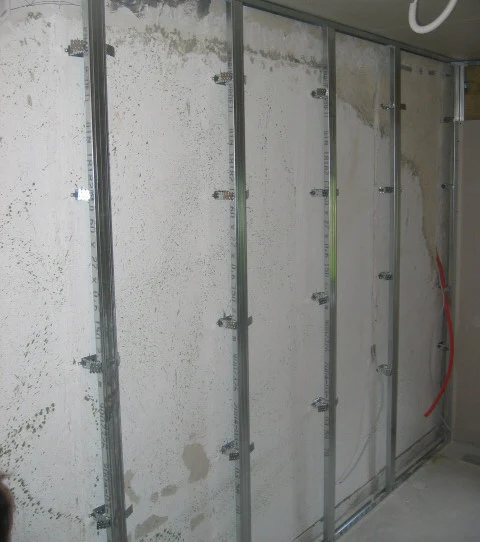

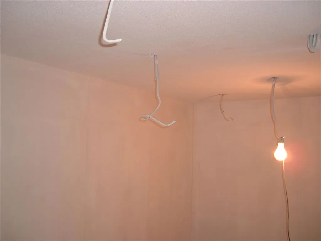

Here are some more
THe channels i used are very similar to what you described fitz. Too bad i dont have any close ups of them. :(

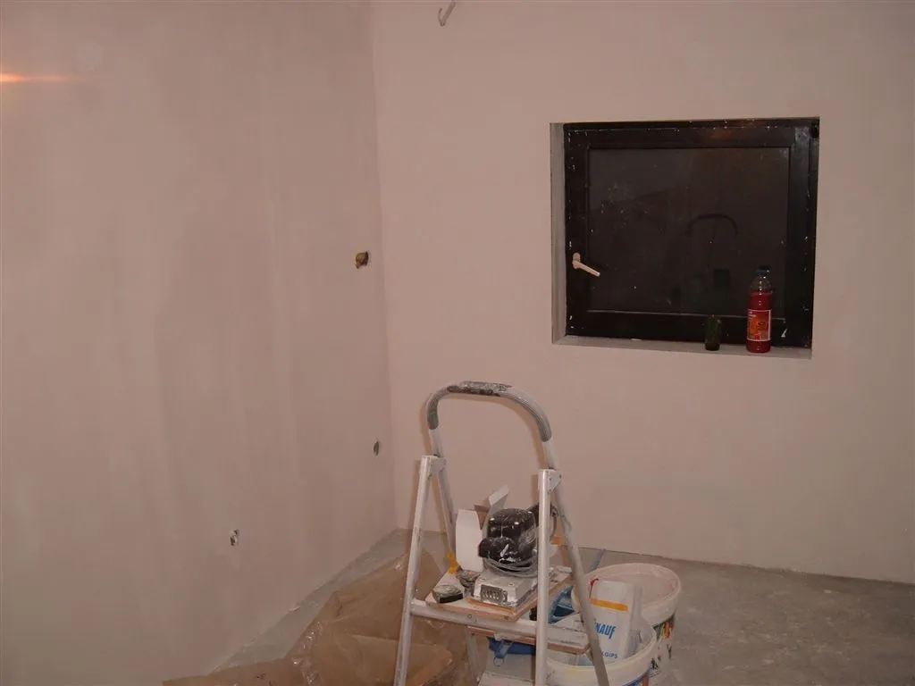

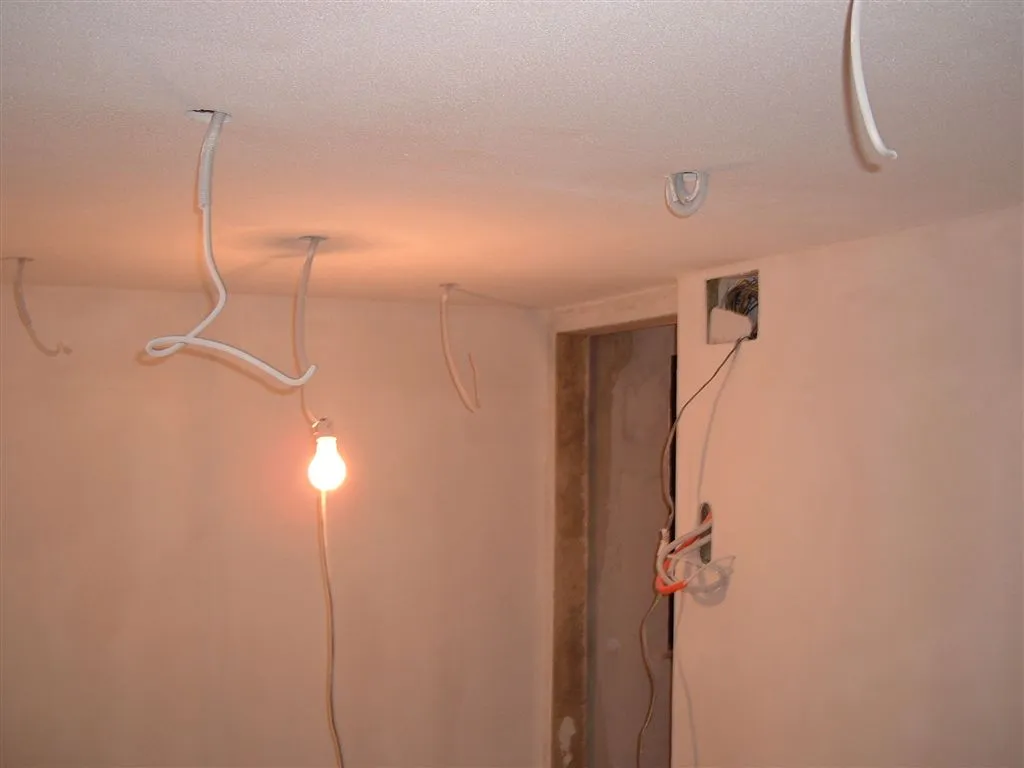

And the alomst final stage. Finishing the plasterboard and painting.
I will go for a white wall, blue carpet style.
And the chair is still to be re-furnished. Any suggestions, what colour?
I was thinking red or purple!
