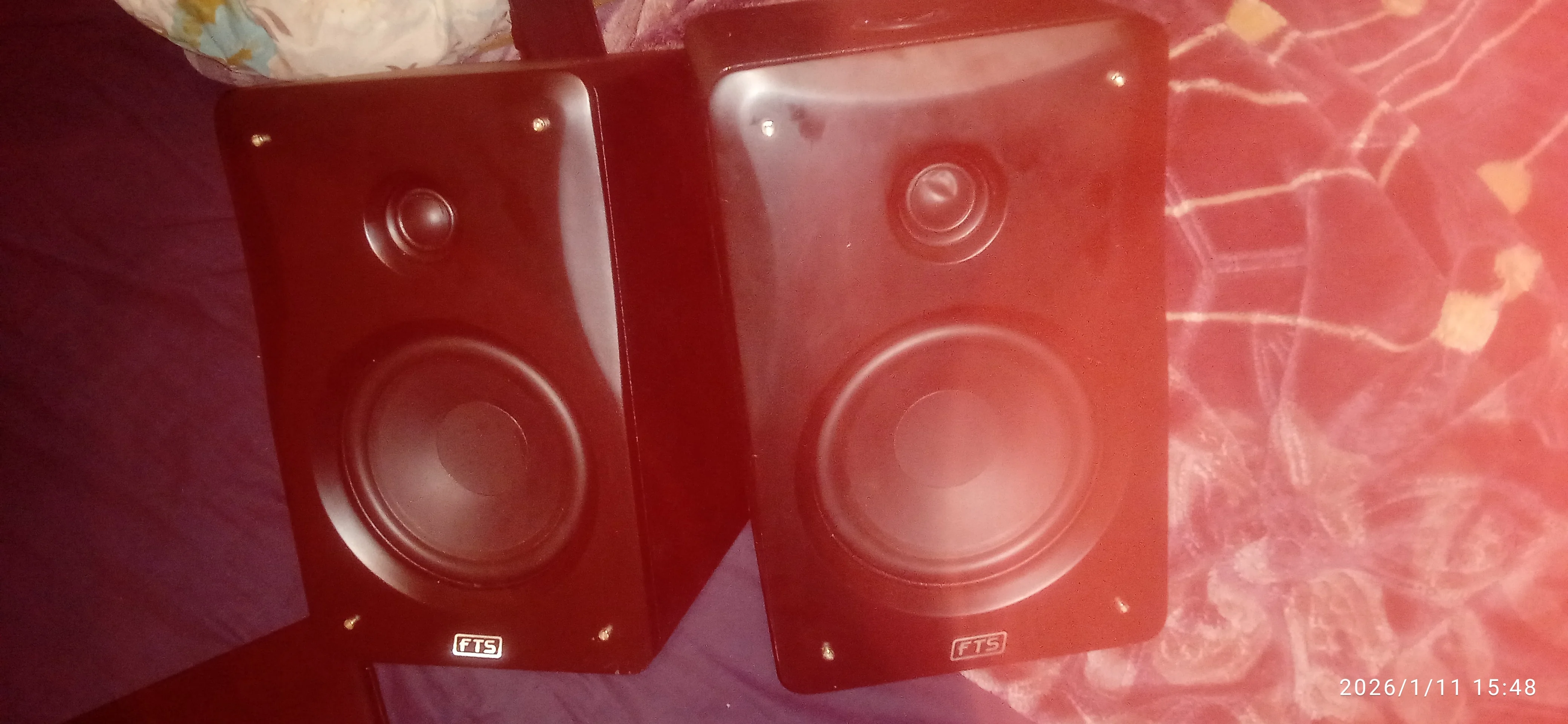

What is the make and model of your monitors?
These are my studio monitors it's not a big brand but they sound really good and that's enough for me

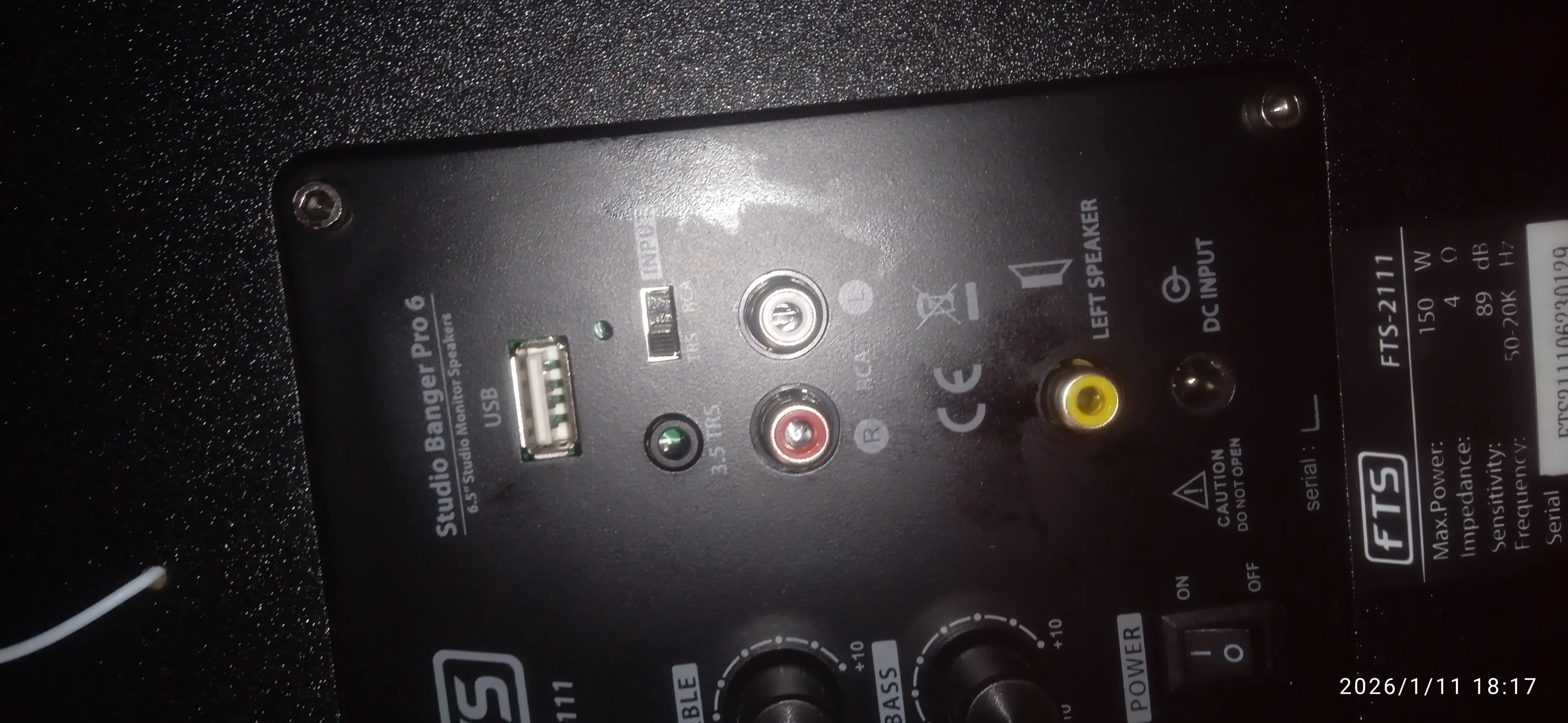

According to the specs, your monitor only connects by USB, Bluetooth or FM.
Not understanding how you used a TRS cable. ☮️
Look it was behind the RCA input are there and the plug where it written 3.5 trs is where I connect the trs cable the 2 trs plugs goes into my interface and the other plugs goes there

Post a picture of both ends of your cable. I think you may be using the wrong cable setup. This was I suspected earlier, going from balanced TRS to stereo trs.
That cable might work. A simple check with a cheap VOM meter will confirm that it's configured properly if you know the wiring. The 1/4" connectors on the Motu are balanced connectors, so if there's no problem with the ground and shield being connected then fine.
You probably have a set of RCA cables laying around somewhere. I would just run the RCA to RCA connection, especially since both side go to the same point. RCA connectors have only been in use since the 1930s. They are pretty reliable.
BUT, if commercial music sounds right when played through your setup, then again, that means that the playback system is NOT the problem.
I wonder what that little white cable coming out of a drilled hole in the monitor is for.
Those are truly cheap and nasty monitors.
They Identify the DC Input socket, but don't tell you what voltage.
