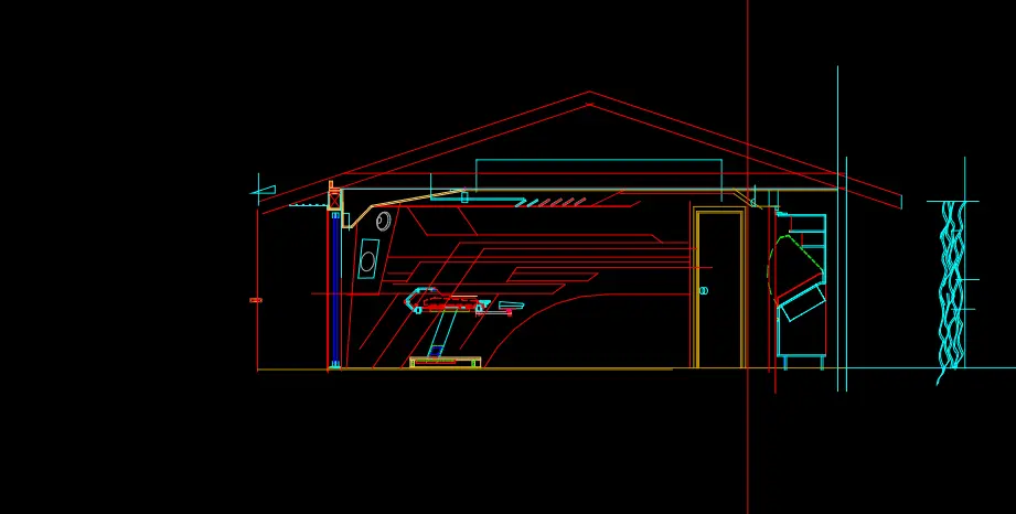

Maybe the room size would be a good start to start our ''conversation''!
4,6m*2,6m*2,7m(height)

As you don't really want to record any instruments you are really just looking for a tracking/production room.
You will want to block out some of the outside sound, however you are going to need to change the shape of the room to achieve the acoustics you really need, so you can combine the two into one job.
I think you will be able to get a very good production room if you are willing to spend the time (either learning or just) knocking wooden frames together.
look at www.johnlsayers.com and find some control rooms in the studio plans. I believe this is what you are looking for from your garage. You will begin to get a feel for what is required.
In my limited experience you are going to need to build some wooden framework (filled with rockwool/insulation) to make your garage into a diamond shape. then you are going to need to make some bass traps and grab some foam for general fiddly bits, and voila, you have a decent tracking room.
Of course it's not that simple, but when you start considering the difficulty of the carpentry involved, you will get a feel for how complicated the rest of the project will be, and adapt.

There's no shortcuts to studio construction -- you can't do it cheaply if you want to do it properly, so you have to decide on where your sonic compromises are going to be.......
Hello 11 miles. First off, we can tell you how, but you need to give us lots of information to give you the best advice. Lets start here.
Existing construction and space. Double or single car garage. Try to post a drawing to scale of the garage, showing doors, windows, etc. Show the roof ridge with a dotted line. Give exact existing dimensions within 1/2". Show ceiling heights at front and rear of garage(to the bottom of the joists). Show part of adjacent room in house to see linear footage of common wall between house and garage.
Existing materials....i.e. Garage exterior roof and walls.
Interior of the garage:
Sloped concrete floor slab?
Unfinished walls with open stud work?
Unfinished ceiling with open joists to the roof?
Typical sheetrocked wall dividing garage from house?
Typical foundation at garage walls?(footing is wider than wall, which usually leaves about a 4"-6" high concrete step on the inside.
Typical garage door? Wood? Metal?
Exposed water heaters? HVAC? Ducting etc?
Anything unusual?
Distance to neighbors on either side. Type of neighborhood-street-Residential/country/city?
Existing noise floor(trains, trucks,aircraft, guns, dogs, etc)? Loud? Normal? Quiet?
Any rooms above garage?
What about the garage CAR door? Remove and frame wall to match house? Or build wall behind it as you CAN NOT use it as part of isolation.
Answer these things and I will try to help you.

Fitz, i will send the schematics of my room as soon as i write it down in an Autocad or something.
Until then please try something out without it.

Ok, thats it for now, take each thing on my list, and answer it COMPLETELY, with as much detail as you can. I will come back tomorrow, and address the next step. Till then, try your hand at autocad, and if you need help, just ask.
I can even send you some files to help you. Here is an EXAMPLE .gif of some stuff.
fitZ :)

I think with the masonry he means replacing the existing garage door with a normal exterior door. I thus assume that all of the exterior walls are masonry? Like concrete block with a brick facade maybe?
If you have masonry exterior walls you can construct a 3" steel stud wall with a little insulated gap. If you have no windows, and build an entryway with two doors (a little airlock sort of thing), you should get pretty good sound reduction. I wouldn't worry too much beyond that since you're just mixing, which I assume is a reasonable volume like 85 dB.
Build a drywall ceiling and put a drop ceiling underneath that, and insulate above. The ceiling is the biggest sound leak in my studio, but I'm gonna work on that this winter. What is the construction of the patio above?
I think you'll end up with about 2.3mx3.5m inside with the new doors. If you are absolutely 100% sure that you will never track anything in the studio, and you just need a control room type of layout, well then you could try a very flat pentagon shape, but it's gonna be squishy. You're gonna need lots of absorption with bass traps in that little of a room so I'm not sure how much the shape matters. Maybe Ethan will help out here.
As for wiring use a single circuit for all audio outlets, lights on a separate circuit. Look up 'star grounding' for the audio outlets, although I haven't had a problem in my non-star grounded studio, even before I put everything in a rack on a single outlet.
Cables! Run all the audio cables you'll ever think you'll need! I wish I'd done this, but I've gotten pretty good at fishing them down the wall after the fact.
Without knowing what his existing "roof/framing/ceiling is like, how do you know he can do what your suggesting. It might not even support the load. And what do you mean by "put a drop ceiling undernieth"? If you are refering to a grid "acoustical tile" type dropped ceiling, what for? They are useless and a waste of time and money in a studio environment. It is very easy to suggest things like "build" and "put", but unfortunately, they imply very simple concepts, when in reality, construction materials have weight, mass, thickness, length, width, limits, costs, installation requirements, skills, existing support, and mean very little unless you know what you are dealing with. It would be like me saying....."just toss up a concrete wall, no big deal :rolleyes: I know you meant well, but for the sake of reality here, lets wait untill we know what is existing before we suggest things. Even the electrical issue. How the hell do you know what ground "IS" in his location. Europe uses a 240 50hz system. WAAAAAAAAY different than in the states. MUCH MORE DEADLY, although 120 will kill you just as quick :D Besides, codes may have something to say about it too. But that is a whole 'nother animal to deal with. Anyway, you have some good points. Let's just make sure that they work there.
fitZ
Hey mshilarious
Hey.
Well, if there's a patio above, there has to be some sort of structure. But basically I'm just throwing out ideas, the OP can figure out what is legal. If you want to create a set of blueprints, OK, but I'm not going that far. It's just that I mix & track in an 8'x11' studio, so I have a pretty good idea of how this is going to end up.
I don't agree with the drop ceiling being useless. In a large studio, yeah probably. But in a small one, you can use them to increase absorption by stuffing above with insulation to act as a bass trap. As for isolation, what is an insulated wall, like 8 dB better than an uninsulated one?
Beyond that, acoustic tile comes in many grades and the better stuff is essentially rigid fiberglass insulation, so it'll do the same thing as it does on the wall. And if you find you've got too much absorption, just swap out some of the tiles for reflective ones. It's very flexible. Heck, you can even do a groovy sloped ceiling without having to worry much about carpentry. Plus you can hang lights, run ventilation with baffles, run audio cable, etc. I find my drop ceiling quite useful.
As for wiring, yes the codes are probably different, thus I didn't recommend running a 120V 20A circuit with 12 gauge wire or whatever. However, the laws of physics are the same, so I assume circuits are somehow grounded . . . is star grounding legal in Europe? Don't know, but it's worth investigating.
I didn't want to wait my freind any longer and decided to drew it myself!
By hand.
DOnt laugh! :o
I forogot about the metric sistem.

Anyway this is a sketch that i hope will help you!
I am at work right now so i dont now if i will be able to answer all the questions but i'll try.
If not, when i get back home!
Hope this helps
About the sketches.
1 is from the 'air', and the other as you see it when you walk into it!
Hope it helps just a bit! :o

OK, I can't do CAD, so this is ugly. All spacing is very approximate. The gray panels are fabric-covered fiberglass panels mounted a couple of inches off the walls (except for the one on the door). The monitors (red) are flush mounted in the walls. I'm not sure if there is enough room in the back corners for the bass trap, but I drew it anyway. You can also recess traps in the front walls, do a search on 'slot resonator'.
I still like the idea of a insulated sloped ceiling from 2m by the desk to 2.6m in the back. If nothing else, it will look cool. Lots of little lights in the ceiling, and some lights behind the wall panels would be extra cool.
Ok, but I don't understand a few things. In order to communicate via drawings, we need a common set of terms. Here are a few we will use. A few Autocad tips too.
PLAN.... A view from the "air" is a PLAN view. Usually to show a buildings orientation on the property and other adjacent elements, such as streets, other buildings, orientation to NORTH, parking, etc. Usually in 1/8" scale. This usually is important to the Building Inspection Departments when applying for a permit to construct, remodel, demolish, or alter.
ELEVATION ...A horizontal view of the side of a building, or an interior wall such as you drew. Usually in 1/4" or 1/2" scale. On a computer monitor, you see the scale at what ever resolution you want. In reality, in Autocad, you draw at FULL SCALE :eek: :D . Then plot on paper to what ever scale you please. It is the dimensions text size and arrows that you must adjust to the scale.
SECTION.
PLAN SECTION. An example of a Plan Section is a floor plan. A floor plan is a cut section through a building about 4 feet(?meters) up from the floor. That way, the section goes through windows, doors, etc. Usually at 1/16th, 1/8th or 1/4" scale, depending on the size of the building or object. For smaller items, such as cabinetry or fixtures, or anything requiring it,
VERTICAL SECTION A vertical section is a cut section through a wall or building, on the short dimension of a room or building. Usually at 3/4, 1, or
1 1/2 scale.
LONGITUDINAL SECTION. A vertical section through the long dimension of a room, building or object. Same scales as Vertical Section.
DETAIL. An enlarged portion of a Plan, Elevation or Section, at greater scale, usually 3in=1' or FULL SCALE.
These are what we will use to communicate ideas and concepts. Here are some visual examples of each. This will take a few posts. Hang in there and I'll review your drawings and convert them to Autocad for your review and answers to questions. In the meantime, here is a site to familiarize yourself with studio design concepts:
http://www.saecollege.de/reference_material/index.html
