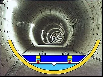

IF there were traintracks within 20' of your room, I doubt ANYONE could build a room that you would NOT hear the train.
Unless you can afford this. :eek: :p
fitZ
