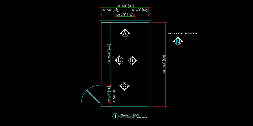

Well I looked at your drawing, and converted the dimensions from CM to inchs
and laid out a BASIC Plan to scale in CAD. Now we can get to work. This is a fairly small space. AND I still have many many questions, but lets start with the basics. Take a look. I'm posting the plan and 1 elevation as an EXAMPLE only. There are tons of details I need information on, but one step at a time.
Notice I labled each Wall as an Elevation Letter. That is how we will identify which wall we are talking about, ok? So lets get started.
Questions.
Plan...IF you faced each wall, which wall would you be looking at when you were facing NORTH? In plan view, on which side are the neighbors and how far from the closest wall, and which wall would this be? Which wall is adjacent to the street? And how far to the street? Which wall is are exterior walls, and which wall is common to the house? Which room in the house is on the other side of this wall? You show a
Floor. You said you have the floor half done. Tell me about this. What are you doing EXACTLY. Does this floor meet a driveway outside, or does it drop down or what. Is there a foundation for the walls HIGHER than the floor? Are you pouring concrete up to a foundation? If so, how are you tieing the new concrete to the existing foundation. Tell me about this foundation. Actually, tell me about the whole perimeter of the building at all 4 walls, inside and outside. How thick is this new floor you are talking about? WHAT was there in the first place? Dirt? Old concrete/tile/brick? Is any old flooring being torn out?
Tell me about the patio. Does it cover the WHOLE garage? Is there a short PARAPET WALL around the patio? What is the patio finish floor made of? If concrete, what holds up the concrete? Is there a wood roof under the concrete or what? The stairway outside. Does it connect to the wall? How? Where is this stairway? How is the patio floor sealed against rain, and how does it drain off, and where does this drainage go?
Wall/Elevation A. Was there EVER a "CAR garage door? Doesn't look like you could fit a car through that opening. :D In your drawing, you show something that you said you are filling in completely with brick. Was this a DOOR OPENING? Looked like a window in your drawing. So this wall is brick, RIGHT? Tell me the thickness of the wall/brick. How does the brick tie into the roof or joists above? When you say "unfinished walls and ceiling, exactly what do you mean? Unfinished brick? Unfinished studs? Unfinished plaster? What is it?
Wall/Elevation B. What is this wall made of? I drew it as a standard stud wall, but I bet it is brick, right. What is on the OTHER side of it outside? Yard? What is the wall finish on the exterior? How does it tie into the ceiling or roof? Is there a wood plate at the top of the wall? What kind of foundation/floor connection? Any electrical in this wall, and where? What kind of wire....3/12? Any ground wire? Are the outlets grounded?
Wall/Elevation C. Same questions as B.
Wall/Elevation D. Same questions as B. Add these. What is this door? Is this the door you were refering to as "build up the old 2 way doors"? What did you mean by "2 way"? Where does this door lead, and what is outside of this door? Is the pavement level with the "partial floor in the room? Or do you step down? What kind of framework for this door? What kind of JAMB? Latchset?
Ceiling/Roof. What supports the roof? Wood joists? How deep is the space from the bottom of the joist, to the material above?(Width of joists) What is the spacing of these joists, center to center? Do they span the short dimension of the room? Is there a beam of anykind that supports the joists in the center? What do the joists rest on at the top of the walls? Have you had ANY leaks? If so, what was done to repair them if you did have a leak? Any electrical in the ceiling, or existing lights? What are they? Incandescent or fluorescent? Are you changing these?
Well, that ought to keep you busy for a while :D When you FULLY answer these, I will interpret the answers on the drawings, and post them. THEN, we have something to work with. Untill then, keep studying, and I'll post some more stuff for you each day. Here are the EXAMPLES for questions only. They will become more detailed as you answer my questions. This is the only way I can properly direct you how to build this within your budget.
Cheers
fitZ :)

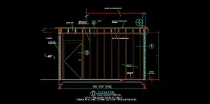

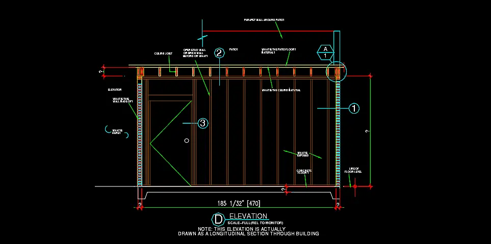

Here is Elevation "D". Actually, a Longitudinal section through the building. Take a look and clarify EVERYTHING that is wrong. I NEED DETAILS! :D
fitZ

Actually, this is really difficult to post a drawing at a scale you can read the text. All I can do is zoom in on each detail and post it as a reply. More later.
fitZ

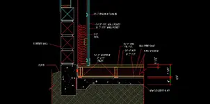

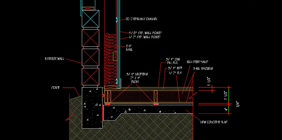

Ok, here is an example of a floating floor detail. Not that we will be doing this. This is only to show you WHY I need to know EXACTLY what exists. :D
fitZ
Wall B
The neighburs are on the B wall. My Wall to their wall is about 7m
The c wall is adjacent to the street! About 5m away from the street. It's not really a street more like a drive-way for a couple of houses. No trucks going by or anything like that. No fast cars either.
The D wall is common to the house. The A B and C are all exterior.
A stairway is on the other side of the D wall!
You show a Floor. You said you have the floor half done. Tell me about this.
Well this was a garage. Still is for about a day or so:D
The floor is solid concrete with a hydro isolation in between.(anti-humid)
It's custom in Europe to isolate it wit a layer of fine cement over the isolation, mostly styrofoam.Over the fine cement goes even finer layer of cement called 'mass'. YOu gen do wood tiles then, carpet, ETC...
And on the corners of the floor we put styrofoam paltes about 2'' thick before we pour the layer of cement over. I've never quite understood why. The constructers told me it was for the sound insulation of some sort.
I would understand it as if the frequencies do not move across the floor through the wall and the foundations and next through the house.It stops the sound just a bit. So it is said.
No, the floor concludes at the edge drops to the driveway.
Well the zero point of the the found. are ofcourse about 80cm lower than the floor, and about 20 cm above the floor. The found. are then continued by the walls.
No the cement is just over the floor. The foundations are in the walls and do not even touch them!
As i said, prior was(still is) normal 15cm thick layer of concrete. The new layer is expected to be, including isolation, about 8-10 cm thick.
Old concrete/tile/brick? Is any old flooring being torn out? NO

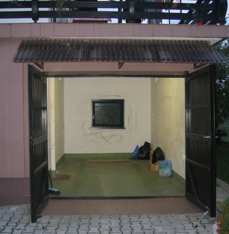

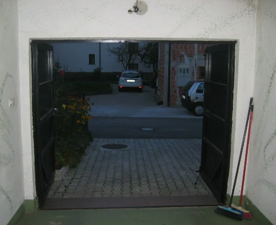

This is our garage prior to the up-builiding. :D
Today, the doors are removed and filled with brick wall.
This is what why in Europe call a two-way door. I am sure you dont have them in US. Only the vertical ones. And those on the remote, right?
Anyway, the garage is to be my own litlle production room.

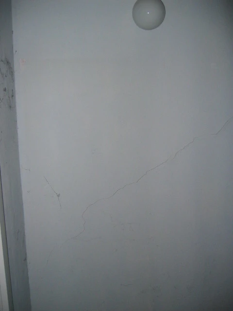

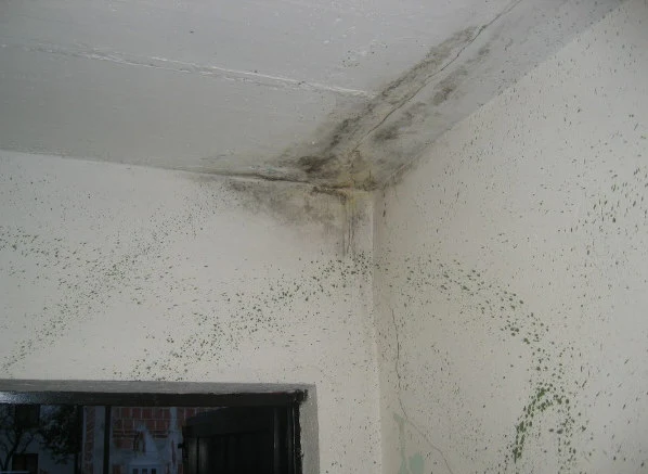

A problem?
This is the garage and the house joint. The garage was built seperately and later. Therefore, the garage is said to be subsiding differently (faster/slower) than the house.
Add a litlle e-quake now and the ant the cracks are here.
The humid stains around it are the aftermath of heavy rains over the last 10 years. Nothing dripping. Ever. Just the stains. The mason cracked it wide and refilled it with some sort of an antihumid cement mass. Supposedly it helps a lot.
Again above the garage as seen on the pic 1, the patio.

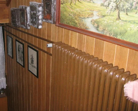

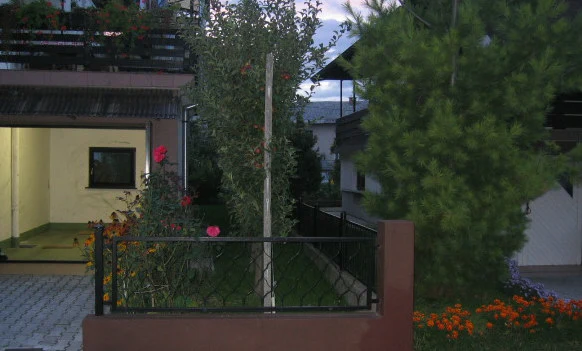

THe ''me&the neighbour'' distance. Abut 3-4 metres. He has similar placementof garage and patio above, which is the first closest neighbourly object.
Observe my grandmas flowering, please :rolleyes:

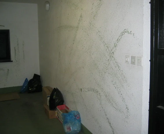

The wall from the '' 'till now unused hallway''before it was torn down by the mason. New doors are already placed in.
Maybe the pic is nothing special. But wait for my new pics.

Ok, I looked at the pics. Exactly what I pictured. Except what you called doors, we call gates.

Floor.: Floated on neoprene "pucks"(one solution only)
Intire existing floor/walls ceiling sealed with waterproof sealant
Floor Frame-:2x4(or metric equivilent) treated wood, laid face down on pucks @ 16" oc.(drawing to follow) Build frames as modules, per diagram to follow. R-(?) Batts cut and placed within frame voids
Sub-floor-(sheithing)
1st layer-5/8 moisture resistant gyp board with all joints supported by frame, fasten to frame frame lines.and caulked with resiliant acoustical caulk.
2nd Layer-The heaviest rollout roofing felt you can find, or comp. roof(for lack of better term, I will tell you correct name later.) This usually comes in 36" wide rolls. All joints to be sealed with appropriate sealant(usually an asphalt based compound, but I will look for correct stuff.
3rd layer 3/4"(or metric equal) Oriented Strand Board(OSB) or Ply with tongue and groove long joints Orient panels at 90 degrees to gyp bd panels. Use screws through all layers into frame at 6" oc at perimeter and 8" oc at interior frame lines. Caulk all joints as each panel is placed.
Walls, here is where space considerations come into play. As I see it, there are TWO solutions. We may use both, depending on which wall.
Solution option #1
(long walls, B and D.. Vertical full height 3/4" x 1 1/2" Wood FURRING Strips at 16" oc, fastened to concrete walls with a vertical bead of construction adhesive and short concrete nails or screws with concrete anchors. Place vertical batts R(?) insulation in between furring, held in place with 1/2" wide plastic strapping across face, length of wall, stapled to each furring strip as each batt is placed. The insulation is THICKER than the furring. This will dampen the gyp panels.
Next, screw RC(metal resiliant channel)as per drawing section(to follow after decisions are made) to furring strips. Horizontal and vertical layout precision critical for fastening gypboard
Next, cut(per drawing section) and fasten 1 layer 5/8" gyp board VERTICALLY to resiliant channel, with MINIMUM screws, caulking each joint as each new panel is placed. Joints at floor and ceiling to be detailed per drawing as decisions are made on ceiling/wall construction Tape and mud vertical joints. Mud over screws(details on fastening to follow)
Next, 2 nd layer 5/8" Gyp bd fastened HORIZONTAL, caulking each joint as panel is placed.Same notes as first layer. No taping untill ceiling is placed.
Solution option #2 INSIDE OUT WALLS. Requires standard wood framing, sheithing with 2 layers 5/8 gyp board on floor, prior to raising in place, with(optional) 1/8"x 4" foam sill seal(rollout) under wall plates at floor. Perimeter joints(wall to floor, wall to wall, wall to ceiling)detailing dependant on each wall construction design decisions, based on other criteria such as doors, adjacent spaces, HVAC etc etc.(section details to follow per decisions.) This type of wall allows for treatment within the wall void, with Rigid fiberglass panels between studs, with fabric(fire treated) stapled to studs, and wood trim strips placed over staples. Also allows for cable troughs, HVAC ducting, electrical troughs/outlets to be easily placed and within the iso room without showing. Also allows for slat resonator application directly as part of wall(rear 1/3rd)
Solution option #3. Standard wood Wall, with 2 layers 5/8 gyp board(per previous notes) with R(?) insulation at stud voids. This would probably work at the narrow dimension walls, front and back. Allows for membrane absorbers/ bass traps/diffusers at rear, and soffit mount speakers/corner absorbers at front, depending on final design.

Concrete sealer. This is a must. It prevents mildew, and moisture accumilation. Normally, all homes breath via venting, but in a studio, the room is sealed. But then........YOU have to breath. This is where we have to talk about HVAC or ventilation. WHAT DID YOU HAVE IN MIND? Anything? What is the seasons like there? What were you going to do for hot and cold weather?

Still was unable to get the dimensions you asked me. The electrician came yesterday and re-routed all the cables, by breaking half of the walls :confused:
He did a good job. I told him he must be careful, for this is going to be a production room. Although he is ols, he understood and did a good job.

DOnt plan on having any Ac, the heating is by a radiator/heater on the D wall. Its electrical and works by convection. Hot air raising. A really splendid thing if you like practicalness and steady temp. They are equiped with a digital thermostat.
