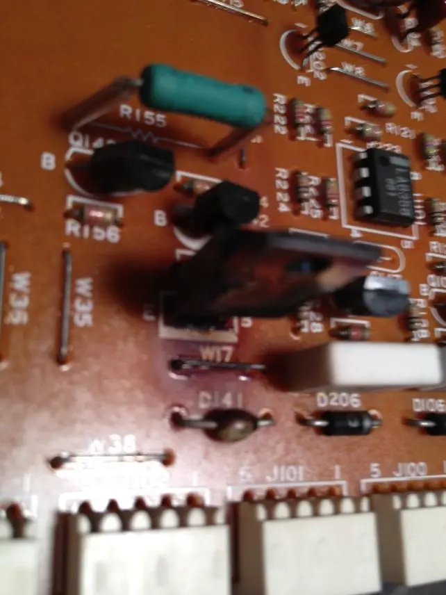

Following the wire from the fuse led me to the reel servo pcb, where I discovered a component (Q141, transistor?) that looked burned, as well as a resistor very near it. With very limited experience fixing this kind of thing, I'm wondering if I should try to replace those burned components and see if that fixes it, or if it is likely that there is another root cause why those parts burned.

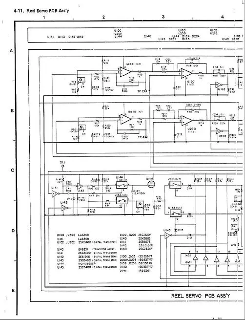

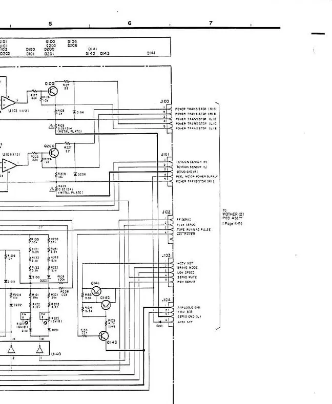

This is a schematic from a scanned manual I found online. I'm going to see if I can get a clearer scan from my paper manual if I can find it. The blown transistor is Q141, located on the lower right of the larger schematic.

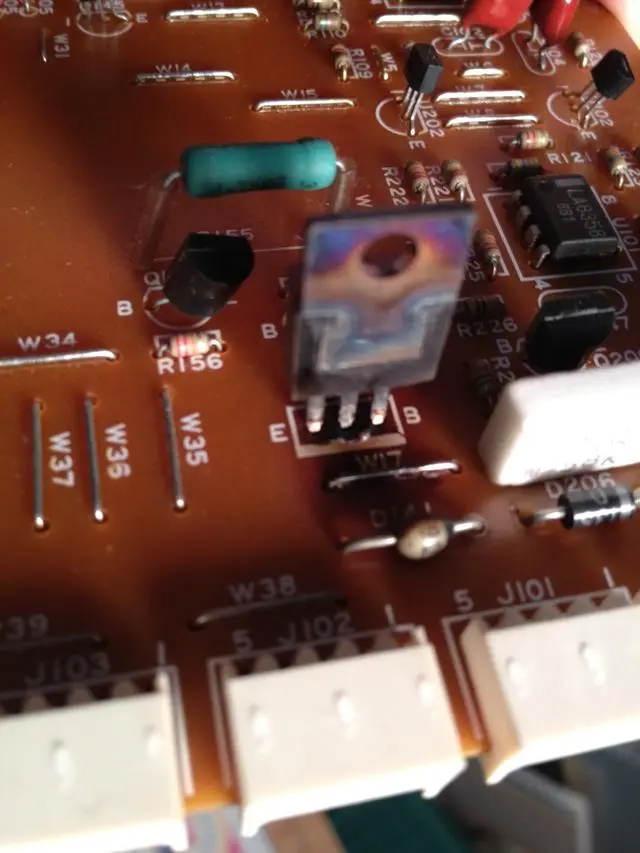

here is the board in question.

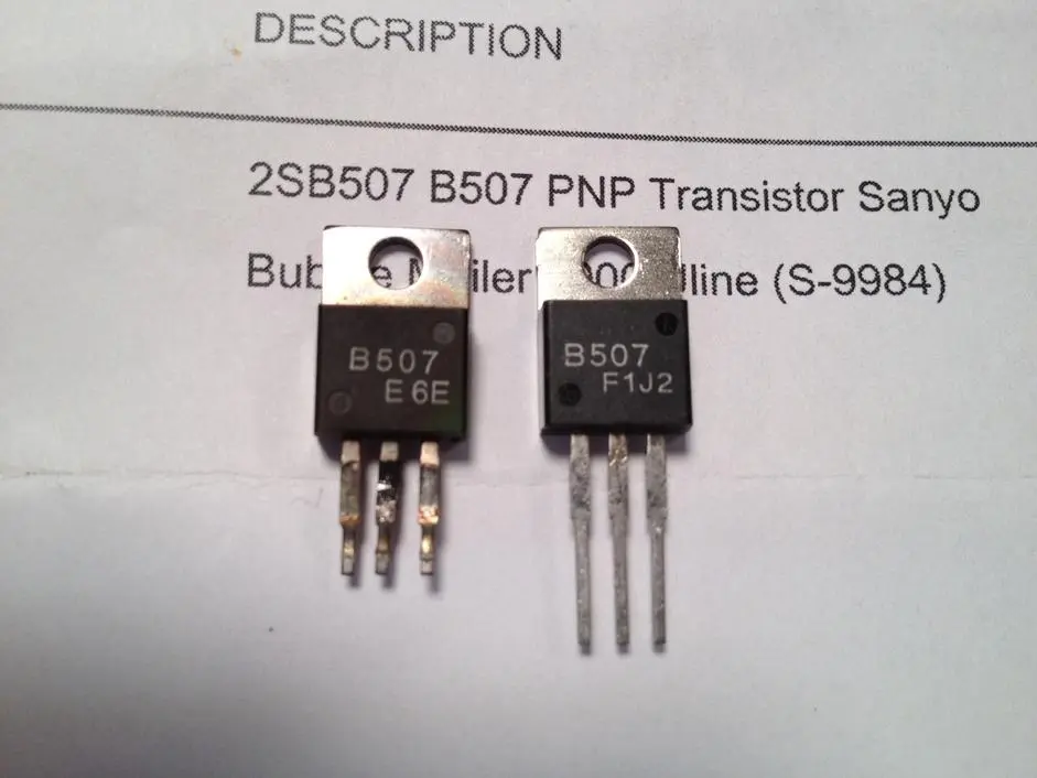

What part did you get to replace Q141?
The stock part is a 2sb507 pnp power transistor with 1b, 2c, 3e pinout reading left to right when looking at the face of the transistor. If you got something with a different pinout then, yeah, at the least it won't work and at worst it'll take other parts down with it.

Here are the transistors, original on the left, replacement on the right. I ordered 3 of them in case something went wrong. Ordered from FPIE Electronics.

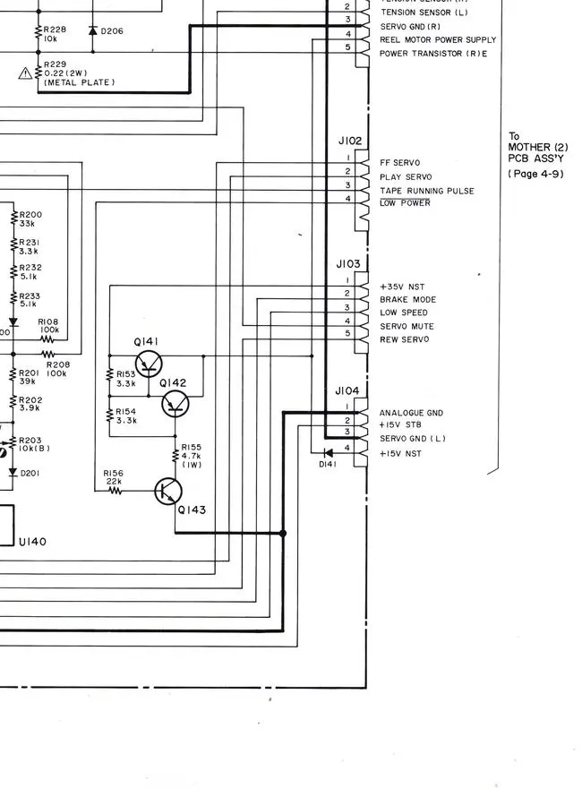

Here is a clearer scan of that part of the schematic. I'm wondering if maybe I should replace that whole circuit, including Q141-143, R153-156, and D141. I have not been able to find a match for that diode, and I can't really read the numbers on the part itself because it is somewhat blackened. I tested it in the circuit, and it passed current one direction and not in the other, so I thought it was probably ok.

I don't know why I didn't see it before...D141 looks like its full of pus and needs to be lanced. Replace it. Q141 and D141 sit on the +35V unregulated rail so when the event occured there was healthy juice there. Also, look at the wire link W17...that sucker was on its way to being a fuse link, man. See how the board got hot around it? Check the solder joints on the link. You may need to do some repairs there if the lands are damaged, like shave back the coating to healthy trace material, tin it and bend the leads of the new part over so you can solder to healthy traces.
Aside from the above, if it were me I'd be replacing everything in that loop on the servo board simply because I don't have the right gear and knowledge to test Q142 and Q143 out to make sure they are still healthy, and because something went sideways on a +35V rail and heated stuff up pretty good, and because we're dealing with 25 year old components that have been exposed to stress I'd make sure Q141, Q142 and Q143 are new parts as well as D141, and R153, R154, R155 and R156. And check out W17 like I said...and any other wire links that are associated with that circuit. My copies of the pcb layouts are pretty ugly so I can't tell for sure but maybe W35 is part of that section?
