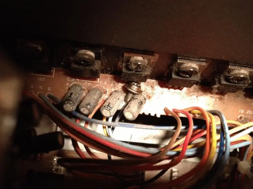

I've not tested the psu in isolation yet, mostly due to not having had time to build the cables. The 388 project is at the back of a very long bus itself right now. I did take a look at it for things hooked up wrong, given that I had the psu installed wrong I thought it couldn't hurt to take a look. I did find a screw that had fallen down onto one of the heat sink circuit boards and could be shorting something out.

I somehow missed that you'd installed the psu incorrectly...can you tell me more about that? That could be very important. And yes, a metal part on a live circuit board is not a good thing...any way you can power it down, disconnect the mains, pull the psu board and then put the screw back where you found it and take a pic and post it up here?

Then, since I had already made a couple of dumb mistakes, I decided to check out the whole machine for anything that looked wrong (such as a screw on a live circuit), and that is exactly what I found: a screw from the VU meter bracket had fallen down onto one of the small circuit boards that connects to the heat sink in the back of the unit. I'll post a picture of that here in a few.

Can't tell for sure, but you may have shorted that ?regulator? there. Remove the screw for sure. Are those transistors or voltage regulators?
And BTW, the screw is resting on the +5V regulator IC. I don't think that would have killed it but you would be double-checking that with the PSU out of the chassis and isolated; making sure the +5V rail is outputting close to +5V dc and also passing only scant amounts of AC current (like in the low single digit mVac). So I really think your next step is to build up some extender cables and get your PSU checked out and then go from there.

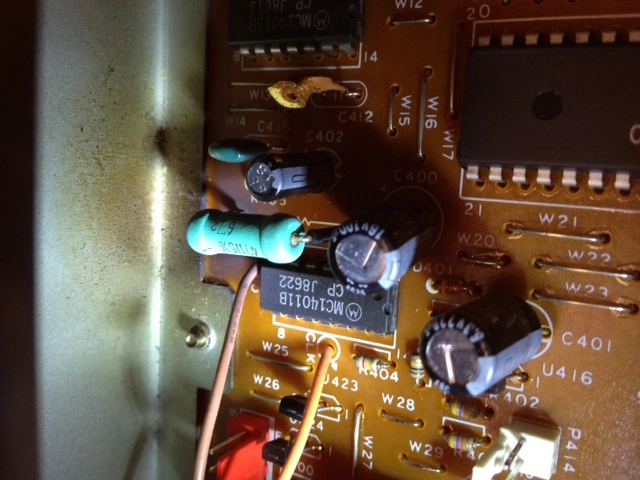

Thats the one. Of curiosity, could you disconnect everything from the control board except for the yellow plug(412) and tell me if the 2W resistor(biggest resistor on the board) gets hot about 30 seconds after powering up. How do your transistors on the TR board look? Anything smell fried? I can confirm that the reel servo has nothing to do with this, well not anymore if it caused this problem for you. The reel servo was out when this started with mine. Im hoping its one or more of the transistors on the TR board. I'm planning to cross reference and order some suitable replacements for all of them once I get some time.
I disconnected everything except the yellow connector and powered on. Capstan spins but no counter lights or reel movement. Powered down after about a minute. the large resistor (405) did not feel hot to the touch, but there are signs that it has been hot in the past. In the picture you can clearly see heat damage around the upper leg. Other resistors (notably 424) did feel a little warm, but not hot as in melting. I also found a ceramic capacitor (c412) that looks like it has become fused with one of the electrolytic ones. I pulled it back, and you can see it in the picture.
