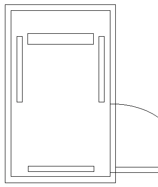

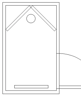

This is why i suggested spacing the 4" absorber 8" from the wall. This should give good absorption down to 300Hz. I'm sure you know that the quater wavelength of 300Hz is just under 1ft, so this is the best thickness of material to use, but to save on cost bringing the panel out from the wall will affect in the same way, although not as well(still very good though).
Obviously you can't lose 1ft off every wall in this size of room, so having one panel, and then having thin absorption elsewhere will suffice. I think Technominds would be better off using a 4" panel behind the mic, then either side and above have a 2" placed an inch or two from the wall, and the same behind where he'll stand. But he already has a lot of foam, so he could use this instead.
I'd build 1 4'x2'x4" panel placed behind the mic 8" from the wall, 3 4'x2'x2" panels placed at the sides and behind spaced 2", and 1 2'x2'x2" placed above and spaced 2". This would leave a little wall, but not a great deal, and would probably give good full spectrum absorption.
These are two options i think you could go for. Both of these include a 2'x2'x2" spaced 2" cloud. The second uses less materials, and I think is actually the better option.
I'd go with the second to as angle the traps like that will give the most effect use of them.
I know the second would be best, but the first is much easier and leaves me with alot more room in the booth.
Im going to to the wall behind the mic entirely from fabricated rockwool and then the wall behind me the same.

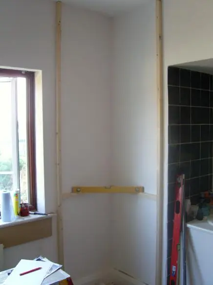

started building the right corner soffit
