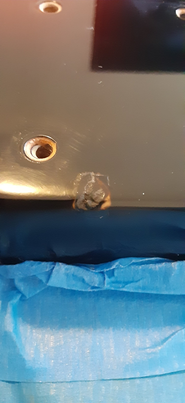

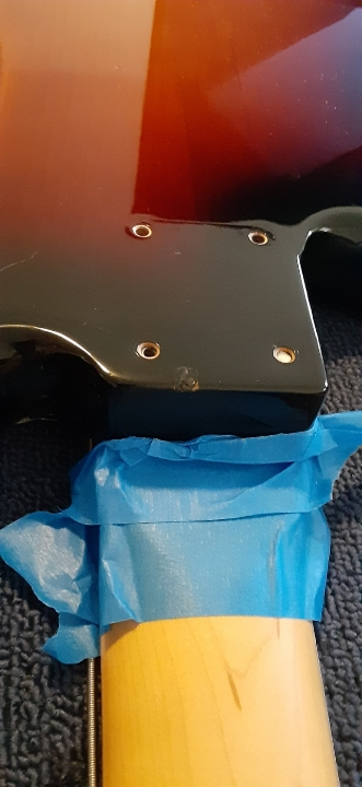

I had two guitars with small paint chips, and one had some wood chip.
Then I watched the youtube experts and they make it look simple.
I was lucky is both mine are on the back and black paint. Both seemed to be "easier" than fancy stuff. Being it was black and non-vintage I thought it would be fun.
Using some black - super glue, Starbond, I spent $15.
The tiny applicator seemed cool. I had my magnifier glasses but then it went worse. I dripped the tiny drops into the spots.
Went worse- The glue didnt cure very fast at all. I left it sit overnight and it turned to a dry rubber?
The dried version was a dull black, not high glass .
Then as Im messing about looking for high grit 2000 sandpaper , the experts said "oh 50 cents" but Home Depot is $8 for a pack. I spent another $15 on high grit and some Scratch remover polish at the Auto store. ($30+ now on this project)
So now its been 3 days, adding small drips to fill a small dent. I tried the razor, taped off edges, all the stuff they say in the videos. All the experts seem to use the same simple looking methods when using the SuperGlue method. But its not going well, its like a skeptical vibe now....that I was watching Sponsored Propaganda...and maybe its not easy and maybe it doesnt really even look that good in real life.?
Ive never really done this paint gloss body work before, so now I think Im moving on to the sanding the area part. To be honest it looks like crap now.
Im hesitant to scratch up a larger area and then find out this was youttube and not real and the videos make it look better than it really is.
I wonder how much a real pro would charged for a simple black gloss belt buckle chip and /or a dent in the back in the black area?
Seems like a Failed DIY or if it costs more money to get it right and go to a pro...this has been a waster of time. Is the youtube BS?
Anyone else done this superglue kind of small DIY repair and had great results, or even "ok" results?
Maybe going relic and let it just rot away into relic world would be better? gives it personality right?:confused:

Well after $35 in stuff...the weekend came and the chip is now filled with Starbond black glue but its more like a rubber grey and not smooth at all.
I went to the next step and started sanding to avoid making things worse to worse I decided to take more time and use 2000 grit polishing paper. Its slower but Im not in a hurry and probably wont ever do this again after these two guitars. Hopefully will learn something along the way.
So the glob of rubbery super glue was sanded down and the "white-ish spot " from sanding looked horrible, but I figured this is normal per the videos. (Ive watched a bunch more and even started repeating watching them...)
Getting the super fine scratch fine polish from the Auto part store I applied and buffed with my hand, thumb over and over and it actually brought a shine to it.
So the sanding with 2000grit and super fine polish for 4 or 5 times is working. USing more coarse sandpaper and polish would be faster but I tried to be super safe and used only 2000grit and very fine polish liquid.

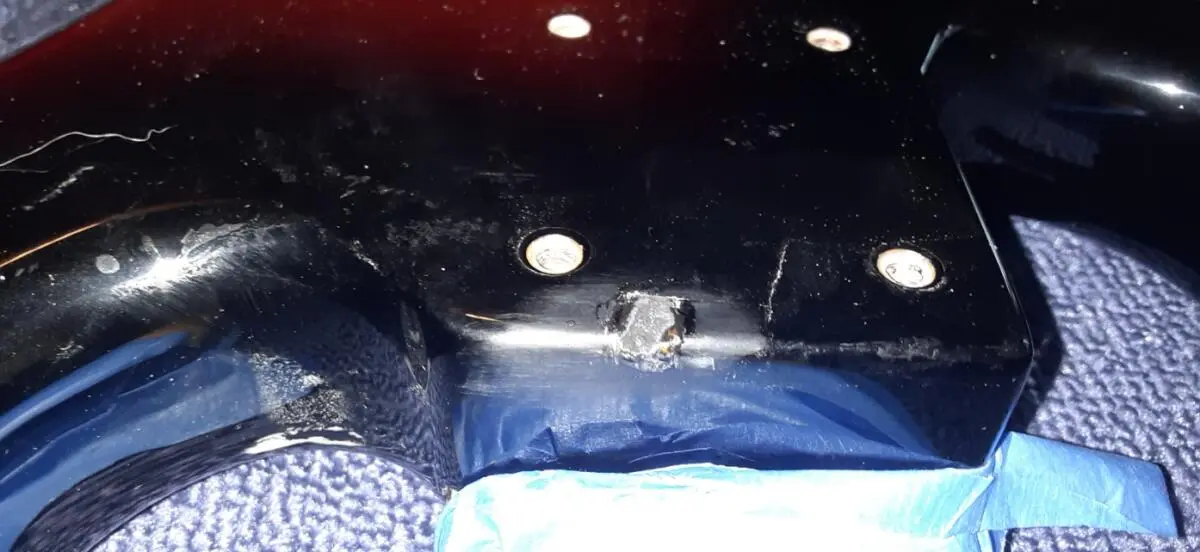

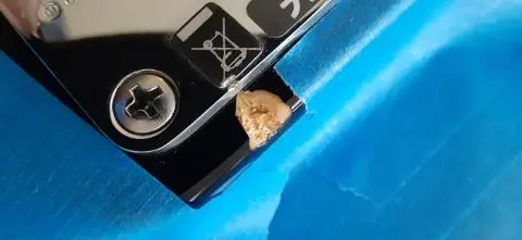

I added the original small ding...I thought it would be easy after watching youtubes..lol ....... not
2nd and 3rd picture is the dried glue blob after a week. Looks like crap to me. Even worse after drying. Then started sanding it with 2000grit wet.
had tried the razore blade thing and decided not to, then the harsh sandpaper first but decided not too.,,,,
I removed the tape and got out the 2000 fine paper wet- with a little water and started risking ruining it more. lol
4th is first polish from auto scratch remover and microfiber...luckily this at least got the scratched out area back to shiny....but it only looks "ok" from about 30cm/24inches.....up close it looks like crap imo, I'd rate it a 3 out of 10best scale.

I just looked at the pics on a phone. How much detail can you see there? But it gives an idea.
If you wanted to start over..... get some acetone and melt out your superglue patch.
Little amount on a q tip. It will melt the patch long before it melts the surrounding finish.
That’s either a catalyzed poly or UV cured urethane. Hard stuff.
Once you get the stuff out of the chip, build it up with some wood dust and CA.
Just sand some wood and put a small amount of the fine dust in the chip. A teeny drop of superglue on the dust will soak in and make your patch hard as a rock.
Then get some black nail polish and fill the rest.
Build it up a bit higher than the damaged area (it shrinks)
When all cured, sand and buff.
Practice on some scrap if you need to, but I think you can do it and achieve a good result.
