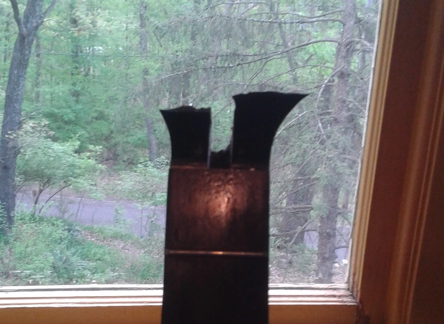

Failed? DIY Guitar dent

In a ‘modern’ finish, doing any kind of repair leaves ‘witness lines’ due to being unable to melt into the existing finish.
The key here is total honesty and transparency with the client on the fact that it’s never going to be perfect.
With the vintage crowd it’s just as bad maybe even worse regarding OCD.
With nitrocellulose lacquer being able to melt into itself, one can do a finish repair that to the naked eye looks perfect.......
But under a black light the repair is obvious. ?
New lacquer looks different under a black light than the 50 year old finish despite being the same formula.
Many buying an expensive vintage instruments will first have it black-lighted to make sure it has no repairs.

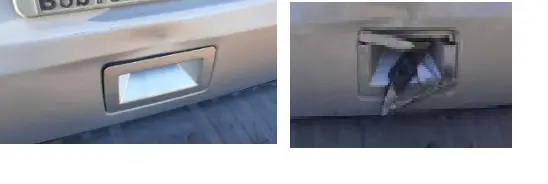

I did a small car repair , some old dude rear ended me, and it came out really nice, spray painted and installed DIY..
(..it saved several hundreds of dollars per the body shop)
but........... there was a small gap and I thought!! I have that Black glue crap! :facepalm:
and I got out the Starbond Black glue and dropped a little in and it ran and it reminded how long it takes to dry.....and it was starting to make
this project go bad. So the STARBOND went into the garbage. It takes waaay too long to dry compared to other options and its runny and easily a mess to clean up. (The Black Enamel TESTORS paint was also a bust as it took 24-72hrs to cure/dry and theres better things to try...total mistake.)

ADD: After watching a few more youtubes, I think the best bet for this would have been
STEP 1: clean it and STAIN the raw wood
STEP2: do the rest...however....and not expect "perfection" results. The majority all seem to agree with RFR that the repair will always be visible under a magnifying glass etc... unless a full new body strip,repaint is done. Whether then using Clear Super Glue or Laquer or Finger Nail polish...I dont know.
