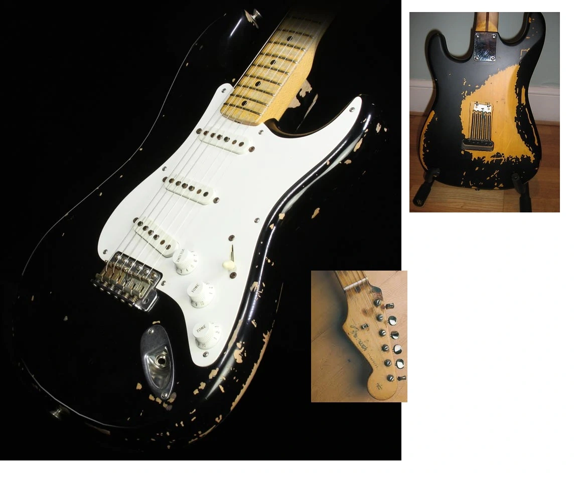

or just say f-it and let it roll.... Custom Relic Shop!! like Claptons Blackie!

Hey I'm not micky taking or anything.
Hey, just for kicks, check out this video. This guy patches a '53 Tele, then refinishes it like new. Then a cool surprise ending.

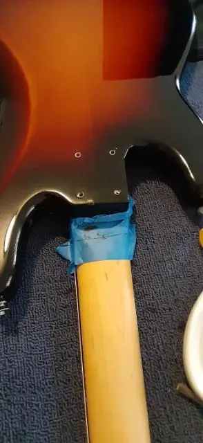

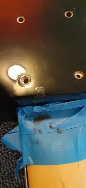

well after enamel Testors paint and sand and polish, 2nd attempt its about a 2 or 3 result....the chip is filled in, it wont get worse so thats worth something.
cosmetically..lol...well...it looks real good from far away!
so if 10 is factory new...this is about a 2 or 3, imo.

I might get some high gloss black finger nail polish and drop a little on it....Its heading to $40.
looked at it you cant see it, but in the sunlight or flash light its not good..lol not a life threatening deal, but wow, its harder than I thought.
