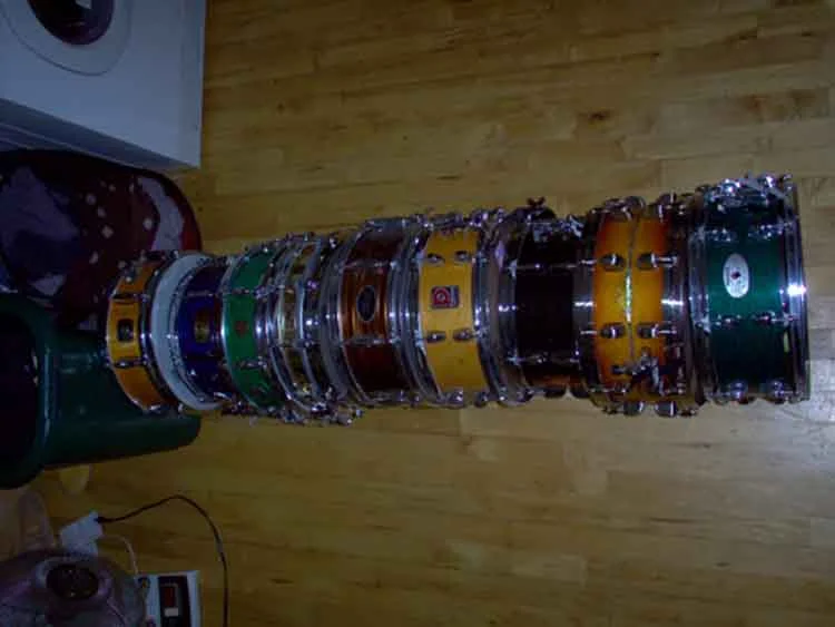

need a different snare sound? (these were from the last session I did)
Seriously ... Hook me up, dude!
