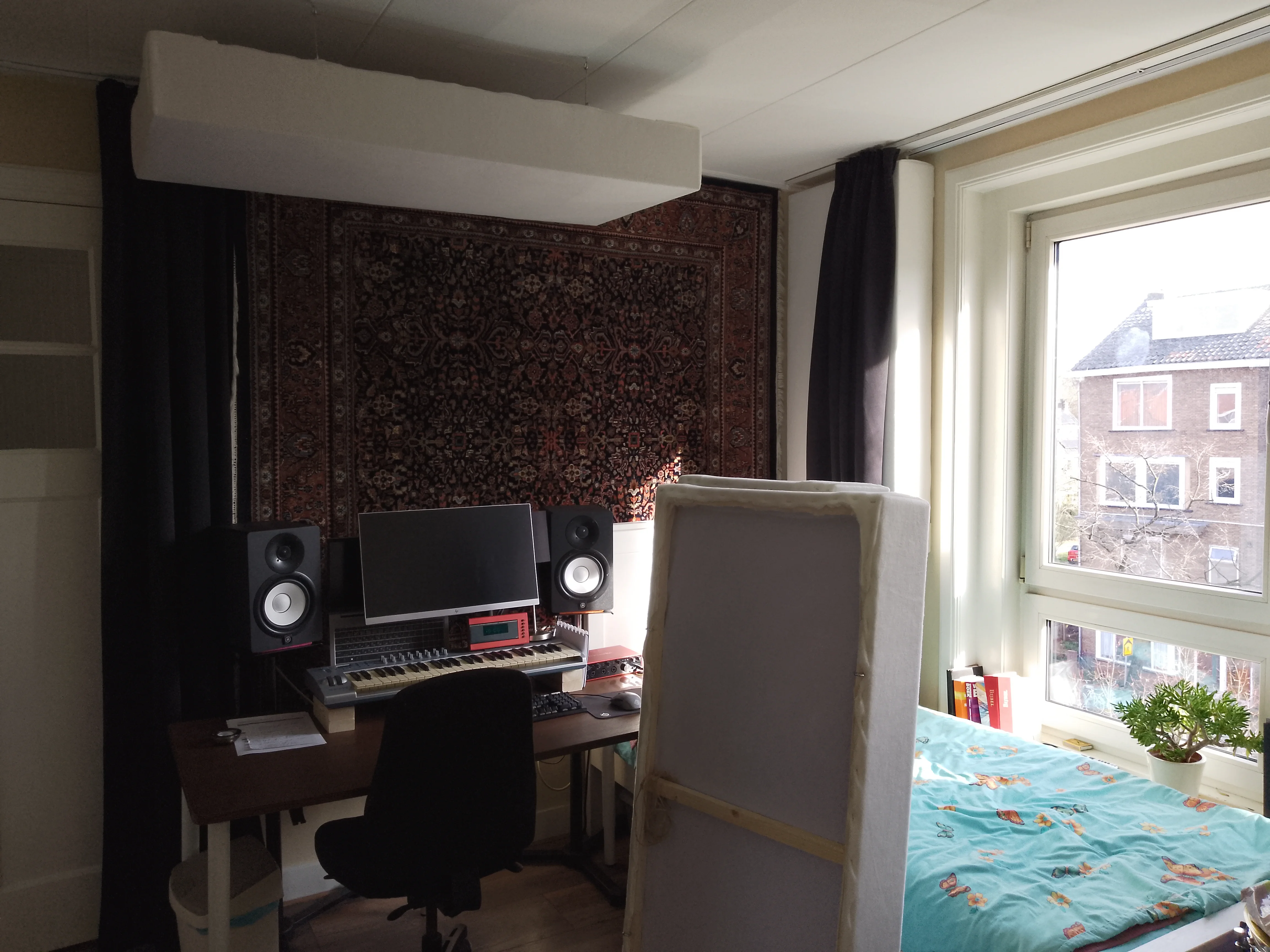

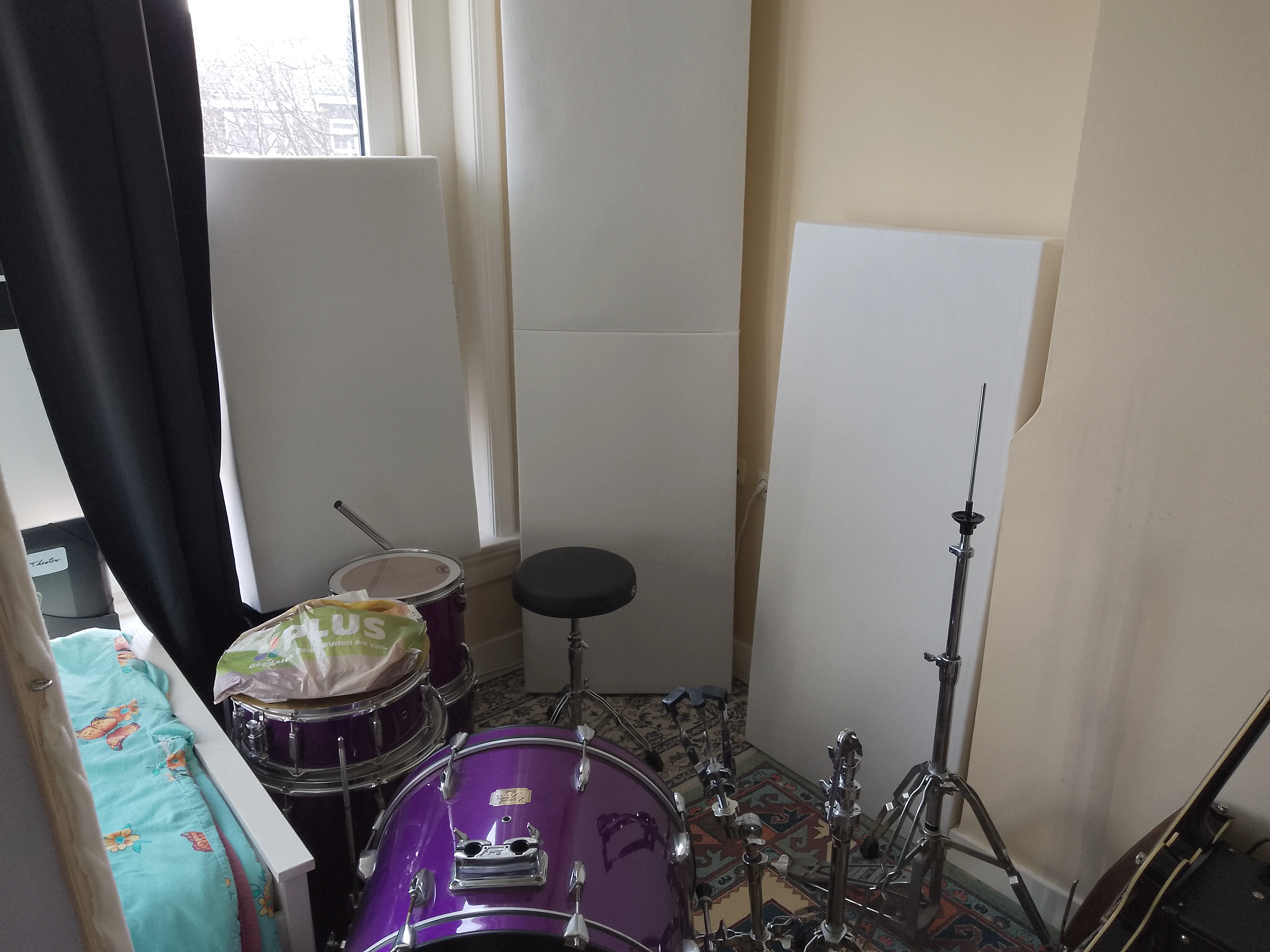

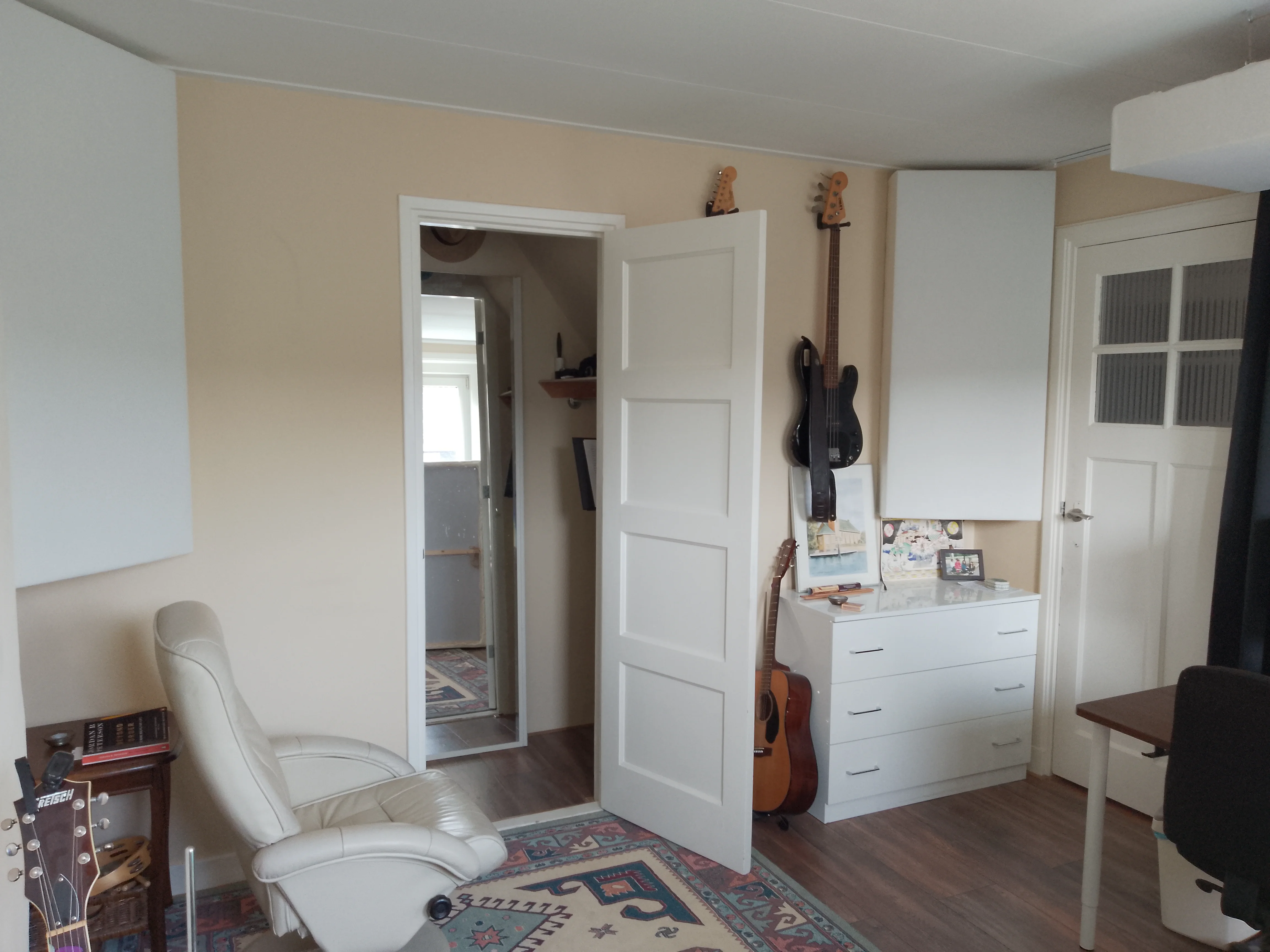

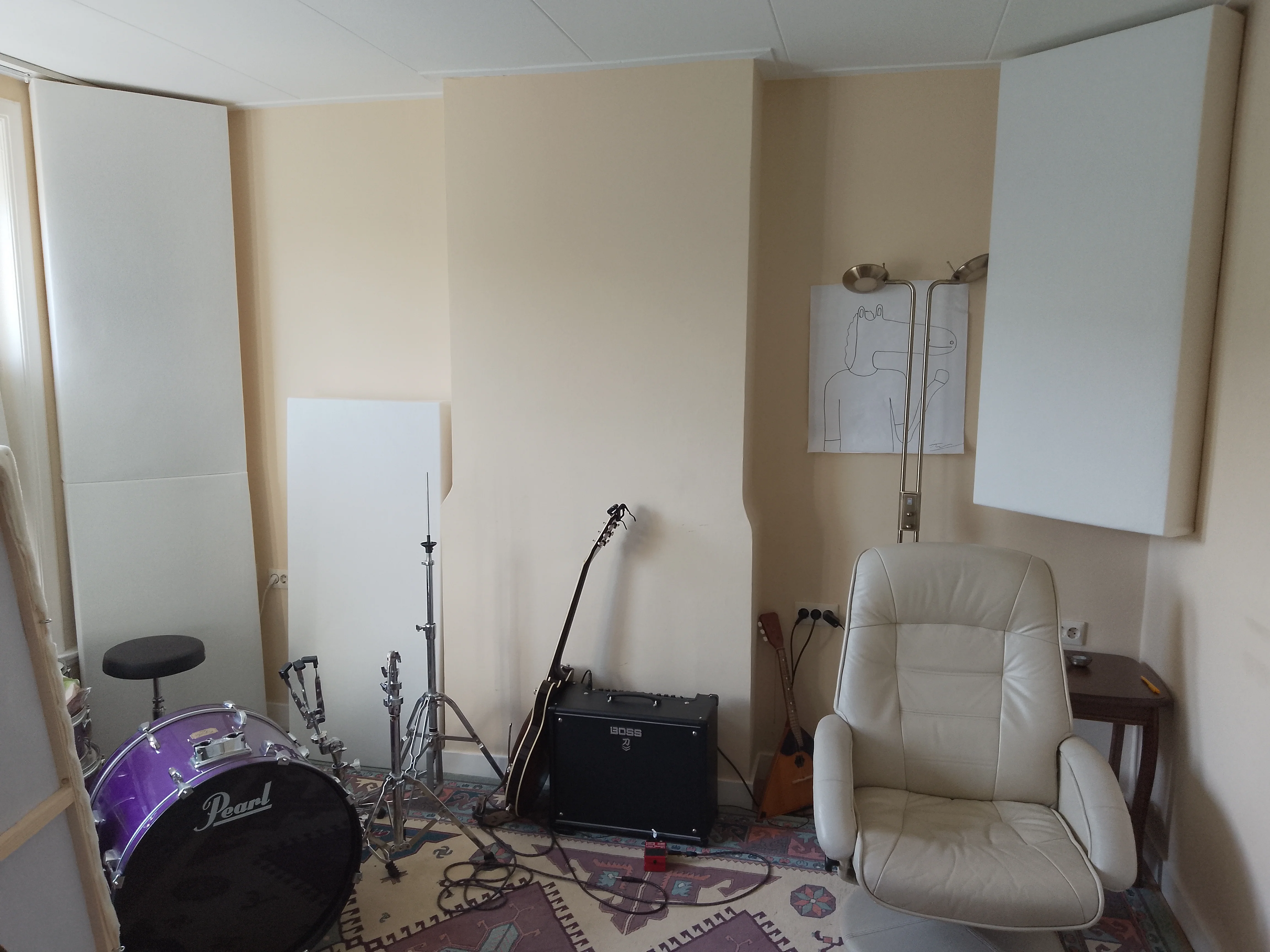

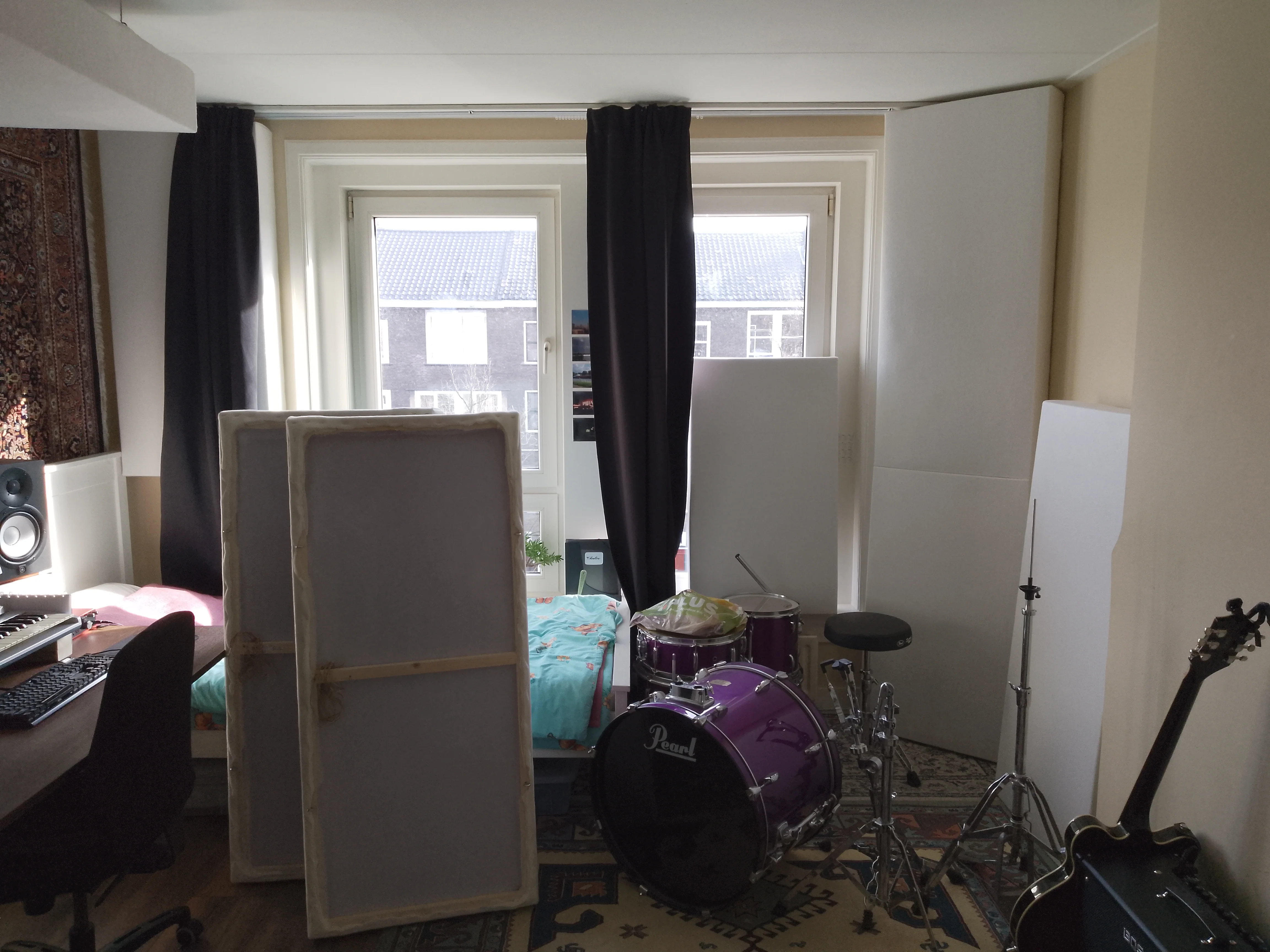

Hi everyone,
This is my first post. I could use some advice on where to place these acoustic panels as drum clouds. Everything will be removable so if I want more room I can just take them off. I read that it's not recommended to put the clouds right next to each other and that a gap of say 20 cm is better. However, I fear that'll just create a reflection point right where I don't want it, right above the drum kit. So I was wondering if you could help me decide where to hang them and in what orientation.
This is my bedroom and the drumkit is yet to be set up by my friend who owns it. The two panels that are not in the corner are just leaning against the wall and are easily movable and stackable.
I'm planning to record the kit with three mics
  1. Kick: Shure Beta 52A
  2. Snare: Shure SM58
  3. Room/cymbals: Rode NT1
The dimensions of the panels are: 136x60x17cm, with 14- of the 17cm being taken up by glass wool.
I'm mainly looking for advice on the cloud placement, but any advice is welcome. Thanks in advance.

The middle of the room is often pretty poor acoustically. You won't have the distances exact, so you'll get comb filtering from the very slight difference in timing of reflections off opposite walls, and I believe the centre of the room has the most nulls so it'll sound weird there as well.
I think if you attach the panels to the ceiling - adding two more smaller ones - and with the stuff in you room (like the bed) you’ll dull out the reflections and standing waves enough to get decent recordings - but be forewarned it ill be very hard to get great recordings - the room is to small - you could go for a ‘sound’ though but that’s a stylistic think - even if he plays the parts you’ll be better off replacing them with samples.
