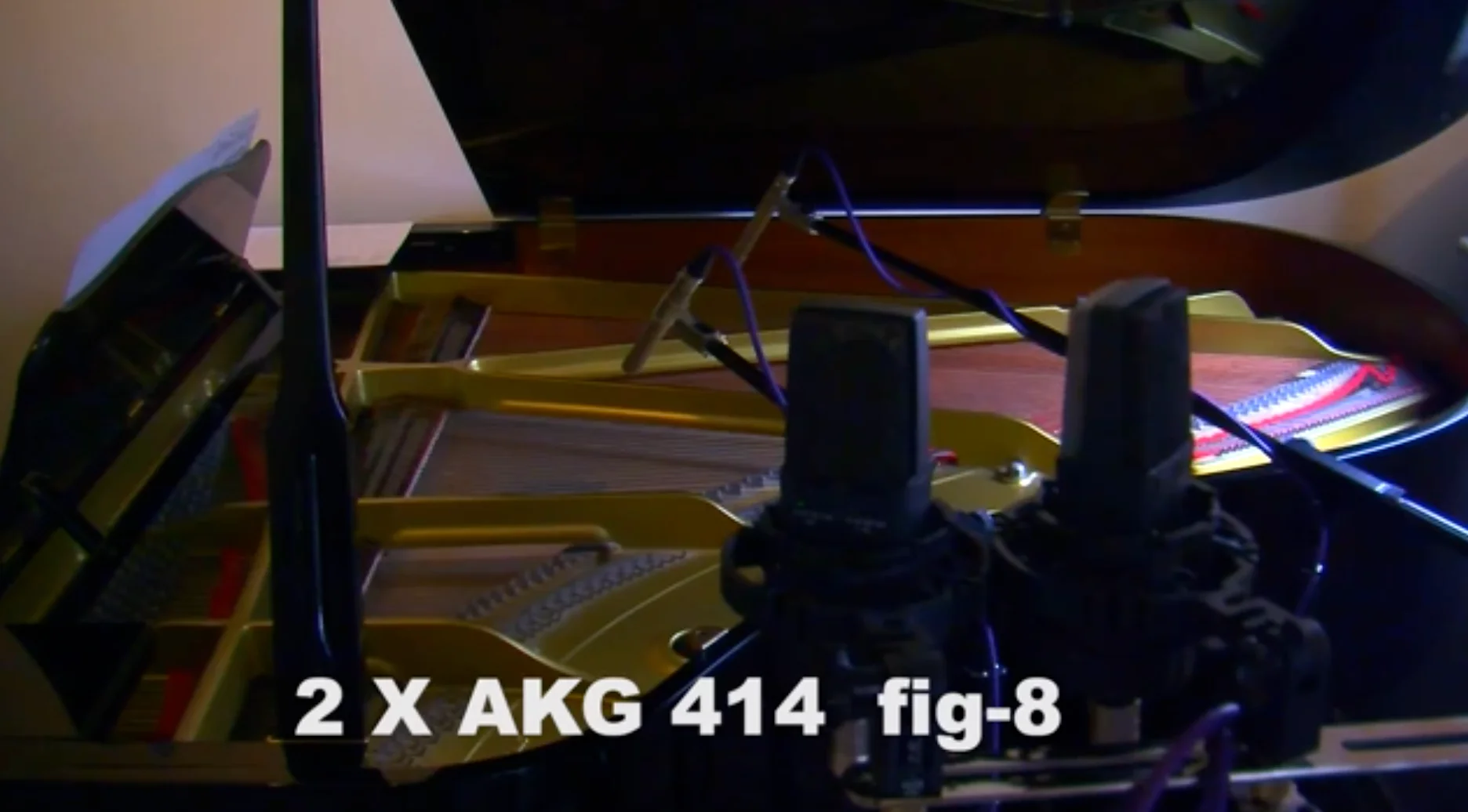

The raw track sounds better but reveals a few things. The mics are too close - so you are hearing more of the hammer sounds and less soundboard. That could be why some notes jump out a bit. I think maybe you've just not found the sweet spots. I have a Yamaha grand, and with the mics close in it sounds quite similar. For noon-pop, If I must close mic, I might also put up a couple of 414's in a ordinary square room - and use something like old AKG451s doing the close mic - but if it's a classical piece of your style, the two 414s on the right hand side sound more 'real'?

That’s a more realistic sound, but still very close and the stereo field is very strange. Are you certain you have not got two sets of mics with one around the wrong way. I’m hearing left hand right and right left which is fine if that’s where you wan5 the listener, but either the piece was glitchy or something odd happened as it’s stuttery? Some of the playing seems to feature abrupt damper mutes that damp the strings but are soundless. What kind of piano is it? The action is whisper quiet. No pedal thinks or too quick pedal offs. If you are using DPA mics be very careful with placement
What is the room like? I hear absolutely no room sound, so these audience mics? What are they contributing? I think maybe whatever you are doing is too clinical. Not enough musical. What does a simple stereo recording sound like? No closer than say 2m/6ft? A pair of cardioids maybe in X/Y? You seem to have players, pianos and mics galore, but they’re not quite gelling together, more like fighting a bit?

Main mics: DPA 4011 cardioid AB - right hand of the piano (as per your pic.) Trebles on the left. -3db
Second mics: Schoeps cmc62S omni AB - at the tail. Stereo image pretty much center -7db
Room mics: Schoeps cmc64 cardioid ORTF - about 7 feet up at the edge of the stage. Trebles on the left -16db
