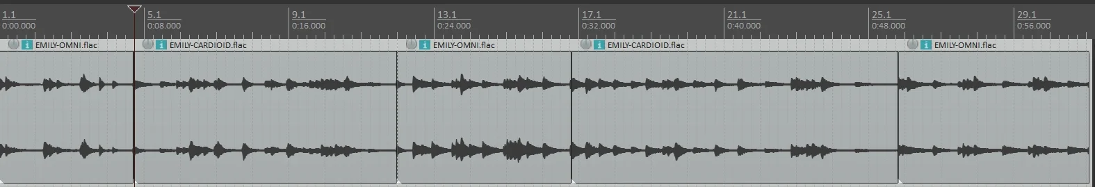

I did a similar slice and dice. Here's that file. I've also included a photo of the chops, so you can get an idea of when they occur. One last note, I had to reverse the stereo file of the cardioid to match the sides of the omnis. The bass was left on the omni, but more right on the cardioid. I flipped it to match.
