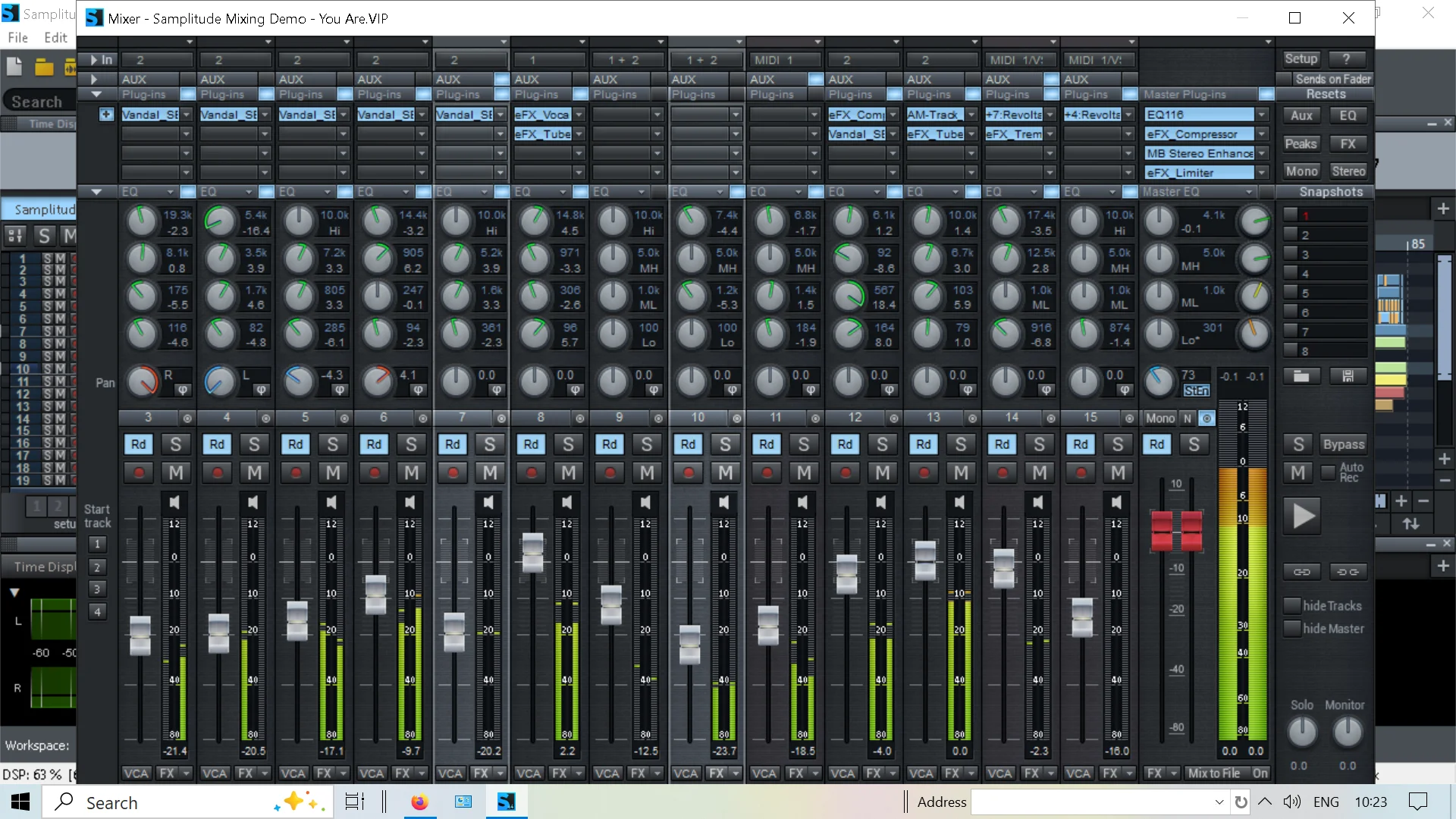

That snapshot is of the Samplitude Pro X 6 demo tracks and you can see that each track runs quite low, certainly below -10dBFS (at which most peak) Some average a bit more than -20. I suspect the engineer was of the "neg 18" school? The master stereo output is crowding 0dBFS.
If you have say 8 tracks all peaking to -3dBFS then I don't see how you can bring anything up? To do so would mean bringing all the tracks down some dBs to "make room" for it?
