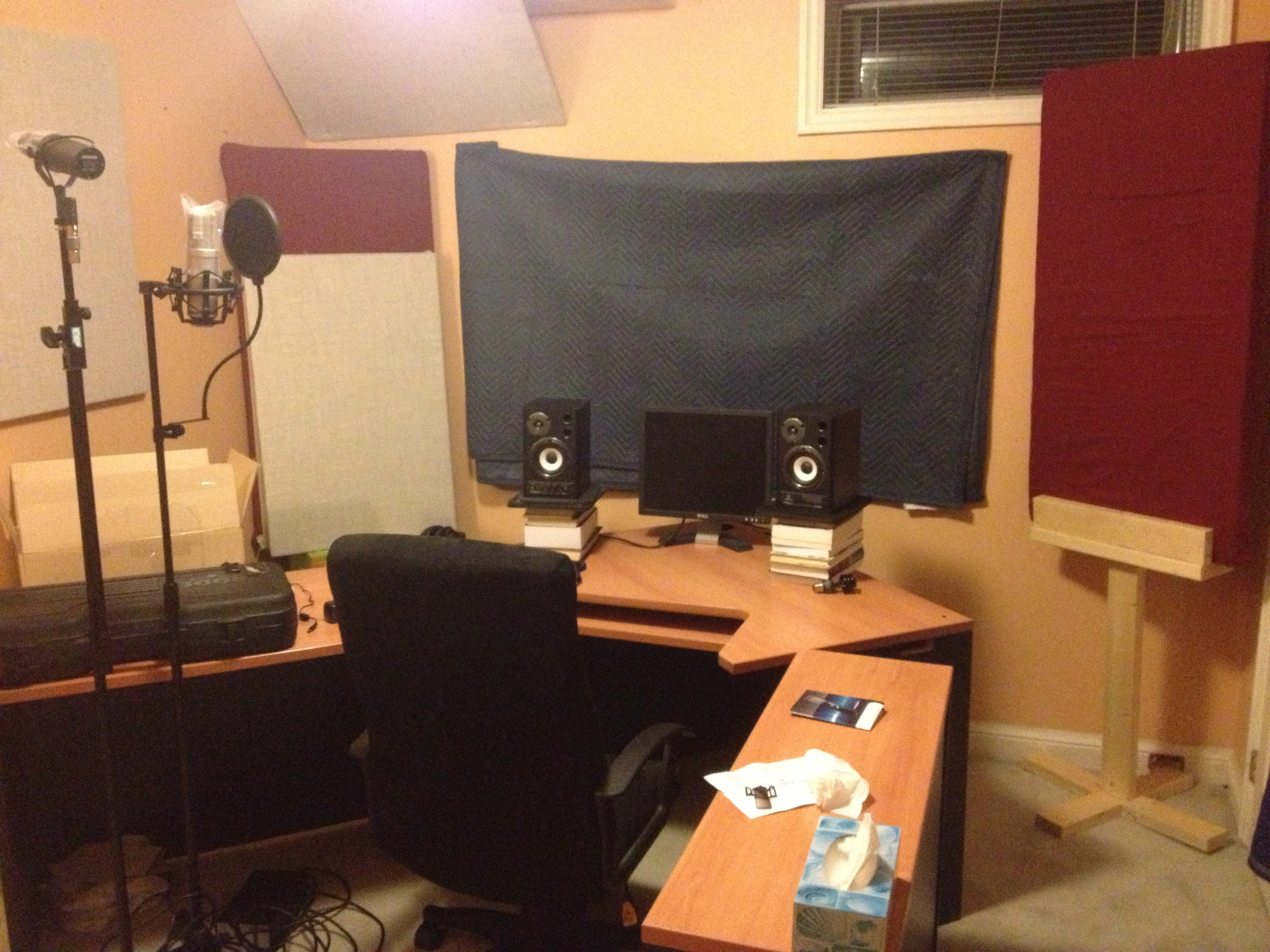

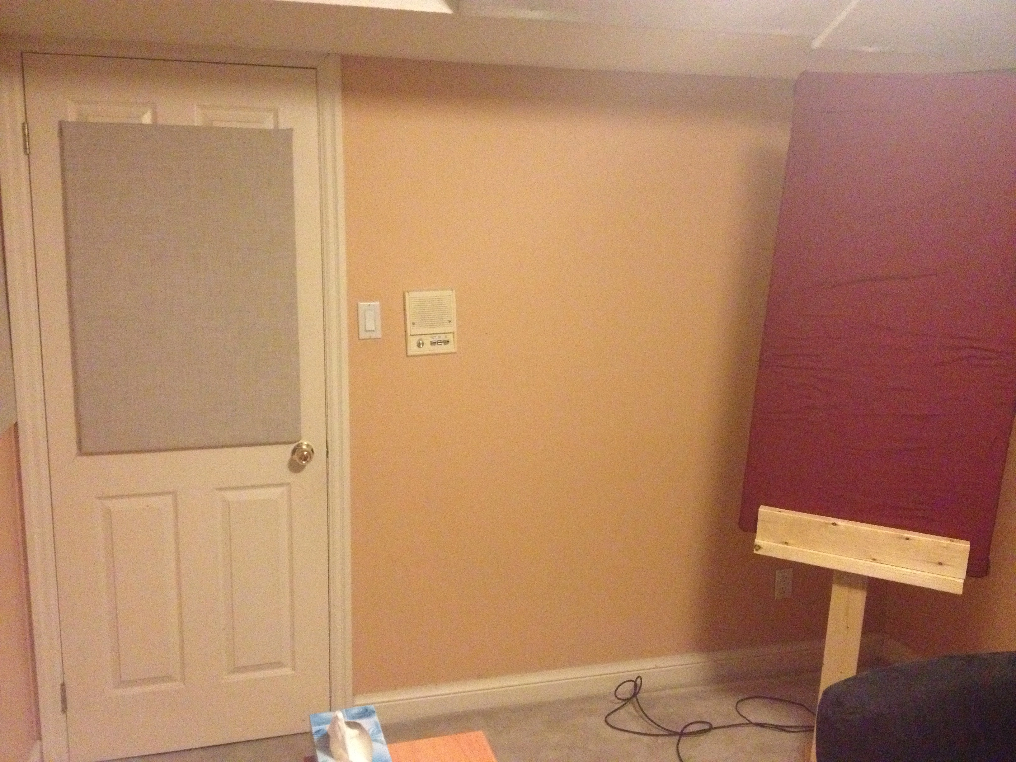

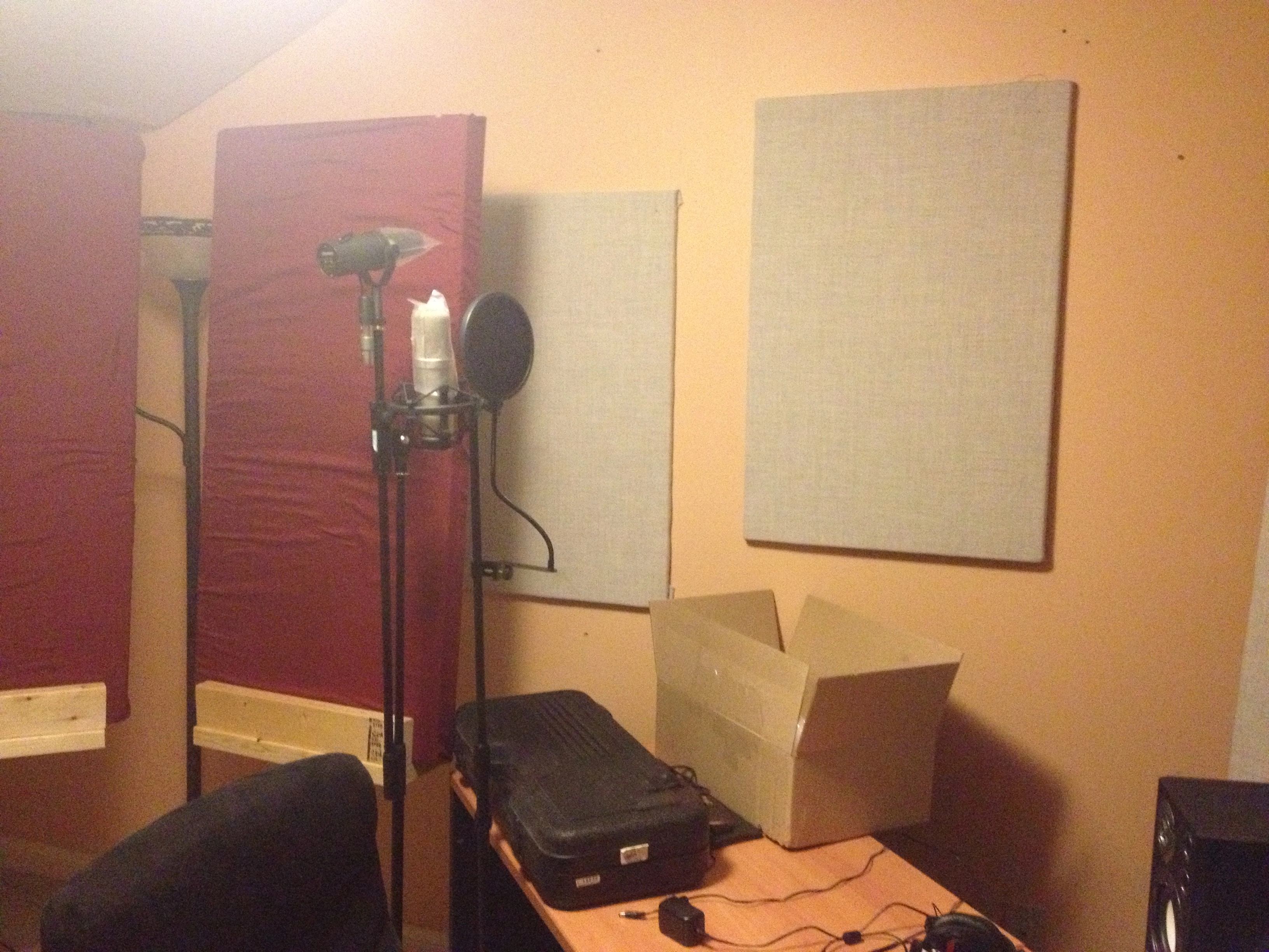

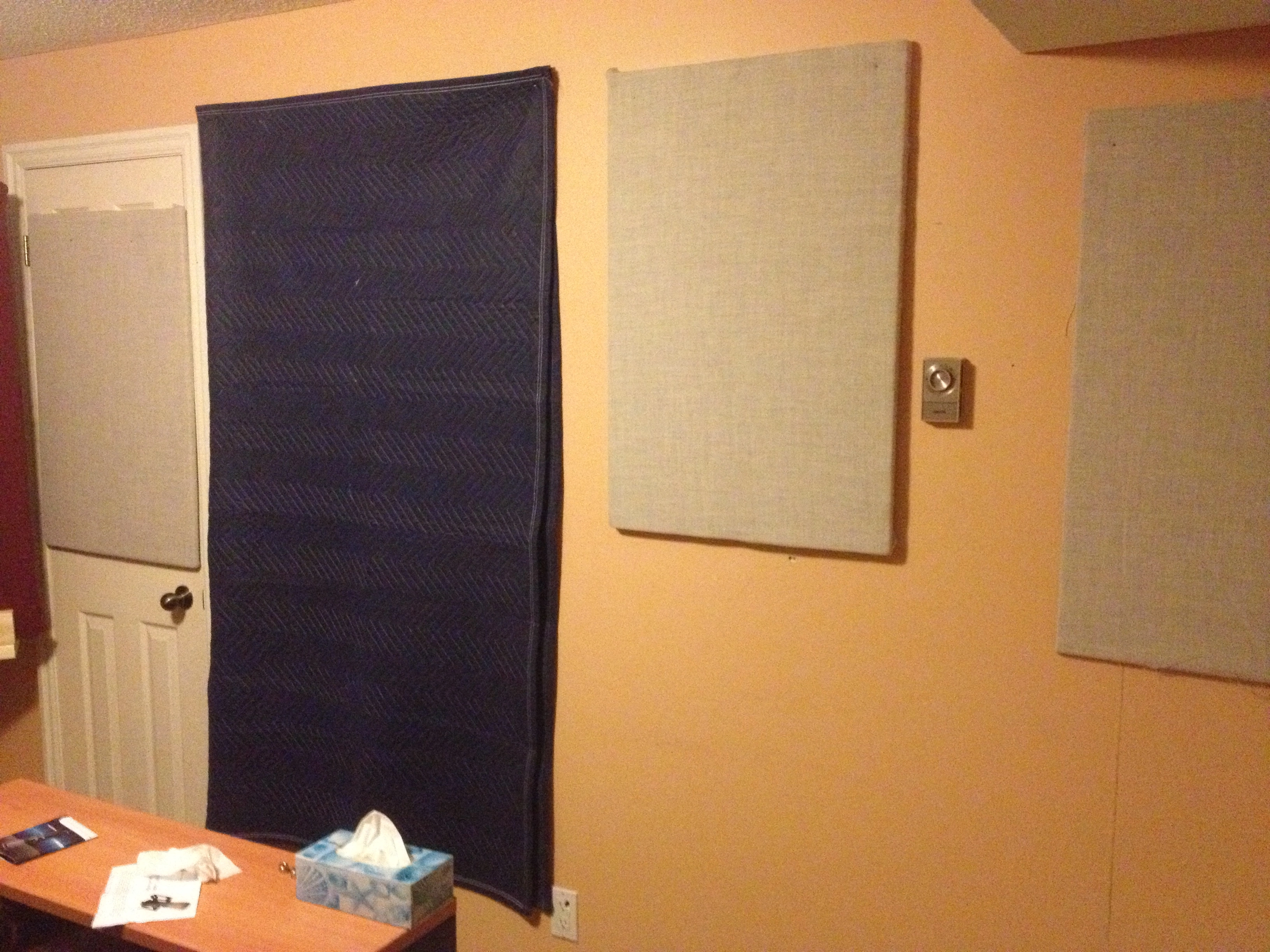

here is my room

Its everywhere that you have recorded anything at all, no matter what mic you use or what room you record it in. And just recently its in the guitar track as well. Trying to find the best mic in this instance is going to be hard while you have this other problem with the gear. I don't believe it is the room and it certainly isn't the mics. If the Focusrite Scarlett is working properly, then it is good enough for what you want. I can't think of a way to attenuate the highs with the DAW on input and if you are not applying any EQ on your exports, I am inclined to believe, if pushed for an answer, that something is up with your Focusrite. Again, I would trust the Focusrite for quality but things can go wrong with any product and just this particular one may be bad. Given the information, that is all I can come up with that makes any sense
