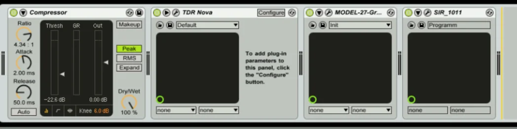

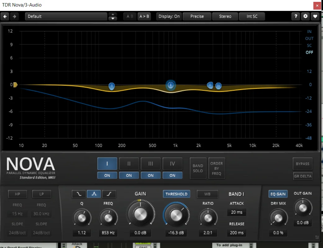

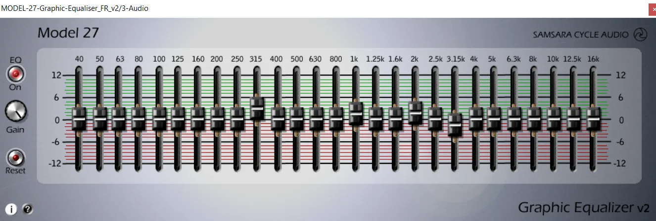

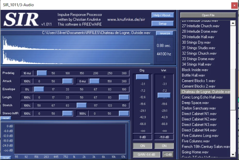

I have close to 25 years working with vocal tracks. I did a processing demo attached below. In singing that is a glottal shake, it is an extra vibration in the vocal chords, sometimes done for creative effect. I did not change or correct the pitch, that might be needed in some moments. It's not necessarily bad sounding to let the pitch move a bit. What needs to be done is to smooth out the level of the vocal recording because the dips in level (caused by close mic) sound unpleasing to the ears.
One concept to understand is that a far away mic (not practical for home recording) does the same thing to the sound as a compressor: it evens out the level. So every recording that is close mic recorded needs to be compressed hard to take away that artificial sensitivity. It would be like sitting right next to the singer and hearing them when we typically hear them from the seat while they are on a stage. I got most of the sake to go, but what is left is the sound of the tone change.
Most of vocal processing should be to take the raw recording and to even it out so it sounds like its coming from a stage in terms of it's dynamics.
I have done this with my typical set up and posted images of the old 32 bit plugins that I have on my old 32 bit laptop!
I sent your track through my normal chain (attached below with wet and then dry 'the original take'):
Overall compression > Specific resonances compression with multi-band > very specific character boost EQ > add reverb
the threshold of the compressors is key: basically you want to get it so you are putting the threshold of the compressor at the level you want the vocal to be on average. Then everything above it gets smashed a bit, and the softer sections below remain untouched. The multi-band compression then smooths out the various resonant issues.
View attachment 150663View attachment 150664View attachment 150665View attachment 150666
