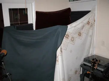

Best thing to do would be change rooms. More practical thing to do would be to deaden the room you got with blankets or foam, if I understand your question correctly.
Try Dampening the room, and use less sensitive mics with tighter pickup patterns (Dynamics like the Beyer M201 or M88, or Senheiser MD441), and close-mic everything. And get a real kickass reverb with lots of good small to medium-sized room emulations. It's about all you can do.
I have had similar problems. I have been hanging up blankets putting pillows on the floor and try to sing close to the mic so it won't pick up the room as much, and also I use a popfilter.
It has been helping a lot.
evt
