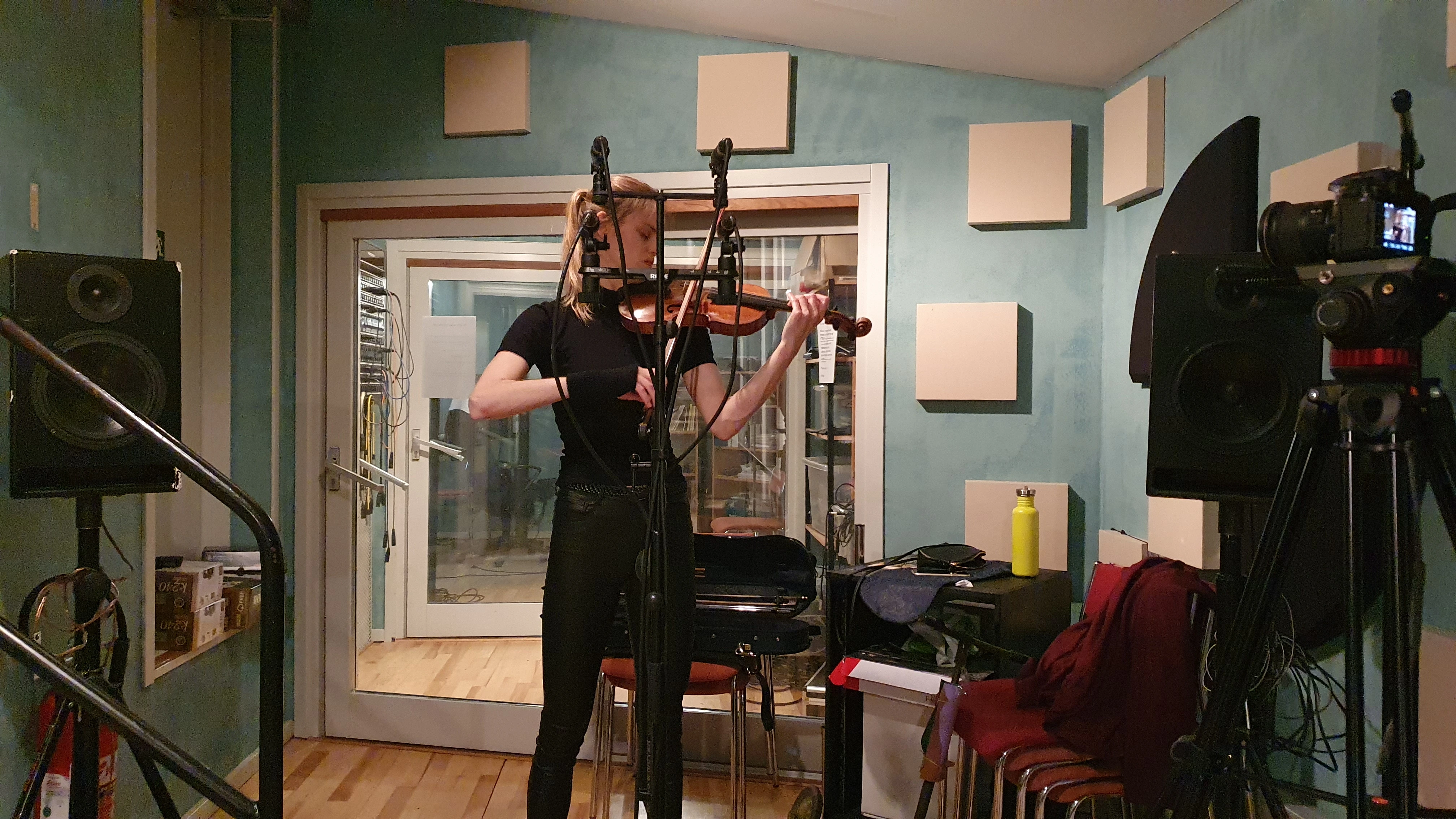

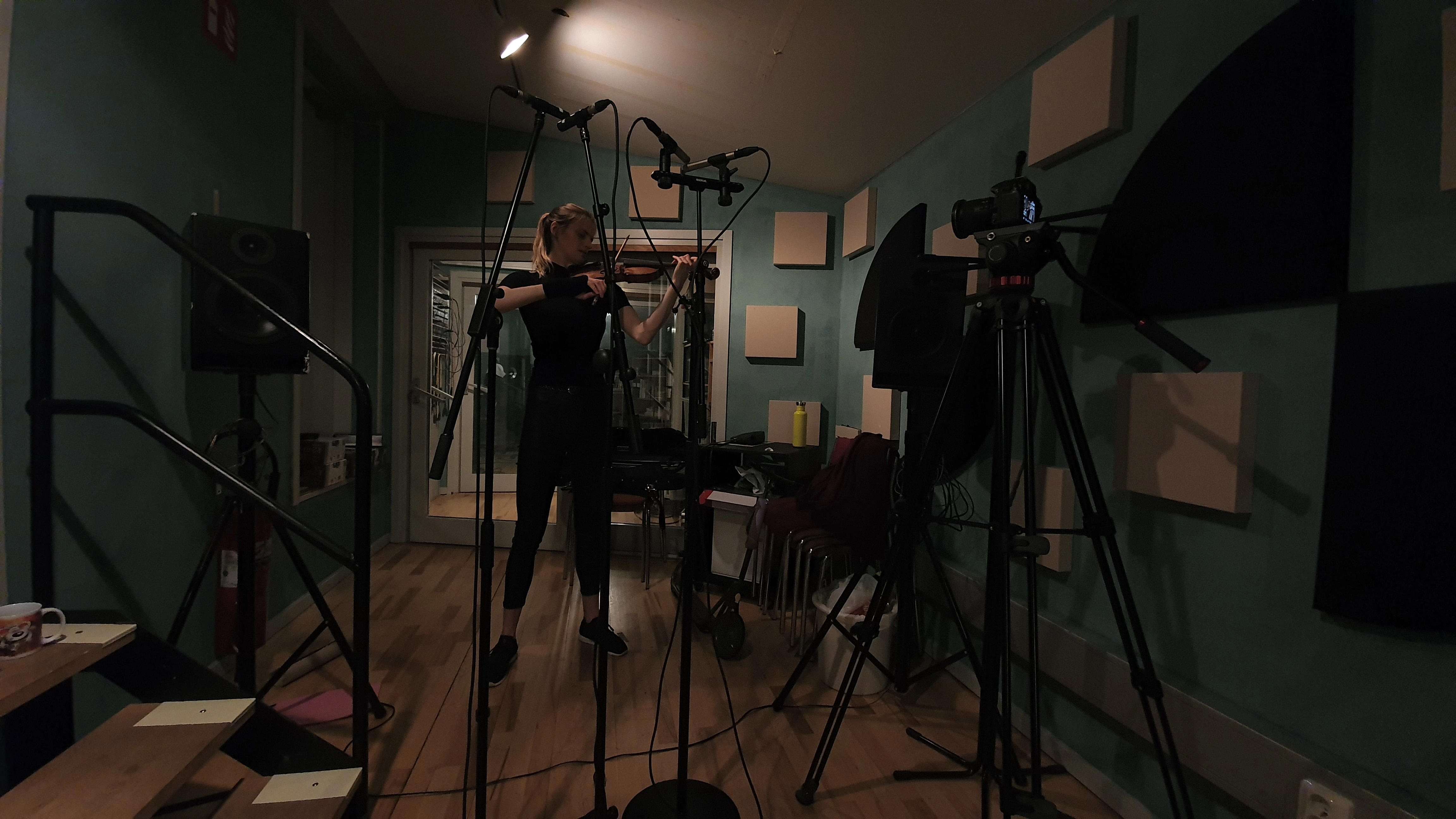

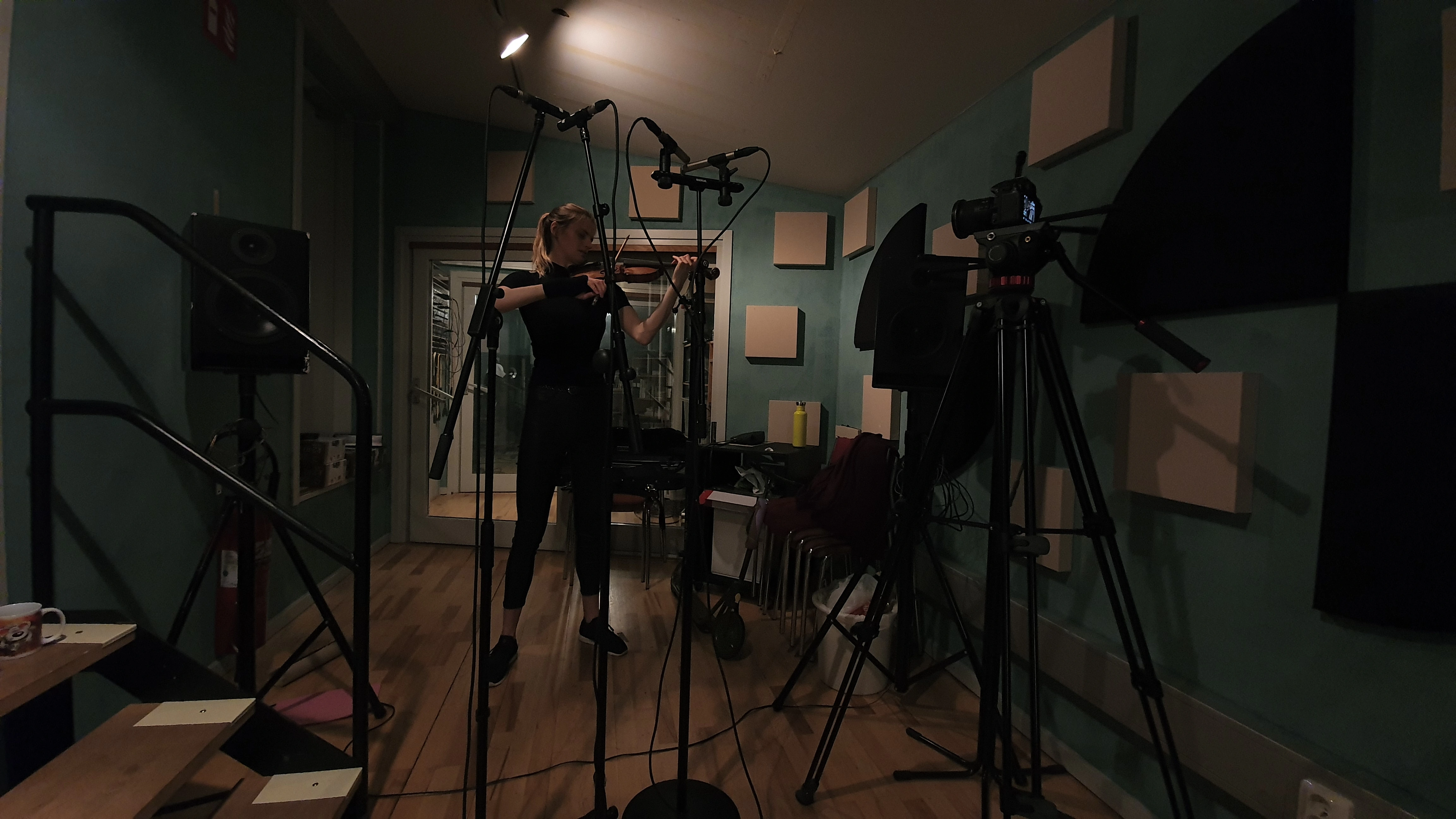

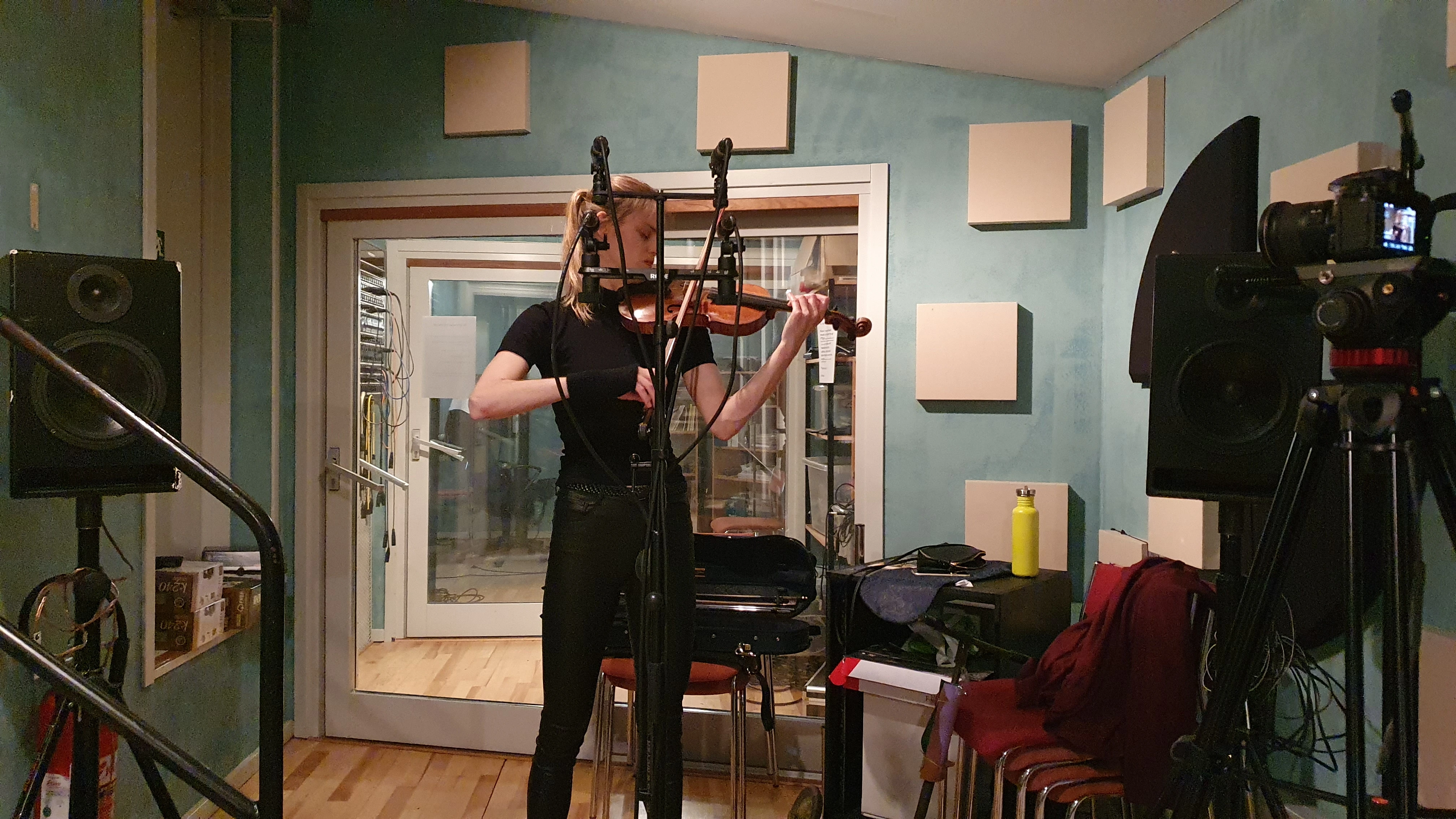

Hi Dave and thanks for your analysis.
the NT55 is a bright mic, indeed. I would love a parif of DPA5011 but, so far, out of budget!
Here is "Adagio e Fuga" with AB setup(omni):
YouTube
Here is "Ciaccona" with XY setup(cardioid):
Ciaccona Version 3.mp4 - Google Drive
I like the AB setup much more!
The snag here is goal seeking. What, exactly, are you hoping to achieve? Are you hoping to record the sound of a space with a violin annoying it, or are you trying to record a violin with an annoying space intruding? Or somewhere between. Are you trying to record what somebody in the front row would hear, or someone at the back (or somewhere between). It's signal to noise really, but your aim is a little different to what the big classical recording companies or broadcasters would choose.
There's nothing wrong with your omni recording apart from that it's not similar to other recordings of this genre. Technically, the recording is competent. Aurally, for me the cardioid wins but the violin seems mobile and wide. Recording with two mics is very difficult, but you are persisting with your quest, and don't seem willing to try alternatives. If you listen to classical recordings, do you hear recordings like yours? They're just a bit unconventional. It's often fruitless to ask the musicians, they hear things differently to the audience, especially brass players. One tip. Press the mono button on your recordings, this might demonstrate that your distant techniques are tricky used close in.
The M/S suggestion for you would be a really good one. The ability to change perspective afterwards.
You might actually like spaced A/B as it has a huge sound, have you tried this?
As I also do video work, I've got a little violin lyre that allows me to mount a small omni on a violin, and blending this with a distant stereo array used conventionally can work brilliantly.
Your X/Y array in the video is it crossed? It looks spaced, so is really A/B with less rear? It's rather unusual. You have sort of invented a new technique?
