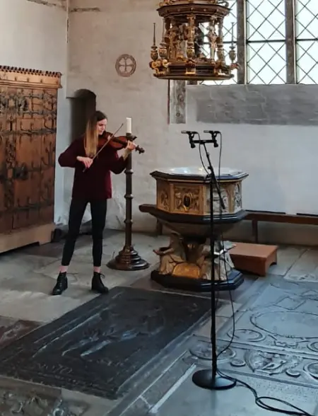

Hello everyone,
I am totally new to audio recording and I am try to get into the subject. I will try to summarize all my struggles in a very simple way and hopefully get good advice on how to continue.
-What I need is to record classical violin solo pieces, both in recording sessions as in live performances (audio/video).
-Gears I have to use:
  • RECORDER: ZOOM F8n
  • MICs: RODE NT55 matched pair on a stereo bar (cardioid and omni capsules available)
  • DAW: Studio One 3 Artist
-The violinist is very skilled and the violin has a beautiful sound
-We also have the possibility to record in church
-I was thinking to try both X/Y (cardioid) and A-B (omni) mic techniques in order to learn

I guess the mics were a bit too far away and it feels a bit thin with too much ambient reverberation maybe due to the big distance.
Next time I would definitely try X/Y setup with cardioid. I will also read a bit more about MS setup and maybe also try that out.

You've picked up lots of things, but completely missed context. The 3:1 rule, for example. This phase cancellation happens when you have things like a singer playing a guitar and the vocal mic picks up the guitar and the guitar mic picks up the vocal and the combine destructively. That ratio makes each one have more of it's wanted source and less of the unwanted source, so the cancellation effect is much less - look at the inverse square law if you like science - every inch/cm you can add to one and remove from the other has a very big impact.
With stereo ambient capture it's totally different. You need these differences. Difference in level between the mics and difference in time, as the sound travels further.
A pair of omni mics can create a HUGE sound field, yet convert directional information. A pair of cardioids creates directional information, but does it differently. In X/Y, for example, they are placed as close together (diaphragm position) as is possible, so sound arrives at both simultaneously, the stereo information being created by the polar pattern of the mics at an angle to each other. Other techniques combine the two components.
In your example, you forgot one thing. Focus. Omni in a very reverberant space capture the sound of the church really well - BUT - what they capture is a mess. You also need to evaluate what a stereo mic setup is doing. A violin is considered to be a single sound source. It has very little width, so move left to right in front of it and nothing really changes. A trumpet is a point source - even narrower. A piano however, is a BIG thing. Sit near it and the left hand note clearly comes from a different place.
If it was me, I'd have used one mic on cardioid setting much closer. I'd have also recorded the stereo church sound, and blended the two together. The church is stereo - BIG TIME!
You've also missed the point on frequency response. The frequencies you mention - they're the fundamentals - a Stradivarius will have lots of interesting overtones above that top limit, and I would not use a dynamic mic on a violin. Ever. I want all that stuff up the top. That doesn't mean that it has to be tinny sounding. It just gives you EQ scope. Every violin needs help here. Wrong or just inappropriate EQ is horrible, but gentle assistance makes them beautiful with a decent player.
For me - close perspective with the mic 18"/450mm from the f holes (maybe a tad more if it creeps into the video frame, but no further, and if possible above, looking down. They actual distance often has to be set by the player's style. Some are rock steady and don't move, others wave around crazily. The stereo mics maybe 10'/3m back, central and high.
Level wise - get the player to play the loudest part, drop the gain so you have some headroom at the top - on your recorder, that's actually easy as it has plenty of headroom, and then leave the gains alone.
The snag is you only have two mics?
The only solution here is to get the mics very close in to maximise direct sound and minimise the space contribution. Be aware though that any movement from the player will do wild things with pan.
With just two mics, I might sacrifice reluctantly stereo and record the church ambience in mono and add some stereo reverb. Not good process, but the only alternative is crossed pair, close in, on cardioid, then gradually increase the difference till it sound best in the headphones. That's a lot of faffing.

Way too much room in the audio in that recording, at least for my ear.
I think rob & I are kind of saying the same thing. You have to be closer to the violin to control the amount of room, and it's easier to do if you record those aspects separately. You just have to experiment, but a 3rd mic of good quality for just the violin will give you more flexibility. (With that church ambience, you do not need delay or reverb.)
I have found it hard to get in that .5m range with many players when they are standing if they move much, and still keep the mic out of frame. Of course, if you are zoomed like the video, you can get very close, but then the mechanical noises of playing, like fingers and bow (and breaths and other vocalizations from some players!) can start to be intrusive.

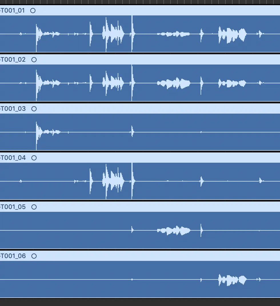

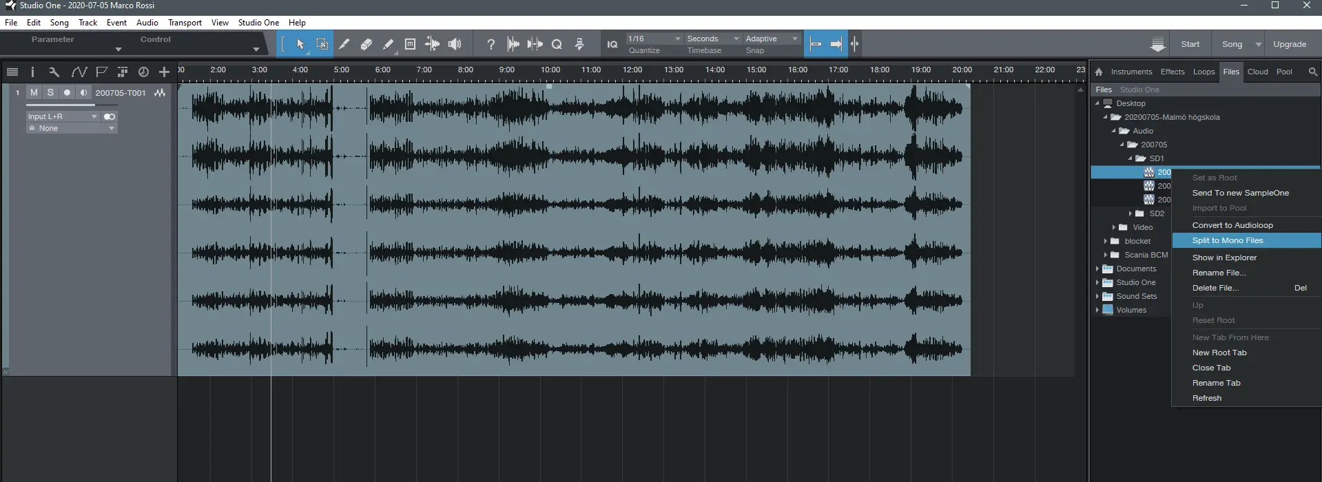

As results I have got a single Wave file with 6 audio waves in it (see attached pic). In order to work with these data in post, it looks I need to split the tracks in separate mono files first and import them again.
The question is: which is the benefit in using a polywave file when you anyway need to split the track in multiple files in order to work with them?
What I expected as output was a single wave file that, once imported in my DAW (Studio One Artist), It would have shown each channel on a separate track.
What am I doing/thinking wrong? How do I know which file is which channel once I split the polywave file in separate files?

The only reason I could see for having a Polywave would be that its an easy way to contain all the tracks in one file. No chance of losing anything if you store it for archiving. Consider it to be like a ZIP file.
I'm curious how the comparison of the NT55 and the K184 came out. Was there a big difference? Which did you like better? I've done that on some recordings where I used multiple mics so that I could compare and pick the one I prefer.
I liked more the Neumann but now I am more struggling in getting things to work :-)
How do I know which channel is which now? :facepalm:
If I split the polywave in single mono files I doesn't say anything to me on which was on channel 1,2,3, or 4
I know that in Reaper, if you split a multi track file into singles, they come out in the order of the original file top to bottom. A L-R stereo track goes to 1-2.
I guess you could set it up the way it was when the original recording was made and then tap each mic to identify the track that was assigned. I don't know how Zoom set up the polywave, but I would assume it was just channels first, then the L/R....?
When I split the file into mono files, I get separate files with a number that, probably, is the same as the channel. Anyway the L+R track was numbered 5 and 6 while those channel were not used ....

I just tried it, and I was wrong. The first two tracks were the LR, and then it was 1, 2, 3, 4. Here's a pic that isn't real clear, but you might be able to discern where I spoke into the mics I had laid out left to right, plugged into inputs 1, 2, 3, 4. (Plus the bump where I laid each down after talking into it.) The first 2 tracks are the L+R recording, followed by the individual mics. (You would then pan those hard L and R to start. Not sure what the L+R recording gives you, but I'm probably repeating myself.)
P.S. (edit) I noticed after the fact that I had some panning set in the tracks - most noticeable is 3/4 which were L40 and R40, though 1/2 were L20 and R20. That shows up in the LR tracks, but the mono tracks are just the straight mic, with no panning. It *looks* like the LR tracks are actually R/L???
P.P.S. (edit 2) Just to clarify the F8n setup, the PAN setting (access via PFL is how I do it) really only affects what you hear in the headphones, and also what is recorded *if* you opt to save the LR tracks (i.e., in addition to the input tracks, which are *not* affected by the PAN setting - they are all/each just MONO tracks). I used PAN to help monitor live recordings, but used different panning in the DAW mix, as appropriate. I am not familiar with your DAW, so it might be less confusing to not use polywave, and if you really want the LR track, just use that mode on the second SD card. Then, when you go to copy your files, you'd only use the SD card with just the actual recorded tracks, and save the SD card with the LR recording if you needed it. Polywave does have the advantage, assuming your DAW supports it, of just popping everything in to the project exactly aligned as recorded, vs. dragging up to 8 files into the DAW.

Hello Keith, exactly the answer I was looking for. Thank you!
I have recorded the L+R track just for test/learning purposes; I actually do not need it and yes, also for me, it was track 1 and 2.
I will also try to make some extra test after work so that I will have it more clear. Maybe it helps to configure some metadata for each channel directly in the f8n to figure out which is left and which is right afterwards (talking about mono tracks)?
Probably using the "mono/stereo wav" instead of the Polywave recording setup will make life simple just for that.
