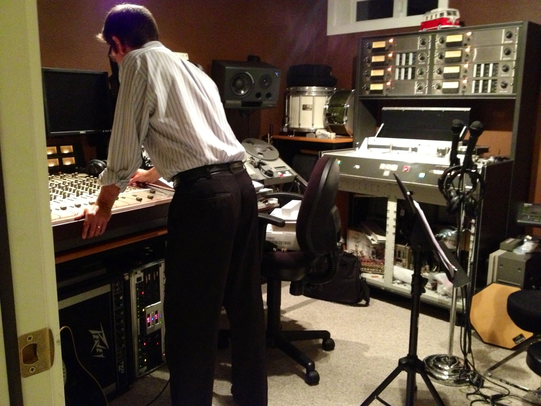

Hhhhhhhholy smokes...tracked drums to the MM-1000 for the first time tonight. There are definitely some HF response issues (I'm fairly sure these issues are mainly related to the need for proper biasing), but overall it's not bad, and the kick drum...it sounds HUGE. This is one thing I LOVE about analog multi tracking: it's so much easier to get a good sound. I haven't even really messed with mic positioning...Audix D6 in the kick, pair if Studio Projects B3s for overheads. Using the onboard pres of my prototype 80s Tascam mixer...I'm so excited!
Glad to hear that! And if you bias it right, you'll probably saturate your tape LOOONG before you clip any of those beefy electronics on the machine.
Love the photo. Gotta dress for the occasion right?
Heheh...still in my monkey suit from work... :D
