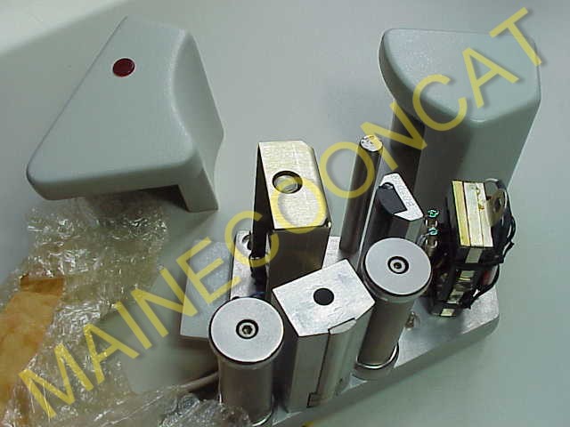

So I got that NOS VR-2000B quad video deck erase block assembly from which I intend to scavenge the two 2" rolling guides. Unfortunately one of the guides barely rolls. One of the bearings is partially siezed so the thing rolls like a tight detented knob. :( The seller said in the listing that both guides rolled smooth like new. I fully believe this issue is unintentional as when I put the guide back together it rolls smooth but that is only because the inner race on the bad bearing is spinning on the shaft...the shaft is oiled and (as with any of this old Ampex stuff) is an extremely precise fit with the bearing so it feels like a smooth ball bearing so I can understand how the seller thought all was good. Can't run it that way though. I've sent the seller a message.
This is how it goes when doing a project like this. Nothing really goes without a hitch. I've come to expect the unexpected with each step, though it still is disappointing. Two steps forward, one step back. :o
I'm pretty sure I can get that bearing replaced but I'm checking into any caveats. I'll need to do the oven thing like I have with other Ampex transport parts where I warm up the component to get it to expand so I can get the bearing out. The bearing is not pressed in nor is it held by a snap-ring but it is in there tight and I won't try to drive it out as the roller is too delicate and precise.
Anyway, here are better pics of the erase block than what I put up earlier. First two are of the full assembly and then a couple with the covers off. I think the list price of this assembly new was $2800. That erase head is a full-track head for the video.
The fact that you can only get those things out by heating up the metal is astounding precision. I'm sure you'll get there with some patience. Nothing can stop you!
Yeah, Muck...check this out...here is the direction I've gotten as far as getting those bearings out: heat the bearing assembly up to nearly 500 degrees farenheight :eek:, and then use a fancy bearing puller (about $65 for the tool) to pull the bearing and work quick. I typically McGyver some other way to do things when can or build my own tool rather than purchasing an expensive tool, but honestly my assessment on this is that I need to follow that advice. The wall of the roller is relatively thin and the proper puller would be necessary to keep the roller completely intact in removing that bearing. The integrity of the roller is critical. So I'll see. But, yes, I have been floored by the precision of some of the machining in these parts. As somebody that used to work in an in-house machine shop for a small manufacturer, many a time have I pulled something apart on an Ampex and said (out-loud) "wowwwwwwww!"
