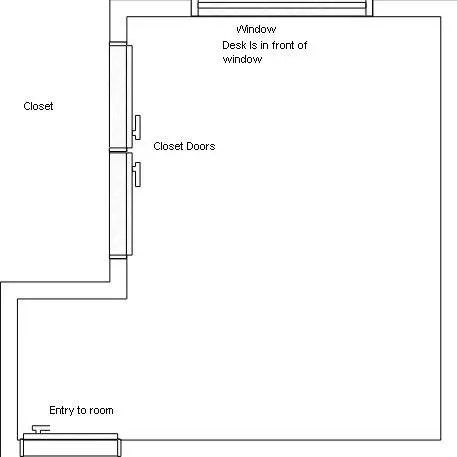

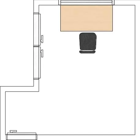

Hello all,
I hope this isnt an anoying overly asked question.
I am recording just a few things, mainly acoustic guitars as well as hand percusion, vocals and a bell kit.
Is there any special things I need to do in terms of sound treatments when recording specificaly acoustic guitars?
I have been searching but have a few questions.
1. How do I know were to place foam or home made absorbers (I am thinking of building frames with fiberglass and fabric)?
2. In terms of my mix position, I have a outside window. If I hang heavy curtains is that a bad thing if I have my monitor backed up to them?
3. the room is kind of "L" shaped is that a hard thing to over come when tuning the room.
4. I'm lost were do I begin.
I have also attached a couple of diagrams of the room to show layout.
Thanks for any help you can offer as I am very confused on were to begin.
-Blaze

Blaze,
> How do I know were to place foam or home made absorbers <
Have a look at my Acoustics FAQ:
www.ethanwiner.com/acoustics.html
It explains pretty much everything you need to know about acoustic treatment and where to put it.
--Ethan

Blaze,
> Is it ok to place a couch behind the mix postion? on the back wall. <
Listening in front of a wall that's close behind you skews the frequency response in a way that's difficult to fix. The basic problem is comb filtering, which is a series of peaks and deep nulls. All rooms have peaks and nulls at low frequencies, but the closer you get to the wall behind you, the worse the problem becomes.
Then again, if the couch is mostly for the band's girlfriends, who cares? :D
--Ethan

Acutualy what I meant was, Can I place a couch across the room behind my seating position? I was planning on building a huge difuser for the back wall(I think thats what its called), to put above the couch.
Also two more dumb questions if you dont mind my persistant nagging. :)
1. Am I suposed to place absorbant materials behind the desk(meaning when I am sitting looking at the monitors at my desk)? I ask as my desk is up against the wall with a window. and I was planning on hanging heavy (I mean thick and heavy heavy!) curtains. (Sorry I am sure your cringging right now)
2. Have you ever heard of a mirror being used for placement of absorbers?
Any links for further info on building difusers and absorbers?
Thanks and thanks again!
-Blaze
Can you not do it? ;)
How big is your room? Generally it is said, that a diffusor closer to the mixposition than about 3,5m is a no no!
I suppose you want some absorbtive panels between the speakers and the wall! (at least 10cm thick)
Can't you move away from the wall?
You have a friend move the mirror around the room flat on any reflective walls and surfaces. Whenever you can see the one of the speakers in the mirror (you're sitting at the mixplace) then make this spot absorbtive. This kills early reflections.
The links I gave you should tell you everything about absorbers you ever need.
Greetings
Florian
Blaze,
> Am I suposed to place absorbant materials behind the desk(meaning when I am sitting looking at the monitors at my desk)? <
See this article on my company's web site:
www.realtraps.com/art_front-wall.htm
> Have you ever heard of a mirror being used for placement of absorbers? <
That is explained in detail in my Acoustics FAQ I linked earlier in this thread. See the sidebar "Creating an RFZ."
--Ethan

So if I have Heavy curtains or absorbers there it can cause to much deadining?

Yeah I can move it I was just wondering if placing an absorbant couch there is a bad thing?
>How big is your room? Generally it is said, that a diffusor closer to the mixposition than about 3,5m is a no no!<
the room is 12ft deep(from mix position to back wall) by 9ft 1in. with the entry also at the back of the room.
Can't you move away from the wall?<
Sorry no I cant realy move away from the wall as the room is pretty small. and I am backed up to a window with curtains.
Thanks for the links again dreamer!
Another question considering the little square entry to the room.
Should I place any absorbtion or difusion there? and were?
Thanks guys! I will be doing all this stuff in a week or two so all this info is great and apreciated!
-Blaze
Well about you square entry way I think it wouldn't be a bad idea to make a wall/door there, Im not sure on the amount of space you would lose but it may be worth it. I was in the same situation as you are and the entry way and I settled on building a wall. My room was a "L" shaped room that opened up to a stair well that had horrible flutter echo, now that theres a wall there everything sounds so much better. I to will be using that room acoustic and vocals before I bring that band in. What ever is more convinent for you may work just fine.
About desk, how far up against the wall is it? It would be best to back it off the wall as much as possible.
matt
I cant do any permanent mods to our house as we are going to sell as I stated earlier.
And the desk is right against the wall cant do much as I dont have any room.
Thanks, hey what part of MN? Im from Burnsville originaly.
-Blaze
hate to say it but "Bump"! :eek:
I has hopping for a few more answers to the above questions if Ethan has the time? :)
Thanks
-Blaze
Blaze,
> Should I place any absorbtion or difusion there? and were? <
That room is too small to benefit from diffusion. You can put absorption pretty much anywhere, but especially on opposing parallel walls, and near live instruments and microphones. I'm not sure what else to tell you that isn't already explained better and in more detail in my FAQ.
--Ethan
Thanks Ethan! :)
Sorry If I am being a bit of a pain. :o
I guess the biggest question that I have that I am not finding the answer to is:
Do I need to build something to hang on the back wall (Behind me) to break up the waves or is my room small enough that all I need is to hang some absorbtion there? Cause I am reading far to many things that say one thing then another........ I'm confused on the back wall and that little elcove mosty, I am pretty clear on the front and side walls.
In the elcove is it best to put absorbtion there, is that what I am getting from this?
Thanks and sorry to be a nagg. :o
-Blaze
Blaze,
> Sorry If I am being a bit of a pain. :o <
Not at all. This is what I do! :D
> or is my room small enough that all I need is to hang some absorbtion there? <
Right, absorption is perfect there.
> I am reading far to many things that say one thing then another <
Diffusion is useful too, but not so much in small rooms.
--Ethan
