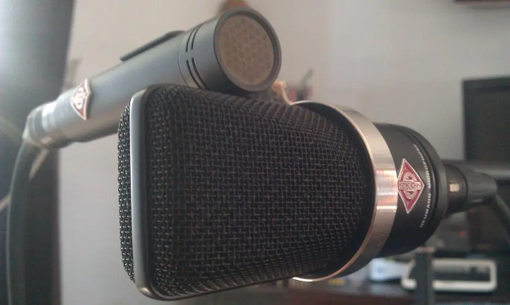

I usually start with a small diaphragm condenser around the 12th-14th fret pointed very slightly toward the sound hole and tweak from there. Sometimes I pair that with a large diaphragm condenser out in the room to catch some ambient sound
the other day that didn't work for me so I did this at around the 10th fret and it gave me what I needed for the song with each mic going to a separate mono track I could balance the sound of the two differently as needed throughout the mix to bring out different aspects of the guitar sound
Every song is different and you have to know what you want to achieve at the start and work toward it to get the sound you want
