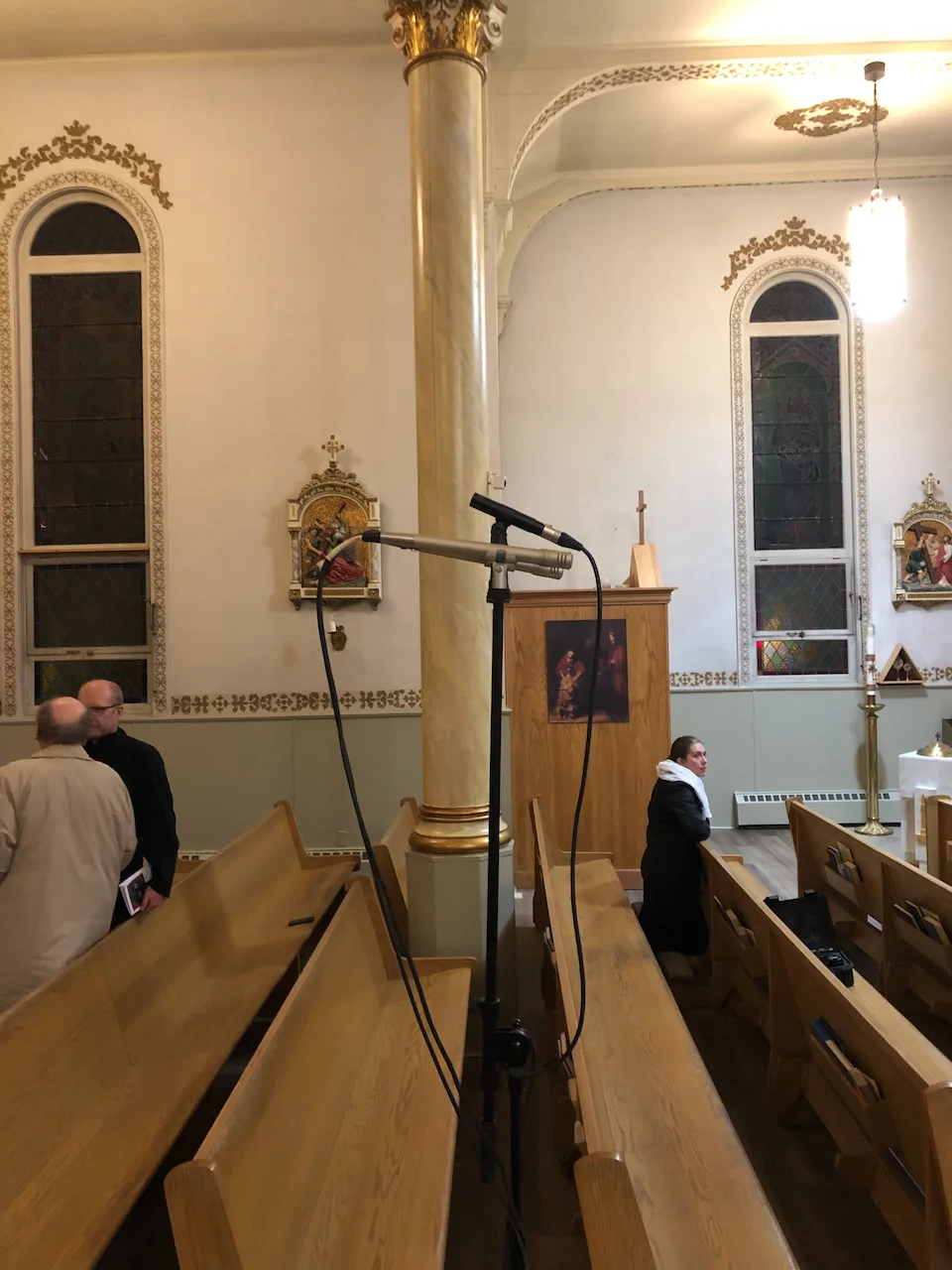

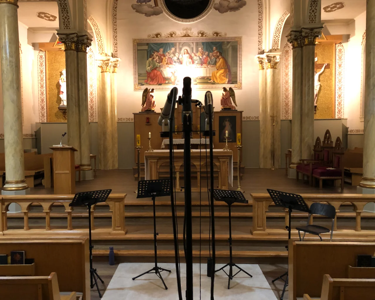

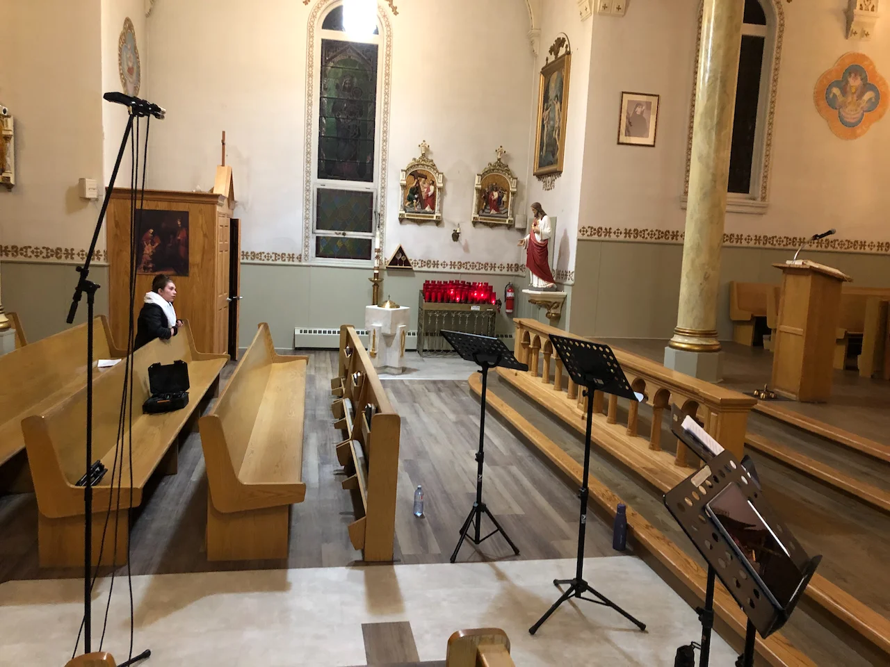

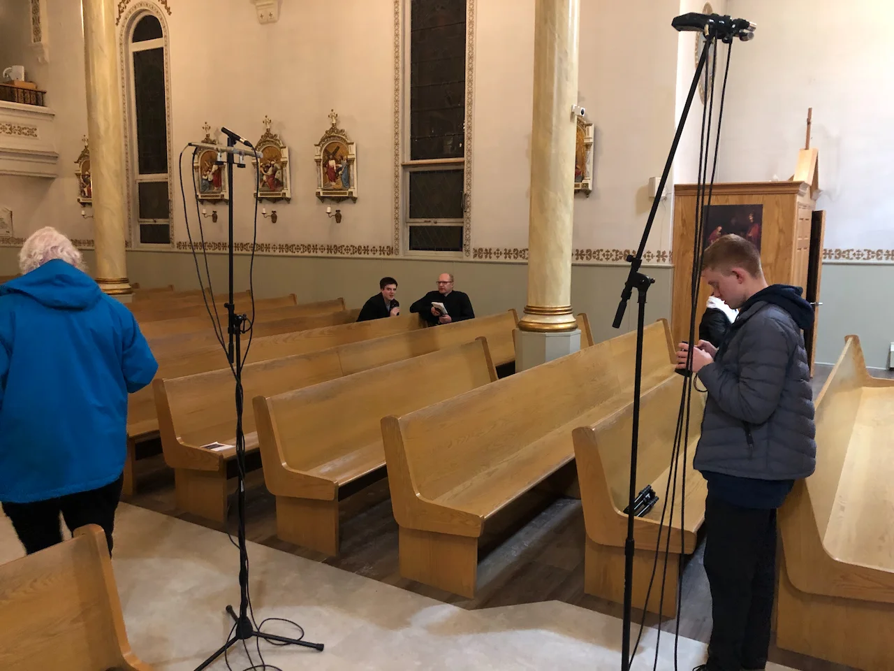

I ended up having the Zoom X/Y pair ~2m away and slightly above, relative to the singers:
Then I did something funky a bit further back:
I realized I don’t have the necessary mounting hardware for a proper ORTF pair... so I had a weird cross between ORTF and A/B with the SM81s, and the lil pencil condenser pointing away and up for shits and giggles / room ambience.
