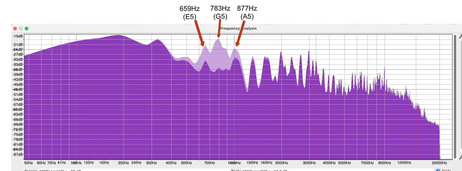

Ok, this is interesting, but I still think it's likely strings/setup, maybe some technique, e.g., compensation learned playing on a very different instrument (playing .008s on electric) can really not work on something else, but that's a stretch.
I captured the 2 above, normalized and the only place something really sticks out (which is not quite what I hear) really suggests maybe bad setup/frets, too light strings? Who knows. The difference from the EQ'd one just shows a big difference in the area that is harmonics of open strings. Without hearing the single strings played hard, it's difficult to know what's going on exactly, but I'd be suspicious of just about anything without having the guitar in hand.
p.s. (edit) - the E is the E octave, the G is an octave above the 12th fret G, and the A is 2 octaves above the 12th fret A. (If I can do the arithmetic.)
p.p.s. (edit2) - stretching my google skills here, but this Am chord, with the open 4th of E and A is likely creating an implied 7th....

I think OP’s guitar has a setup or fret problem on looking over the graphs. The peaks that were EQd out are essentially the 12th, 15th and 17th fret notes of the first string. Now, the E and A might be natural overtones, as they show up in the earlier comparison against my old mahogany OM, but the G? It is actually in that first comparison (not on my guitar) but I overlooked it. The guitar’s own body resonance might be amplifying some overtones more than others, but I don’t see how a note that’s not being “played” (Am chord) is going to suddenly pop out at that high frequency when its lower octaves are not there.
