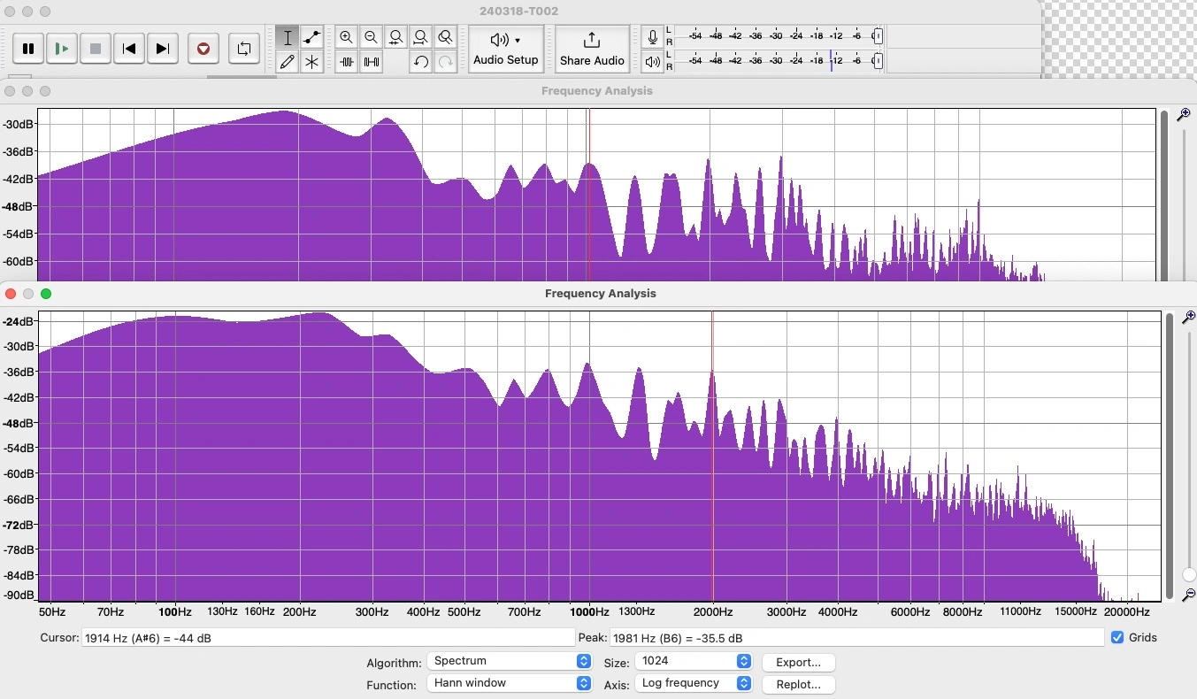

I'm just not hearing anything I'd call resonance. Maybe some room, tuning, setup issues? Have you had your hearing checked? (Seriously.)
I'm attaching a quick analysis of a section I captured of your playing the Am chord, and then did some loose strumming of an Am on my mahogany OM guitar, recorded into Audacity, with the same analysis. Yours is on top in the image, and mine is on the bottom. They're not that different, at least I do not see anything jumping out there in frequencies where I'd be bothered - maybe my eyes are as bad as my ears, though...
Have to say, though. Your recorded clip is doing exactly the same thing, probably more so!
Yeah, well, I did my best :) - strumming is not something I do, at least not like that... I don't hear "resonance" so much as string balance, or perhaps un-balance, but I'll do a capture of those other clips, put my glasses on, and look.
Oh, I'm not suggesting you did something wrong/badly.
I'm suggesting maybe it's a non-issue.
