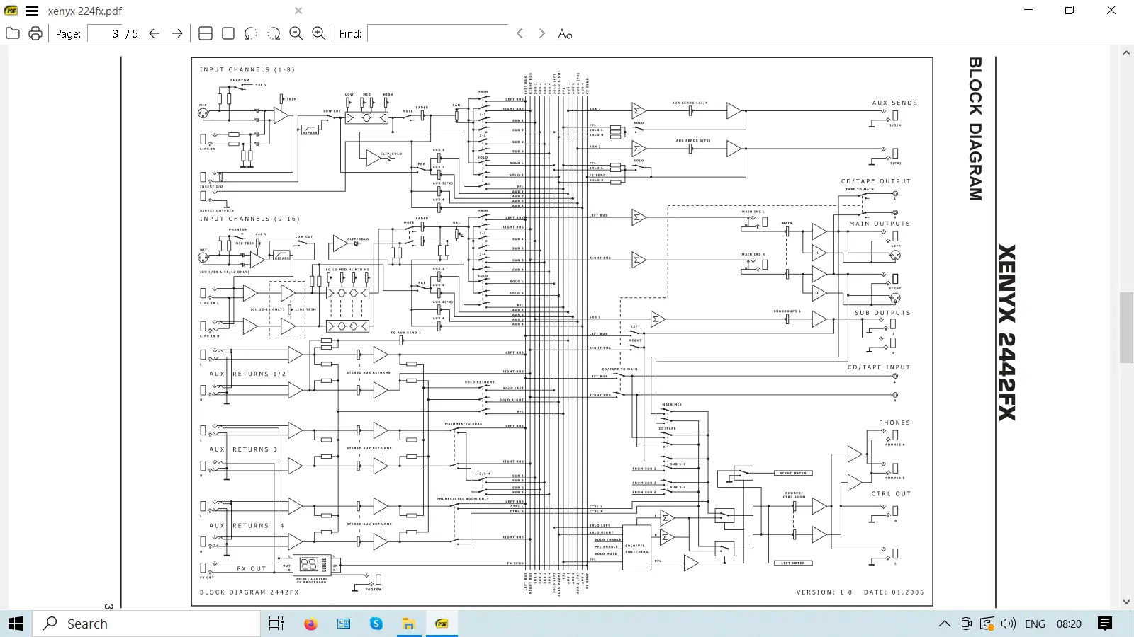

Attached is the block diagram of the mixer (or a variant with FX!) No doubt your eyes are better than mine but I still suggest if you can to print it out with increased contrast.

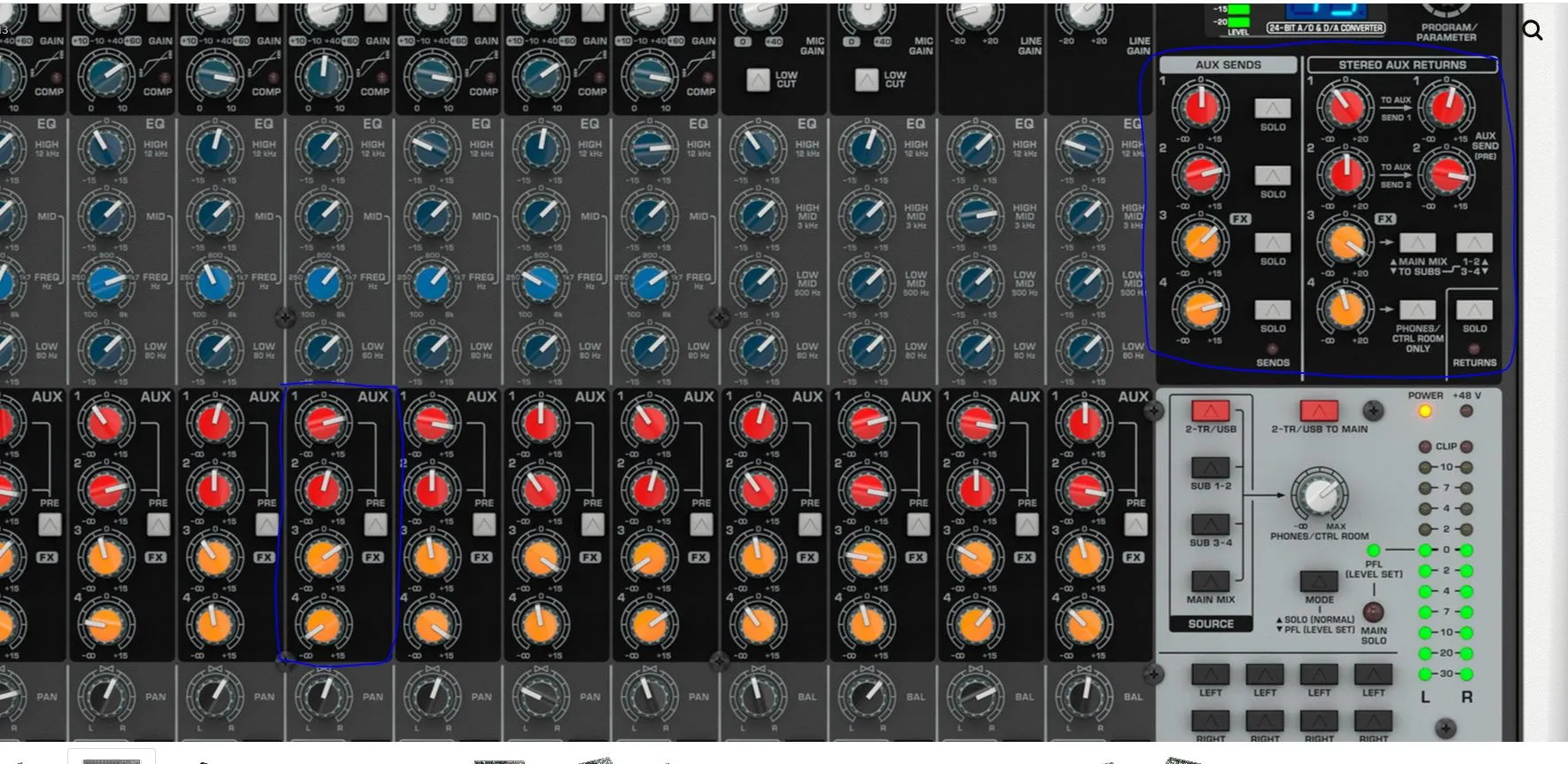

Attached is top and back of the mixer. AUX 1 and AUX 2 go to EQ then to POWER AMP. For FX I also just read I should somehow bring the internal FX to a strip and use sub groups. This seems a bit complicated. Thanks again for getting back to me on a Sunday.
Thanks so much I like having some diagrams with these things. I will print this out at work on a better printer. My eyes are 50 years old lol/ Thanks for helping me on a Sunday.

Use FX Out and patch it to Aux Return 1 or 2, depending on which one you're using for the singer. Use an "insert" cable, one TRS connected to two TS. If you want it in both monitor mixes, use a couple of TS-F to TS-M splitters to patch it into Aux Return 1 and 2. Based on the block diagram, that should give you independent effects level control in the main mix and in the monitor mix(es).

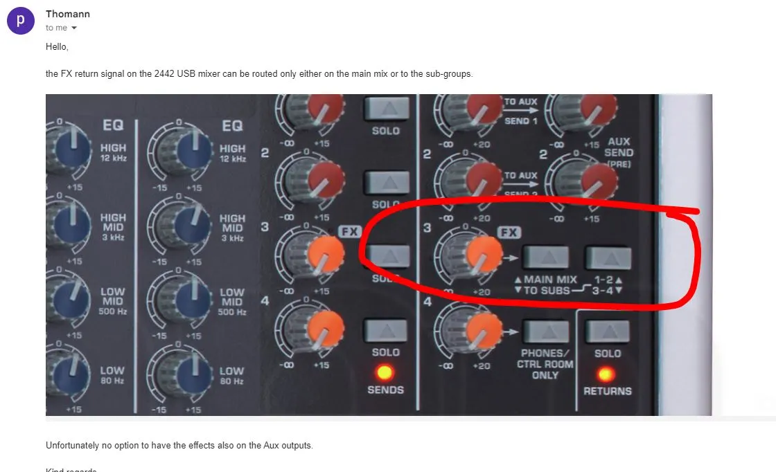

EDIT: Just received an email from Thomann, where I purchased the mixer. Just wanted your thoughts. I think is what I also read somwhere about sending the FX to a sub group. I apologize for being such a noob.

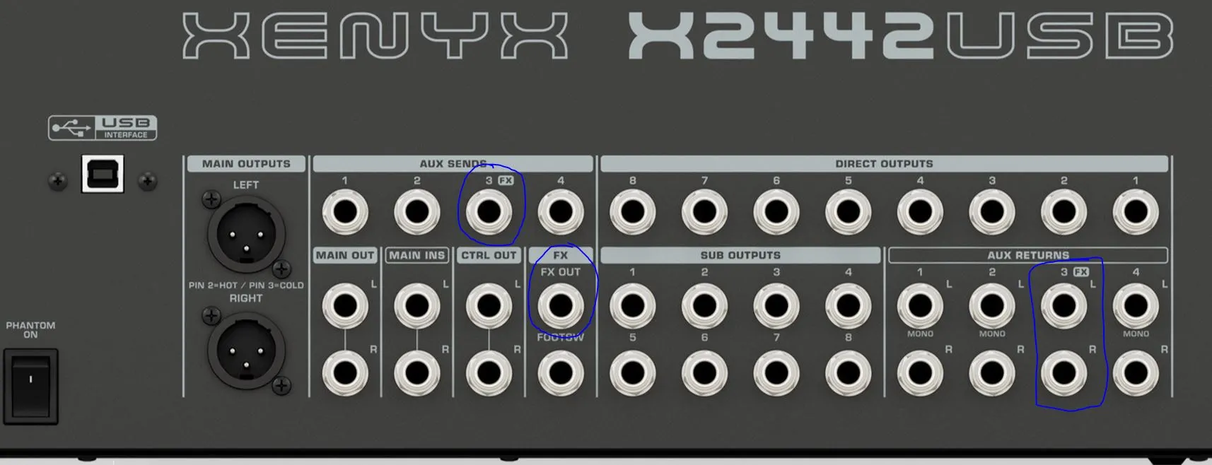

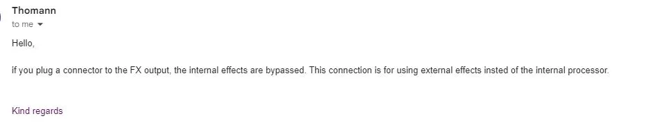

EDIT: Received a but more info about the FX out jack in the back. I hope to test all theories out tonight. Thanks again
