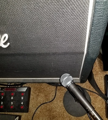

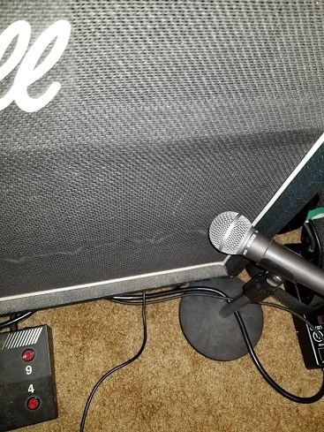

I a about 3"out from the grill, which is 1/2" from the edge of speaker mount. Mote my mic is near the rim of the speaker when I angle it towards the coil
Ok let me get a picture one second. You are really describing this in detail. Make sure I have it close.
If I back the SM58 off 3" is it cool to replace the basket? It shouldnt effect the sound, or does it?
Is that the secret? No baskets?
I'll ask again, what is wrong with what you got? Those sounds are not weak or thin.
The basket is not the "secret", there is no secret. You already have a perfectly usable sound. You can stop looking for some magical technique that professionals don't want you to know.

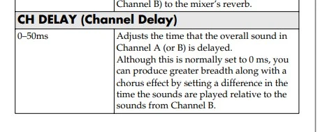

It is in the EVH presets. I think it is to thicken the stereo chorus sound. If they are using these short delays, I want to preserve them as best as possible when multitracking. So Lowest SPLS size and least latency is paramount.

The channel delay on your guitar preamp has nothing to do with the recording latency or SPLS size. You seem to be connecting things that have nothing to do with each other.
