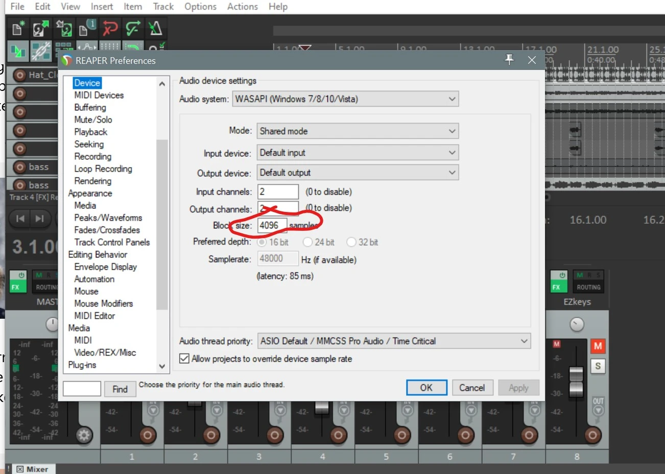

What is SPLS Block size again? In Reaper options there is a block/sample size. I kept it low at 144(lowest) to decrease latency. This might not be a perfect fix. My recordings sound thin. Could it be my sample size is too small, and that's doing it? When I increase it from 128(144) to 4096 ( A setting I saw on Todd's screen pic) the drums hit better. Have you tried recording a source with a low and high sample setting? What were your results? Will this make better quality recordings , like Mp3 bit rate does?

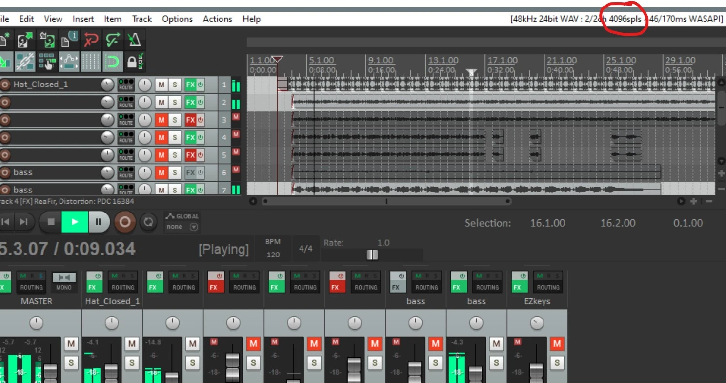

If I use 128 sample size, I don't need to nudge it that far to align the project. Great for recording midi input. But is it making cheap quality recordigs for a microphone?

SPLS is basically buffer size. Higher figure = higher latency, higher stability. Lower figure = lower latency, lower stability.
The quality of the recorded signal is determined by the sample rate and bit depth, i.e. in your screeen shot, by 48khz and 24bit. SPLS does not affect recording quality and is not responsible for any thinness.
The quality of output (WAV or MP3) is determined by the settings in the Render dialog box.
That means samples. Building up a bigger store of samples (buffer) before sending them to be recorded or played means there's less of a chance of running out (which would cause clicks and pops or similar effects), but it also means a longer wait before they're heard (latency). Other than the possible clicks and pops or latency, it won't affect sound quality.
If you have to nudge recordings you probably need to manually adjust the record latency (which is different from the monitoring latency). Normally, the software detects it accurately and sets it automatically so there's never a need to nudge a recording, but sometimes it's not detected accurately.

Its a simple calculation what the minimum latency will be for each block size. Buffer/sample rate is the minimum latency you can have. Having a 32K buffer with a 44.1K sample rate will give you about 3/4 second latency (32768/44100 =743ms)! This is one case where the higher sample rate is a plus if the laptop can process the data coming in efficiently.
At 44.1kHz sample rate:
64 samples = 1.45ms delay
128 samples = 2.9ms delay
256 samples = 5.8ms delay
512 samples = 11.6ms delay
At 96kHz sample rate:
64 samples = 0.67ms delay
128 samples = 1.35ms delay
256 samples = 2.7ms delay
512 samples = 5.8ms delay
