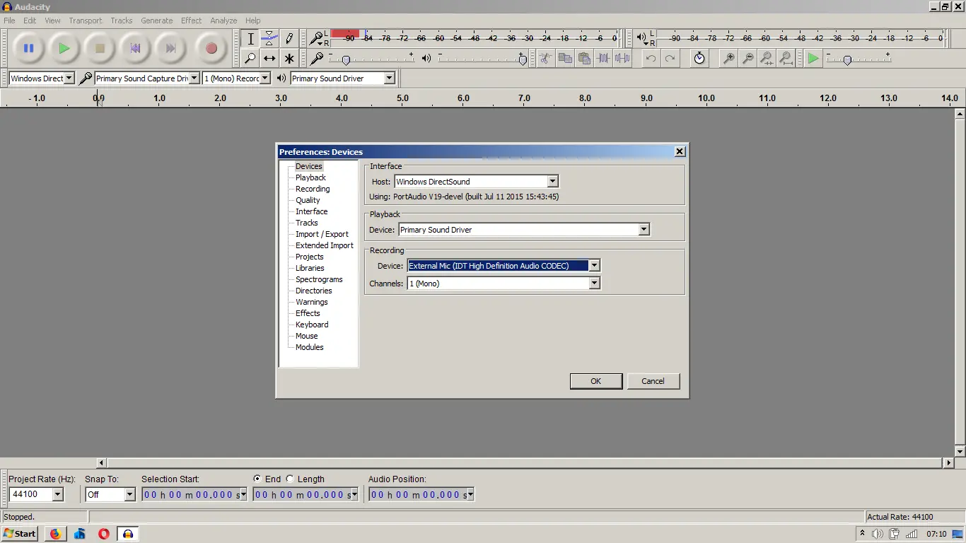

It could be a setting in Audacity that is not seeing the Right channel, you may have the recording input set only to Left. Maybe the track is mono and the input is left, if you want stereo then set the track up as a stereo track and select both channels of the UCA222. I don't know enough about Audacity to tel you more.
Alan.
What Alan said ^^ is my guess as well. I'd put my money on Audacity recording and playing back through just the left channel
As attached you mean chaps?
