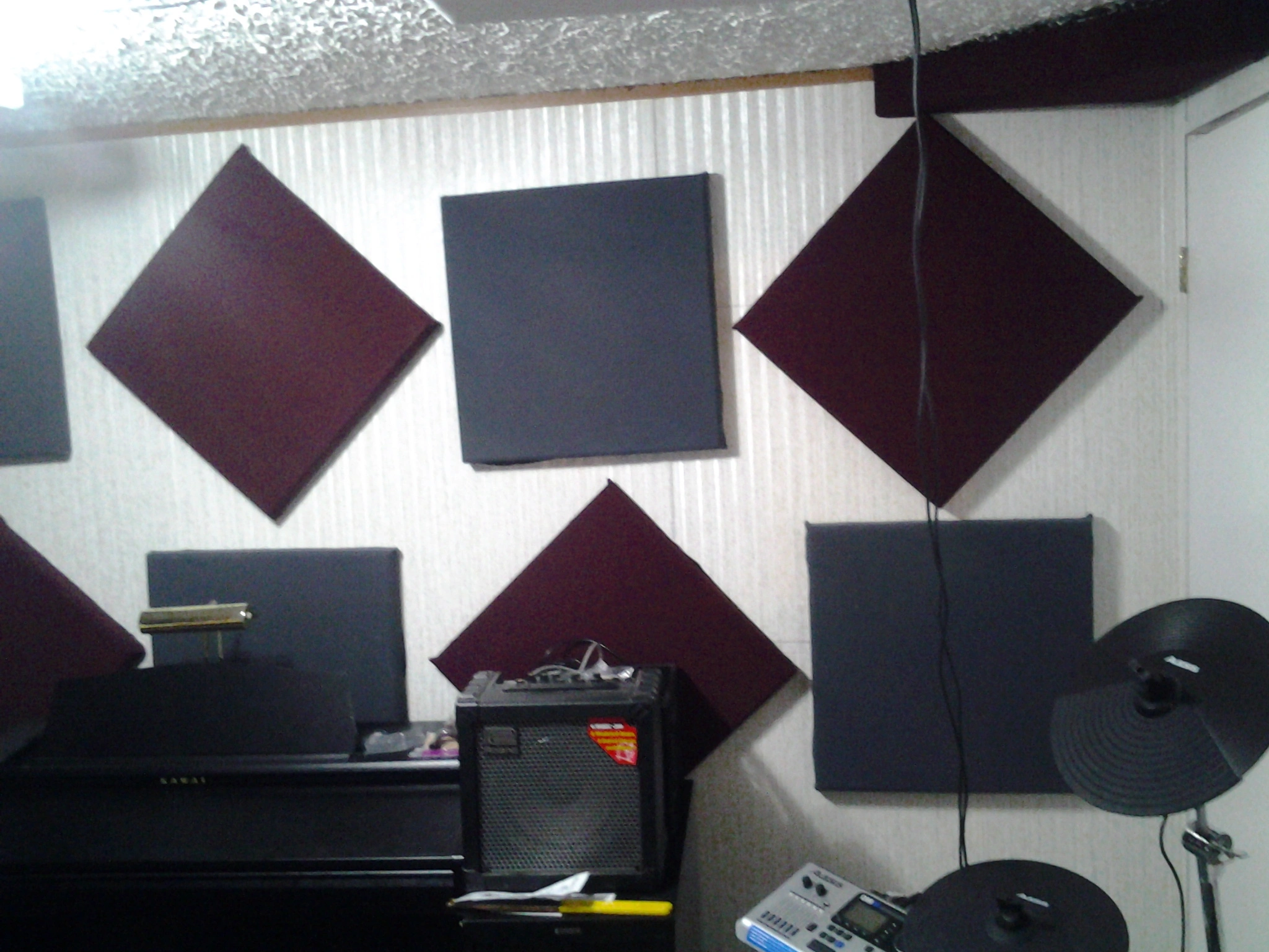

This is the pattern I was talking about. Works really well with 2" (25mm) rockwool.

Your steps on the process to build frames are right on the money. All my frames are 2'x2'x2" to make the pattern in the previous post. I have 2'x4'x4" ceiling clouds. I have purchased 6" bass traps on top of superchunk in two corners. My back two corners have doors in them, thus the red triangle in the corner (what you can't see is more 6" corner traps on the back wall.

Step 6. Trap the sides. If you use a pattern and cover most of the wall, you will probably get away with 2". If you just want to cover primary reflections, you'll want 4" or 6". and now here I will fall away from the norm on this site. On the side walls, there is a use for foam and I think Ethan and John will agree with this point. If you put foam wedge over your side (and rear if you're not building QRDs) it will help your acoustics as they will help with scattering. I don't understand the mathematics behind what this does, but if you need help with that, PM Etan Winer or JHBrant.

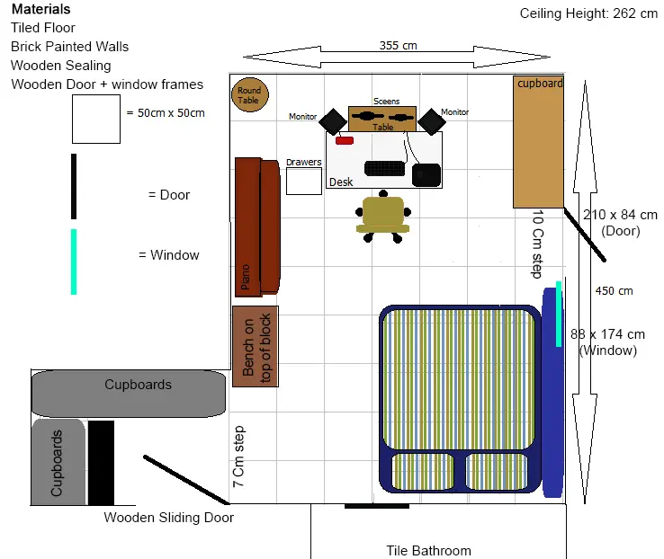

Heres the dimensions for my room again:
This weekend I plan to do corner bass traps first! So as you said above, do these go bam in the back corners behind my setup from floor to ceiling?
yes, in the front corners - where the little roundtable is (you can throw out the flowers, they must be almost dead!) and the corner next to the cupboard. Then the back corners/wall - above the bed in that corner, and the corner/wall where the pantry door is - leave the door open, space acts like a trap because the sound moves into it, doesn't bounce back.

On the back wall, I'd still recommend doing the ceiling/wall instead of wall/wall. The corner above the bed would be difficult to trap and not be in the way of the bed, but if you trap at the ceiling you can go from left to right all the way across. Yes, leaving the door open will also trap that corner! Nice catch, Mike.

I think for your room, the best advice you could get would be to trap the wall/ceiling left to right, meaning where the wall meets the ceiling, not upright (floor to ceiling) like the ones you will be facing facing. Use 6" (75mm) corner traps and hang them to the ceiling (or the back wall at the ceiling).
So basically like the front wall traps, but flipped horizontal across the top of the wall/ceiling corner?
