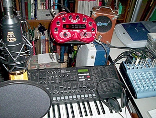

I have a musician freind who has a small project studio setup in what was the smallest bedroom of his house. Many of us would laugh at the gear and the setup. His room is maybe 8'x10' if it's an inch, and for recording he has one MXL V69 and one SM58 going into a $99 mixer (Alesis MultiMix 6). The mixer is connected to his computer running Adobe Audition via his stock Soundblaster card. He monitors via a better-than-average sounding pair of Altec Lansing computer speakers (no sub).
    Attached is a picture of what it looks like from his seat in his studio "cockpit" (the PC is off-camera to the right on the same desktop that the mixer is sitting on.) Note the the bookshelf/wall immediately in the background behind the Pod. The wall on the right is right at the rear of that desktop that's holding the mixer and the document scanner in the background. The left wall is maybe about a foot to the left of left edge of the pictured Korg keyboard (he has a compact fly fishing fly-tying station against that wall ;) ).
And that's it. About 3 feet behind the photographer is a closet and a door to the hallway. Very tiny room, just a taste claustrophobic (and warm) when you get two people in there. Three people could maybe fit in if nobody sat down.
Sure the room is tiny and the gear less than stellar (though I do rather like that V69 ;) ). And sure he has designs on moving his stuff to a larger space, which would be great. But the fact is he has that room designed with plenty of variety of natural textures in the form of bookshelves, small desks, window curtains, and flat surfaces (including hardwood floor), quality selection of spekers matched to the room, and he takes his time getting the tracking good to begin with (not all necessarily in that room) and takes his time actually *mixing* his work.
My point is, this guy has zero bass response problems outside of the limitations of his computer speakers (which frankly sound better than your average $250/pr "studio monitors"), and his mixes are more balanced than half of the MP3s I have heard posted on this board. I have been in that room, and worked with him in that room, and frankly I would have no problem with the idea of making a quality mix in that room (though I'd do all the mixing ITB and take the Alesis and SB out of my mixing chain ;)).
G.
