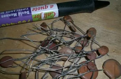

Here is my Bunch-of-Caps that I still carry around today....I will send you some if you want.....
Find the fix then determine how to deal with it. You may never be able to turn off all the FENCES......But you still want to record...............

well adwaz, ya sure got my attention ! Why didn't cha say you were a ekspert! You're absolutely right. No guitar, no tick, and it sure would be a lot easier to hook up a cap, rather than to try to find, and then keep up with problems with fences as they arise all the time! Was I close? A disc cap holds a little juice right? and you say I could hook it up anywhere....just connect one lead to a hot terminal and one to negative?..That simple?.. Could you give me a value range that I could look for? See, I'm a moron. Well, at least when it comes to electronic components. Awfully kind of you to offer to send me some caps, but I'll run to the Shack on Monday, and we'll know quick! ...see if you can help me out just a little more....should I start with a guitar? ...or the power cord on my amp....easiest would be to unscrew the cover on a cord jack, just cross hot to ground...right?.......if it works, I could then solder one inside my amp, at the input jack?.....
This is sounding better by the damn minute....
Thanks adwaz!
