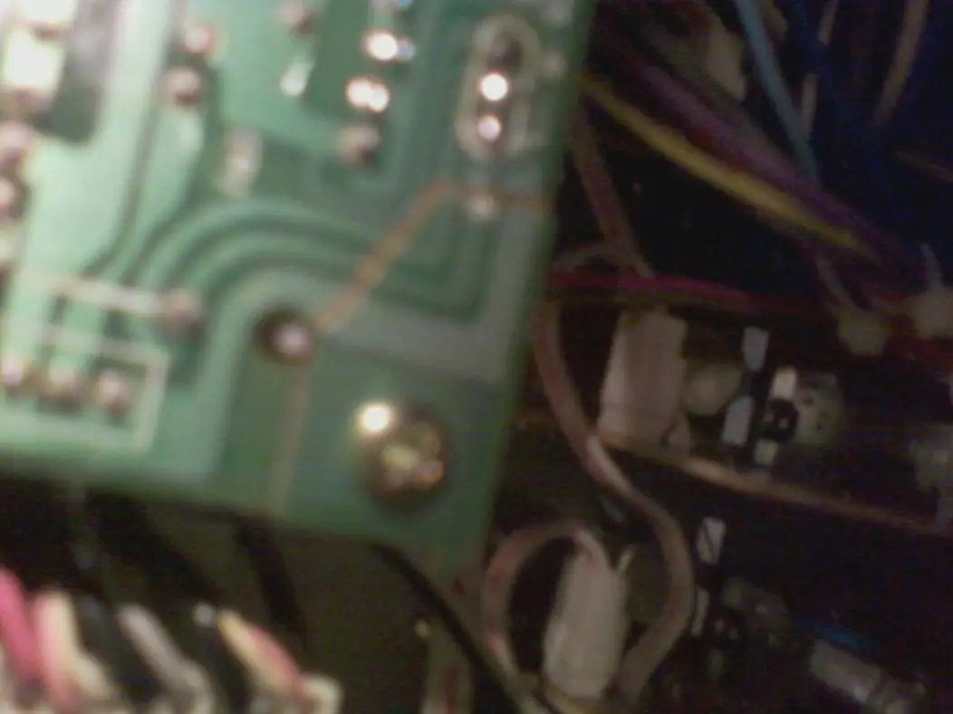

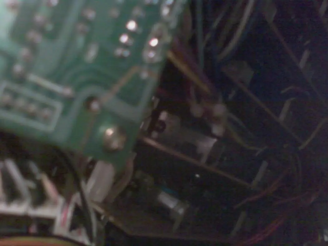

the pictures are of the bottom of the monitor B pcb.
sorry the pictures are low quality. I think I had traced the wrong cables the first time around...ridiculous that I didn't notice it, still.......suck. A little surprised/glad this is the only issue caused by this...but......dang.

Ahhh. That is actually good in my book because now you know what the problem is! Okay...
  • Is that the Monitor B PCB in the pics?
  • Important: look close...are there other damaged PCB's? Can you tell how it happened?
  • onesong, how good are you with a soldering iron? That looks to me like a fairly doable repair job depending on your skills. I can kind of walk you through it if you like but it basically involves scraping the green coating off the PCB to expose the copper trace and bridging the affected areas with soldered in material like tails trimmed off of resistors or capacitors. Check out this post for sort of a pictographic tutorial on what I'm talking about. You could epoxy the board back together and then bridge all the cracks. The other option would be to just remove that chunk and bridge across the gap left by the missing chunk. If it was me though I'd be gluing the chunk in since it has a mounting screw in it. If this idea is beyond your skill set you could consider removing the board and sending it to me and I can do the repair. PM me on that if you'd like.
1. yes
2. no. there's a little piece of metal the kind of hooks into a hole in the pcb, it looks like when whoever screwed the pcb down last, they did not line that up with the hole, so when they tightened the screw it broke the pcb.
3. I'm pretty comfortable with a soldering iron. Not the cleanest or 100% accurate, but I've done a fair amount. What is the scrap cap you used in the tutorial? I feel like, looking at that, I'd be able to do it no problem. I just would need to be careful to not solder the wrong traces together. I guess once I know what to use to bridge the gap with, I'll get right on it!
-again, thanks so very much for all your help.
Sheesh...that's irritating (the probable cause of the broken PCB), but, again, is good news in a way since it appears that it wasn't trauma to the whole mixer. With a better picture I bet we could explain what's going on with your SOLO problem too, but bottom line once you get that PCB repaired your issues might be gone. ;)
Okay. I was referring to cap(acitor) tails since that's what I've had the most of laying around...I'm just talking about the excess leads from a resistor or cap when you're putting new ones in...they're much longer than needed when new and you solder them in and then trim off the extra giving you a short piece of wire...any short piece of solid core wire will work. Just something to reinforce the bridge...you could get some smaller guage solid core copper wire or whatever.
Just make sure you keep the tip of the iron clean as you go (wiping on a piece of damp cloth or sponge) and clean the surface of the area on which you are going to work on the PCB with iso alcohol. Really helps the solder to take, and you could even tin the newly exposed bits of trace with solder. If you're relatively comfortable handling an iron I suspect you'll be just fine. Its kind of fun even. :)
Anyway, best wishes, let us know if you have any questions before or after the repair, and please keep us posted.

IT WORKED!
So stoked....just finished all the soldering, wired it all up and closed it....hooked up an ipod through th tape inputs on channel 1 and 2 and routed them to the Busses then the Monitor section ...BOTH CHANNELS!!! I double checked every little detail and everything works exactly as advertised!
SweetBeats, Thank you SO much for your help. Seriously, you're a lifesaver and my hero.

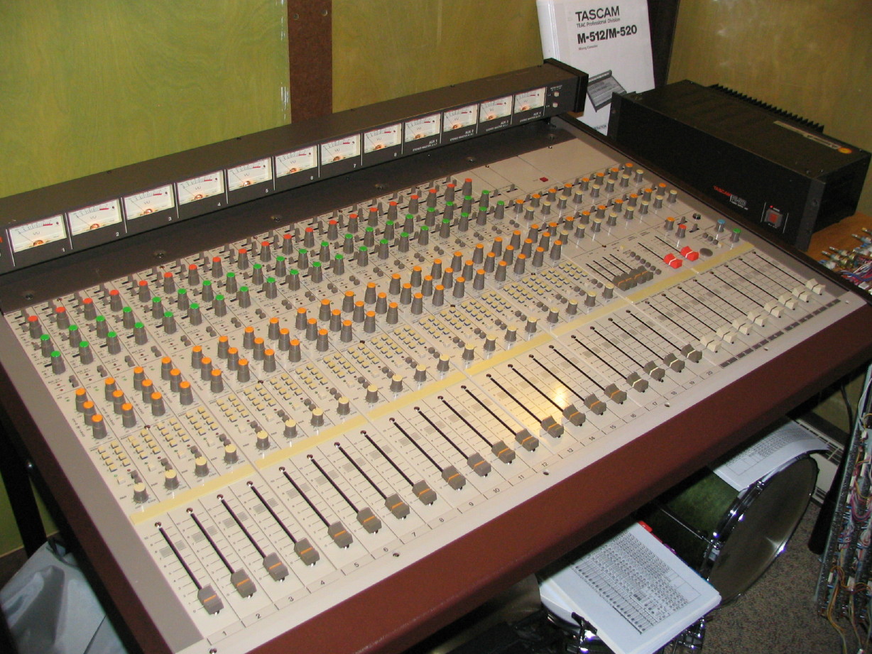

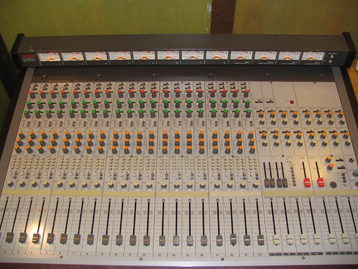

I'm finally done going through my M-520.
Every channel has been pulled, contacts, pots, and switches strategically cleaned, PCB and components visually and functionally tested.
Cosmetically it has been detailed. You've seen the pics. This is a beautiful mixer save for a few scratches on the top of the meter bridge.
It is 100% complete (right down to the SEND/RCV jumpers), and everything functions as it should (caveat: I have not tested the RIAA phono amp...I have no turntable) right down to every pot switch and lamp.
I'm including the high-quality custom cover made by LeCover which is practically brand new, the original operations and service manual (in non-original binder) and a spare incomplete channel card. Of course the PS-520 power supply and power umbilical cable are included, and the PS-520 has been recapped with high-quality Nichicon 105-degree caps.
