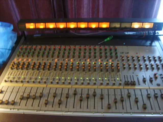

Two days further --> booked some results:
I went to the store and bought isopropanol spray. The store I buy my gear normally from told me this is the safest way to clean pots (no residue, pure alcohol based).
I started with the first four channels, and immediately ran into troubles:
2 fornplate screws don't have a cross profile anymore. I am not able to unscrew it. If anyone has suggestions how to remove such screws I would be glad.
Anyways I turned the module as in the Sweebeats video and sprayed the isopropanol into the pot openings and turning like a mad cow.
Dissmanteld the faders and cleaned them with alcohol (no crackles anymore). The faders are not ALPS but a far more cheaper kind.
The switches I did from the upside although not advised I have no other oppurtunity because of the screws. There are still crackles when switching but it doesn't bother me. Soloing and all that is done ITB.
Let it dry up and checked for sound: Very little crackles now on the EQ and pan. Still there are some in the Trim.
I also replaced the first to VU bulbs with Amber Leds. The result looks really nice but it is to less light to properly read and in bright lit environment the efect is nihil. So I will check out for ultrabright Amber leds.
Here is how I did it for people who want to do it as well. Unscrew the VU bar.
(only top screws and back screws). Unscrew the VU PCB and disconnect it.
In case of a 2.5 V led 20ma, solder a 330 ohm resistor at the - leg (normally the short leg). Pull the tube out the older. Solder the resistor side to the Left side of the holder and the other leg of the resistor to the right side of the holder. Et voila led powered VU's.
I also got the groups working now. Probably after the cleaning of the switches that it works now.
The noisefloor is actually quite low indeed. The noise I was hearing was... my MS-10 :). Never realised it was so noisy.
Very satisfied untill now. Can live with some minor crackles. The sound is now steady no volume fluctuations anymore.
One led was to subtle so I removed the resistor and added two leds (7.5 V total so this will work for a while).
The result is very satisfiing. On the image the right outer VU's are bulbs the rest leds. The leds have a warmer tone on them.
I also checked the stereo outs:works!
Everything works so far.
Still have problems with On switch off channel two. The fluctuating leds have everything to do with the switch contact because for all other switches I cleaned the leds do'nt fluctuate anymore (couldn't clean the leds itself because of the frontplate issue).
Here the result of the VU bar:
