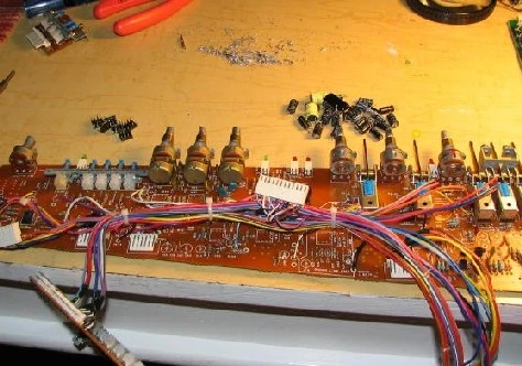

I'm working up an Excel spreadsheet to log every capacitor. That way I'll be able to manipulate the data to get different lists by single or groups of PCB's to get lists of capacitors as time and budget allow for recapping.

I'm practicing for de-capping channel cards...took one of my spares and pulled the caps off of it as well as 6 out of the 7 opamps. Went fine, but the traces partially pulled off of about 3 or 4 of the solder pads...I was really careful...its almost like the wafer board is dry or something...like the traces aren't bound well to it...brittle. Anyway, two of the damaged pads are for legs to one of the IC's...so that will be fun to try and figure out...
Nothing better to do so here is a picture of an M-520 Input Amplifier PCB Assembly (E) with no caps and only 1 out of 7 IC's installed.

That is a phenolic board. It is basically paper and phenolic resin. The copper does not stick as well as you noticed. The boards in your 58's channel cards are glass-epoxy. Much better boards.
--Ethan
Huh!
That makes sense...I was actually starting to wonder about that as I'd noticed a difference in the board material. You've explained it well. So, the bottom-line is that on any phenolic board, beeeee careful.

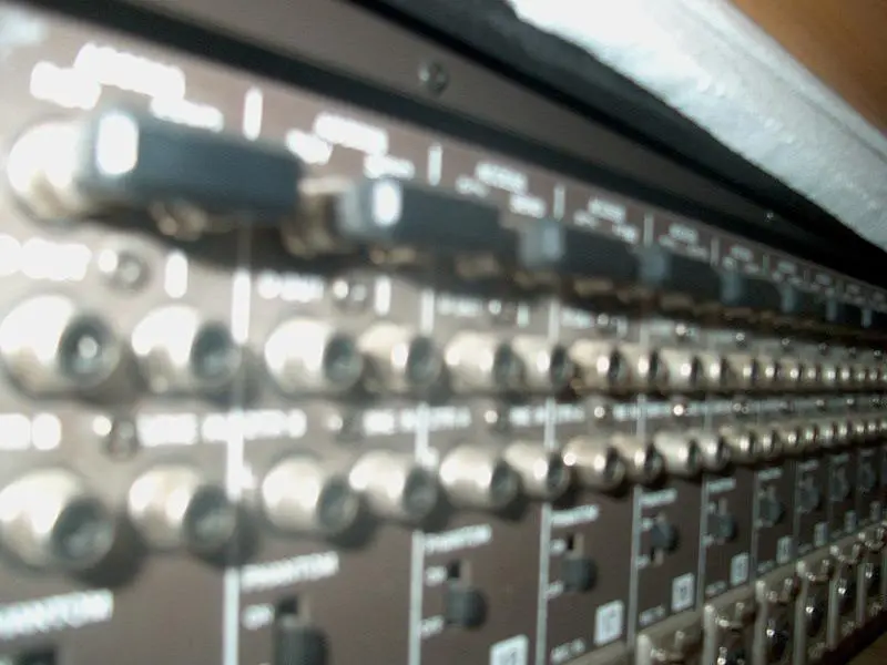

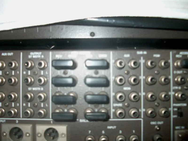

Make sure there are jumper plugs installed on each of the (20) channels and each of the (8) Pgm Buss Access Snd/Rcv patch points.
