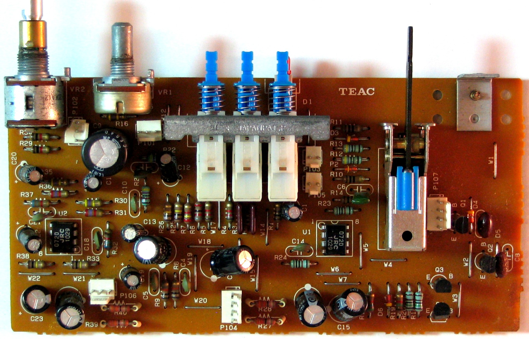

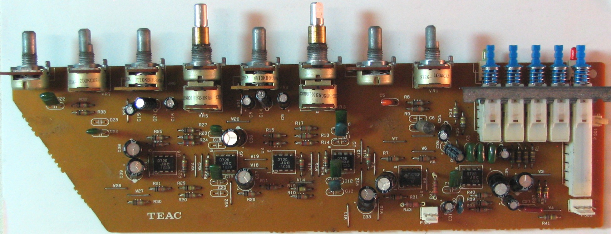

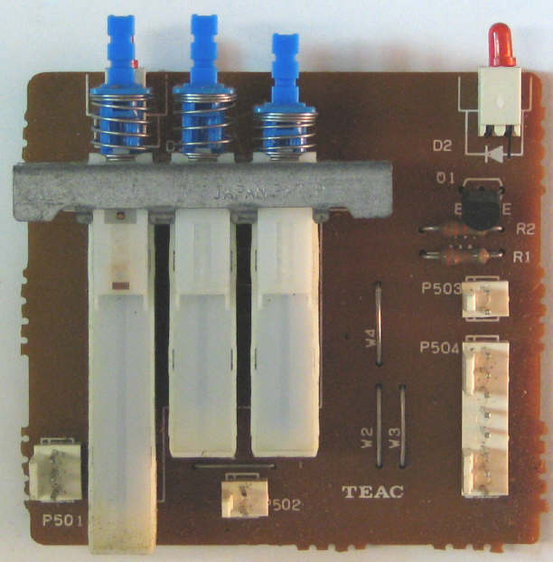

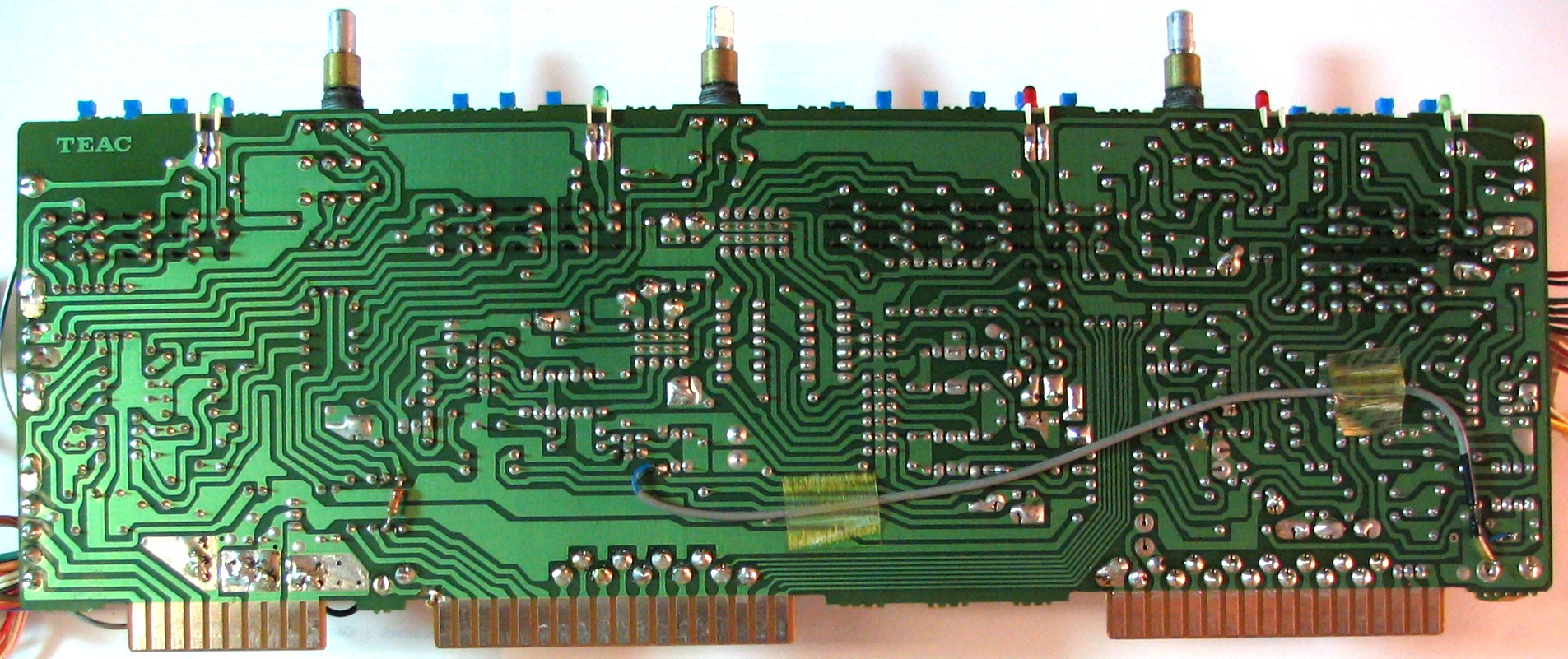

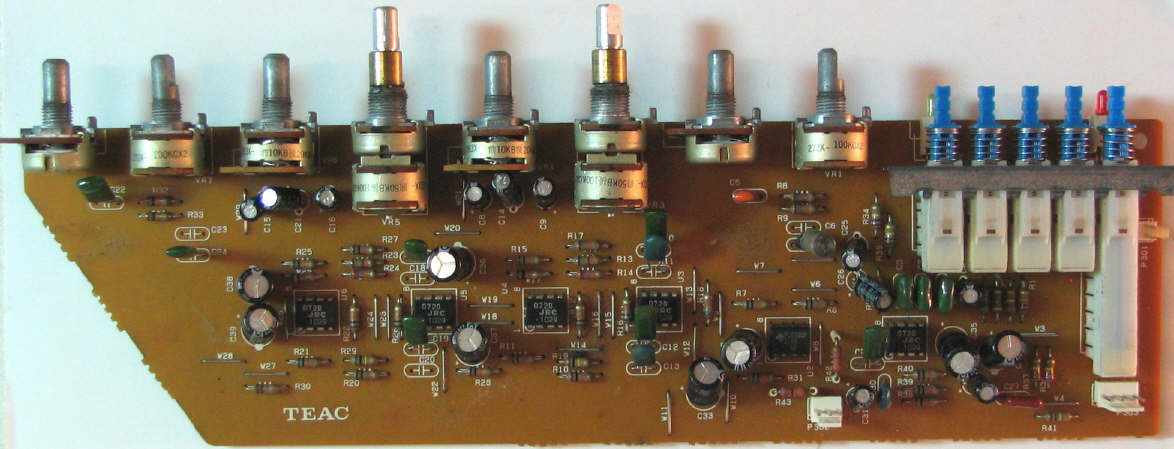

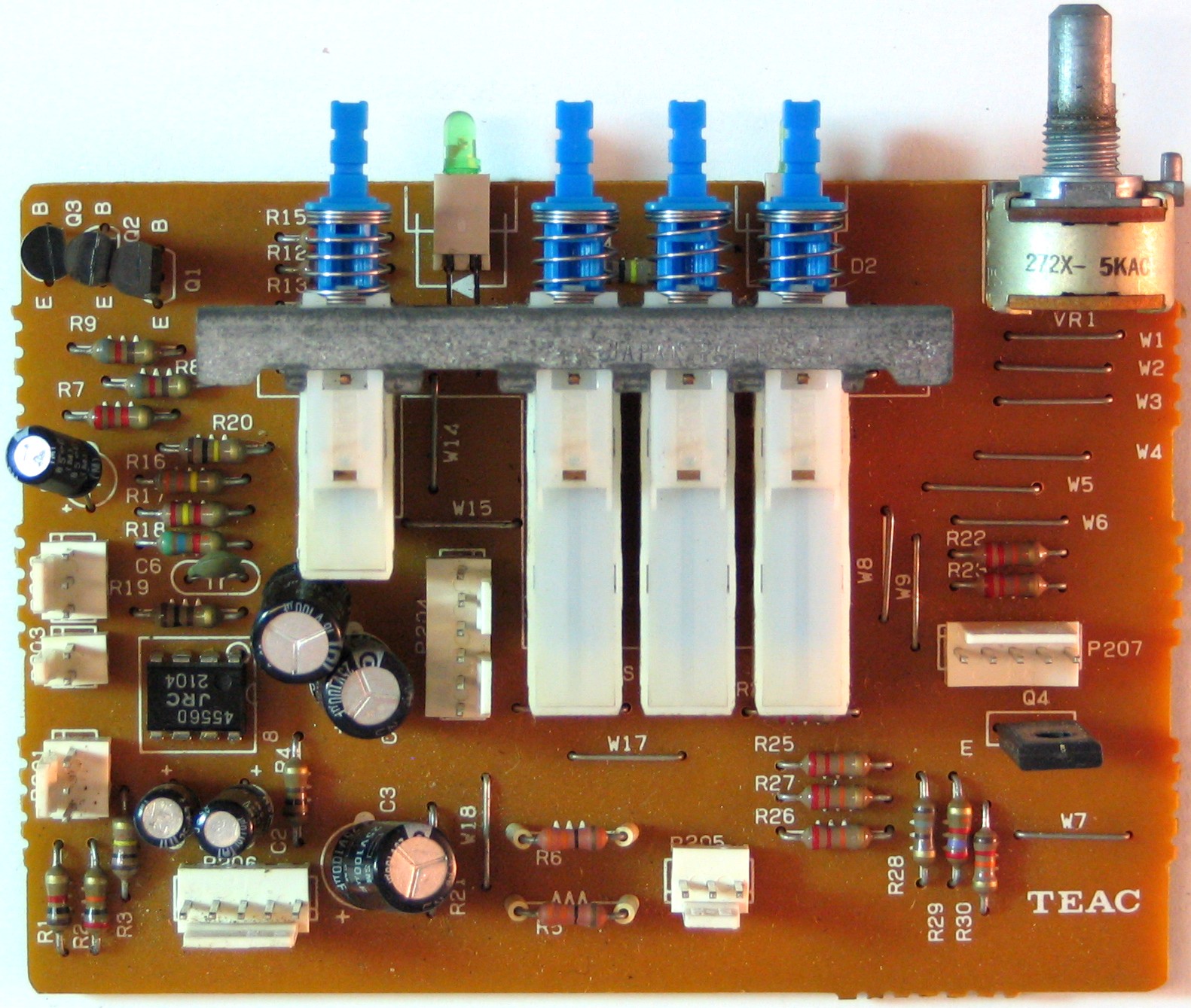

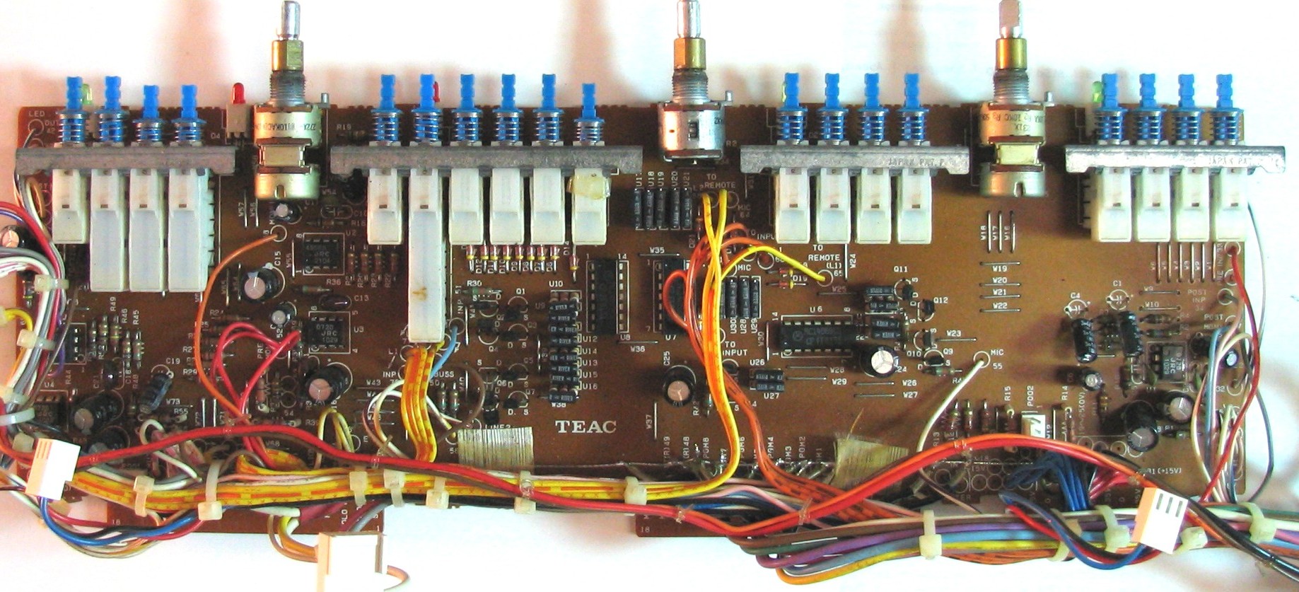

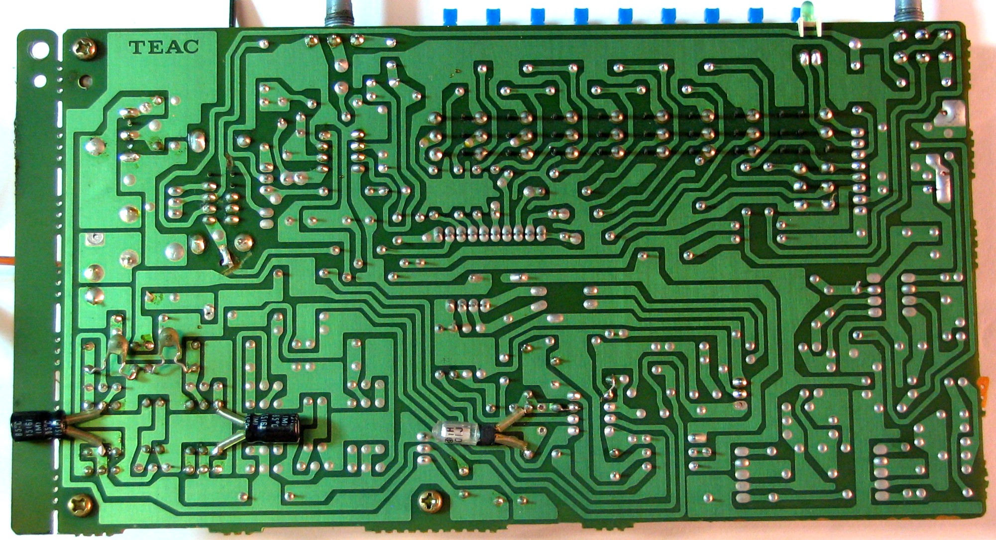

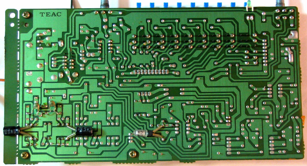

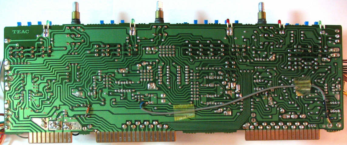

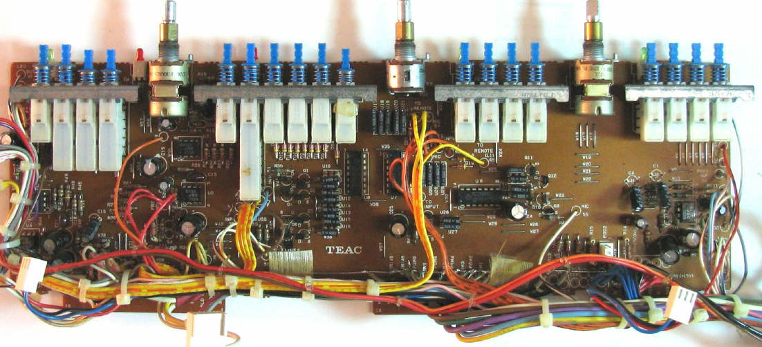

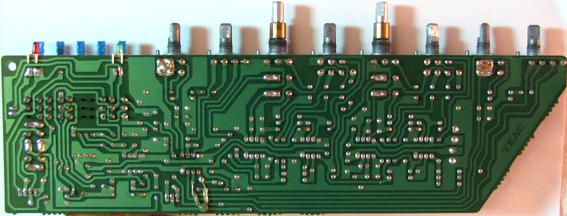

Here Come The PCB's...
{cakewalk, thanks for the encouragement!} :)
Remember: I'm arbitrarily naming these PCB's based solely on the controls that are mounted on them.
INPUT PCB, full-size versions here and here
PGM PCB, full-size versions here and here Lookit how many open locations there are on this PCB...there were plans for other stuff methinks...:confused:

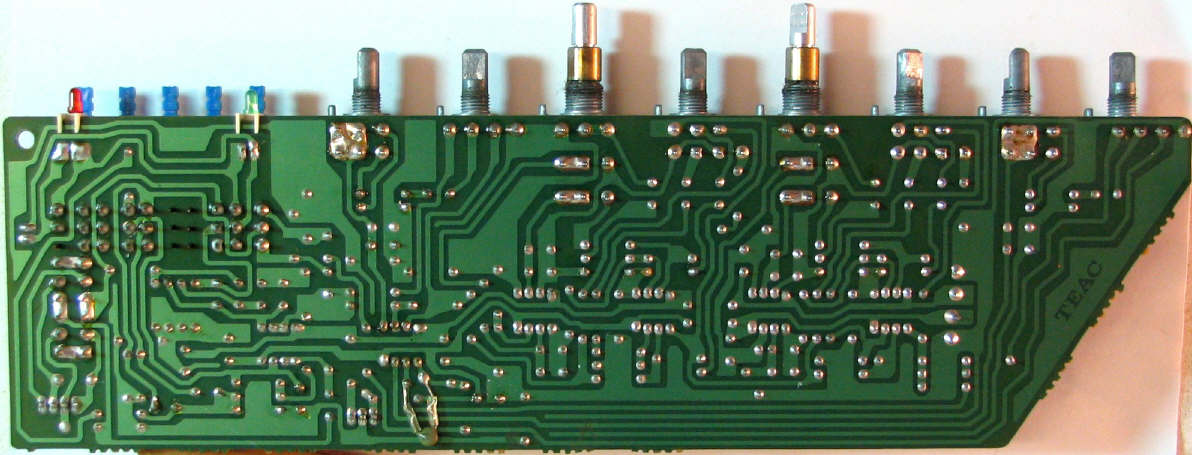

EQ PCB, full-size versions here and here

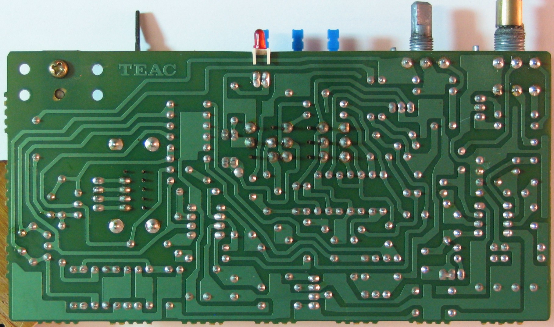

AUX/MONITOR PCB, full-size versions here and here

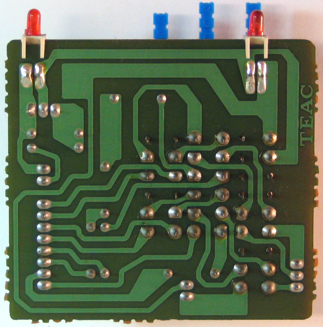

MUTE/SOLO PCB, full-size versions here and here

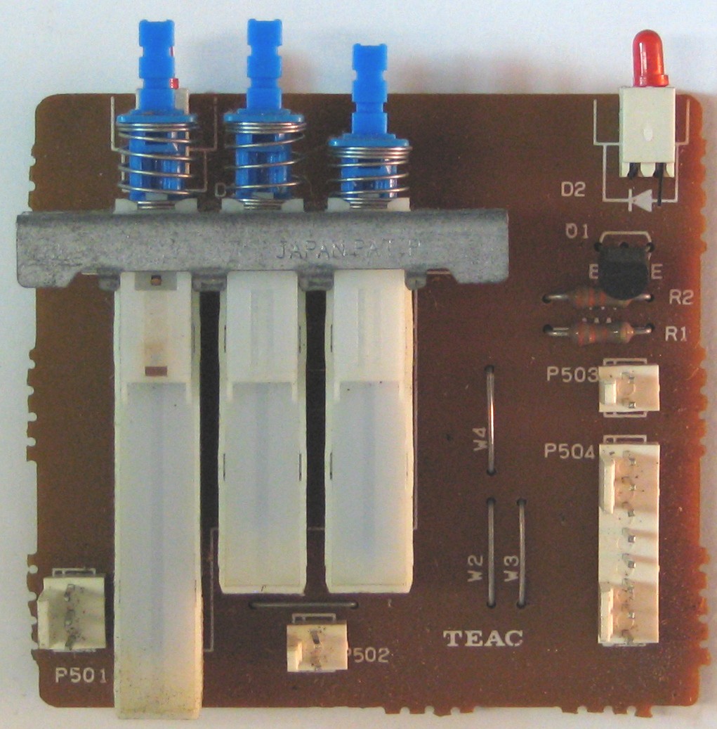

REMOTE PCB, full-size versions here and here

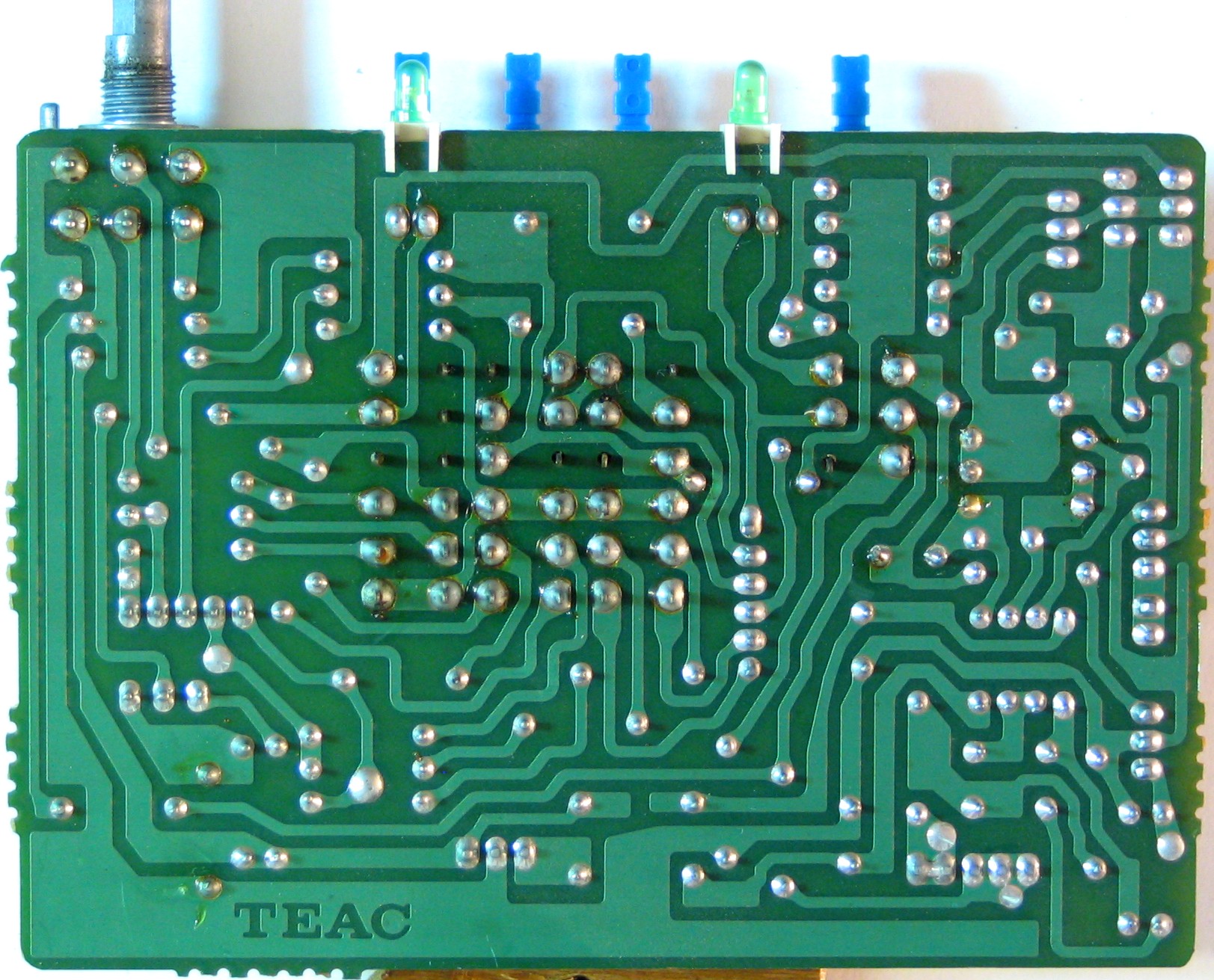

VU Meters...
So I mentioned a few posts back that the VU meter PCB looked very familiar with respect to my handling of the M-520 VU meters...I had hoped they were the same and then it would be safe to assume that the meter bulbs run off of an 11VAC rail like the M-520, and that information would put another puzzle piece in place with respect to building up a power supply for this mixer.
Well, they aren't the same, but much of the componentry is the same...lots of similarities, and the meters themselves are identical. I can't get to the backside of my M-520 meter bridge very well at the moment...would somebody be willing to pull the back cover off of their M-512/520 to tip a pair of meters out to see if the M-500 METER AMPL PCB is labeled "METER PCB-121" like this one here out of the M-___ mixer?
Here is the trace side of the PCB by the way...

I'm starting to try to map the PCB's out. I'm starting with the basics, the Mother PCB.
A couple answers so far:
  • It appears that the BUSS MASTER pots on channels 1 ~ 8 do indeed source the respective PGM ASSIGN's for channels 1 ~ 12 (i.e. if you assign channel 12 to PGM 1, it will be controlled by the BUSS MASTER pot on channel 1), and those in turn feed the BUSS OUT jacks on those same channels (i.e. BUSS MASTER for PGM 1 on channel 1 feeds the BUSS OUT jack on channel 1, PGM 2 pot on channel 2 feeds the BUSS OUT jack on channel 2, etc.)
  • The BUSS MASTER pots on channels 9 ~ 12 do indeed serve as the master controls for AUXes 1 ~ 4 :), and the corresponding BUSS OUT jacks on channels 9 ~ 12 output AUXes 1 ~ 4 (in fact the jack PCB's are labeled BUSS (AUX) OUT for the BUSS OUT jack). Phew!
  • The REMOTE switchracks on channels 1 ~ 12 (the switches by the channel faders) do source the GROUP A & B switchracks in the master section. Not sure yet about the nature of the source of the switchracks in the master section, but the REMOTE switches on the channel strips go there.
  • The MONITOR switchrack in the master section is connected to the channel strips in the same way as the GROUP A & B switchracks on the mother PCB. Not yet sure how the channels access that section of the master module, but, with the GROUP A & B/REMOTE feature (and all the other stuff), this mixer has some pretty flexible and powerful routing ability.
  • Channel strips and master section are chock full of TL072 IC's, I see some 4556's in there too, and a couple "MC14069UB" Motorola chips on each channel strip...dunno anything about those yet.
Fun stuff!
4069's are logic chips... 6 cmos inverters per package... these would mostlikely be used in some kinda group muting or similar function... ie. when a solo is hit it's signal would go high... and the 4069 would output a low... thus muting whatever... make sense???
Cool-cool-cool...thanks demented! ;):cool::)
That makes sense...especially it being a Motorola chip. I'll take a closer look at the traces.

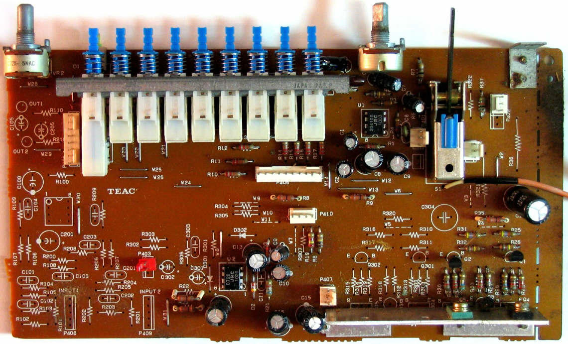

Those chips are on the "AUX/MONITOR PCB", but I could have/should have monikered that board as the main channel board since it has all the I/O contacts on it and all the wiring is soldered to it, whereas they are almost exclusively on connectors on all the other boards on the channel...it is like the channel mother PCB...I bet when I look at it the connections from the MUTE/SOLO sections make their way to those chips.

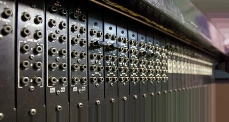

Model 15 similarities...
Check out a pic of the back of a model 15 mixer...comments about the M-___'s similarities with the 15 are evident here for sure...sorry, the picture is kinda funky. It was a .png that I down-converted to a .jpg and lost the transparency, but I'm looking at the back of the channel strips. Identical in form and mounting to the M-___.

Most of the IC chips seem to be JRC (Japan Radio Company), but one of them on the EQ pcb looks to be a Texas Instruments TL072CP Op Amp.
The date code on the chip should be in the format (YR/WK)
with the first two digits being the last two digits of the year of mfg and the last two digits being the week of the year. Unless it was replaced (unlikely), then the board could not have been produced earlier than that date, and given chip revisions and inventory turnover, probably not more than a year or two AFTER that date. At least you can narron in on WHEN this beast was built.
