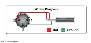

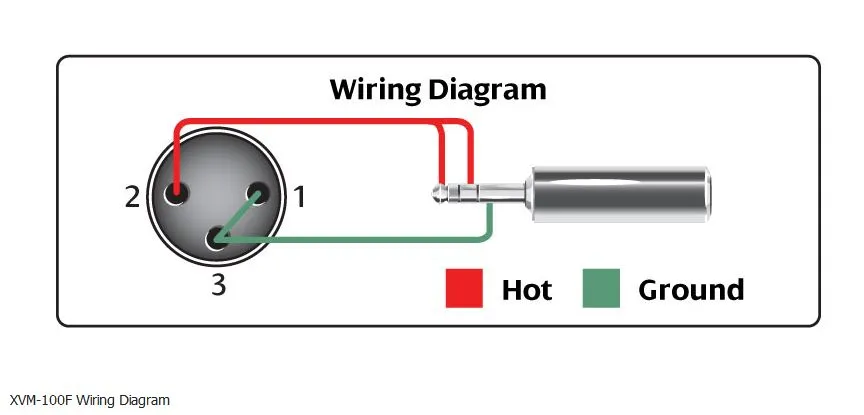

The XLR to stereo mini jack is likely sending a "balanced" signal to the DR-05's left and right channel. The DR-05's stereo input sums this balanced input which are equally (+) and (-) and the result is zero, they cancel each other out, thus no audio. When you pull the plug part way out it evidently catches the TRS ring and tip to allow the input to work on one channel.
I use a cable that takes the balanced signal and wires it to be unbalanced. The XLR pins 1(Gnd) & 3(low signal side) are tied together to ground and go to the sleeve on the TRS and the pin 2(high signal side) is connected to the tip and ring of the TRS. The mono signal goes to the left and right equally.
I believe I got the cable from Amazon > https://www.amazon.com/Hosa-XVM-110F-XLR3F-Right-Angle-Microphone/dp/B004NCUIUS
