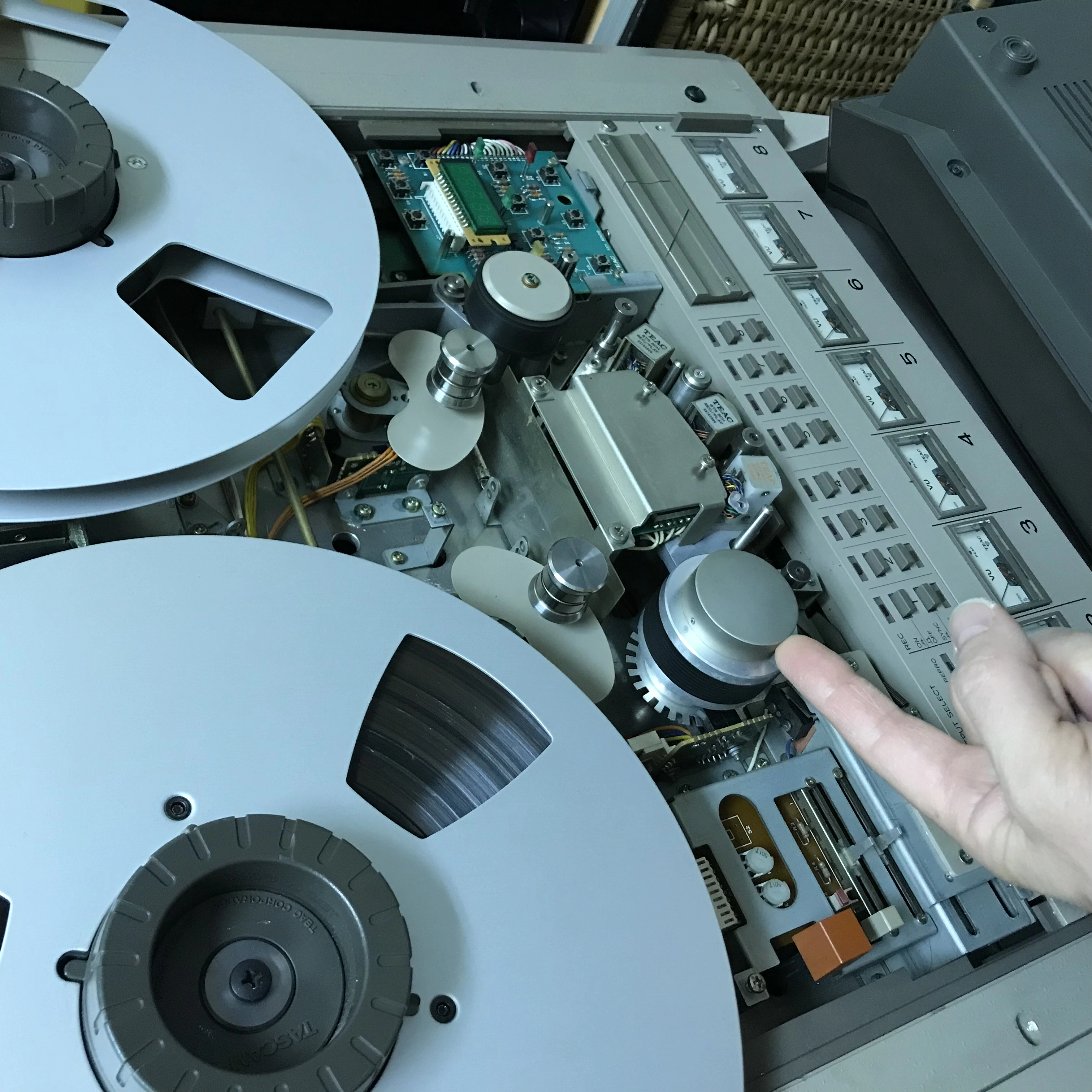

@tremichael the 58, when originally introduced, was unbalanced -10dBv only. It was just the “Tascam 58”. I have one of those early versions. The manual is different than the second generation machines. A key telltale sign of an early machine is the scrub wheel has no finger detent in it…this thing:

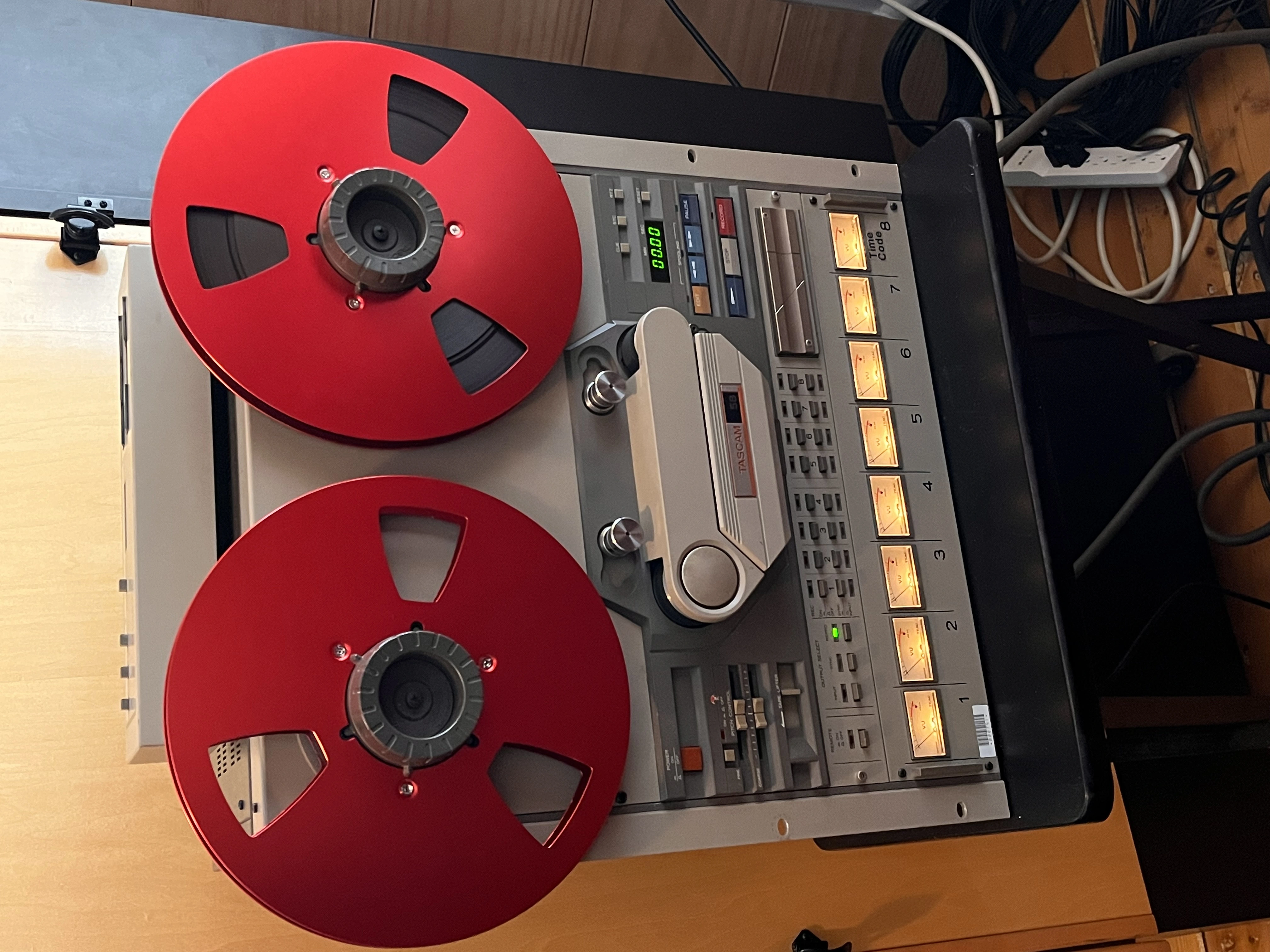

As a treat, here's my machine !
Nice lookin’ 58! And I see you have the rare RC-50 transport remote too. Nice! And yes I do believe you have there the more rare 1st gen 58…pre-“OU/OB” delineation. You can also tell by removing the top panel…early generation 58s have a heatsink that spans all the way across the top above the reeling motors and main power transformer…2nd gen 58s have smaller heatsinks just over each reeling motor. Again, the easy-to-see giveaway is the scrub dial without the dimple for your finger. Did you get the manual with it?
