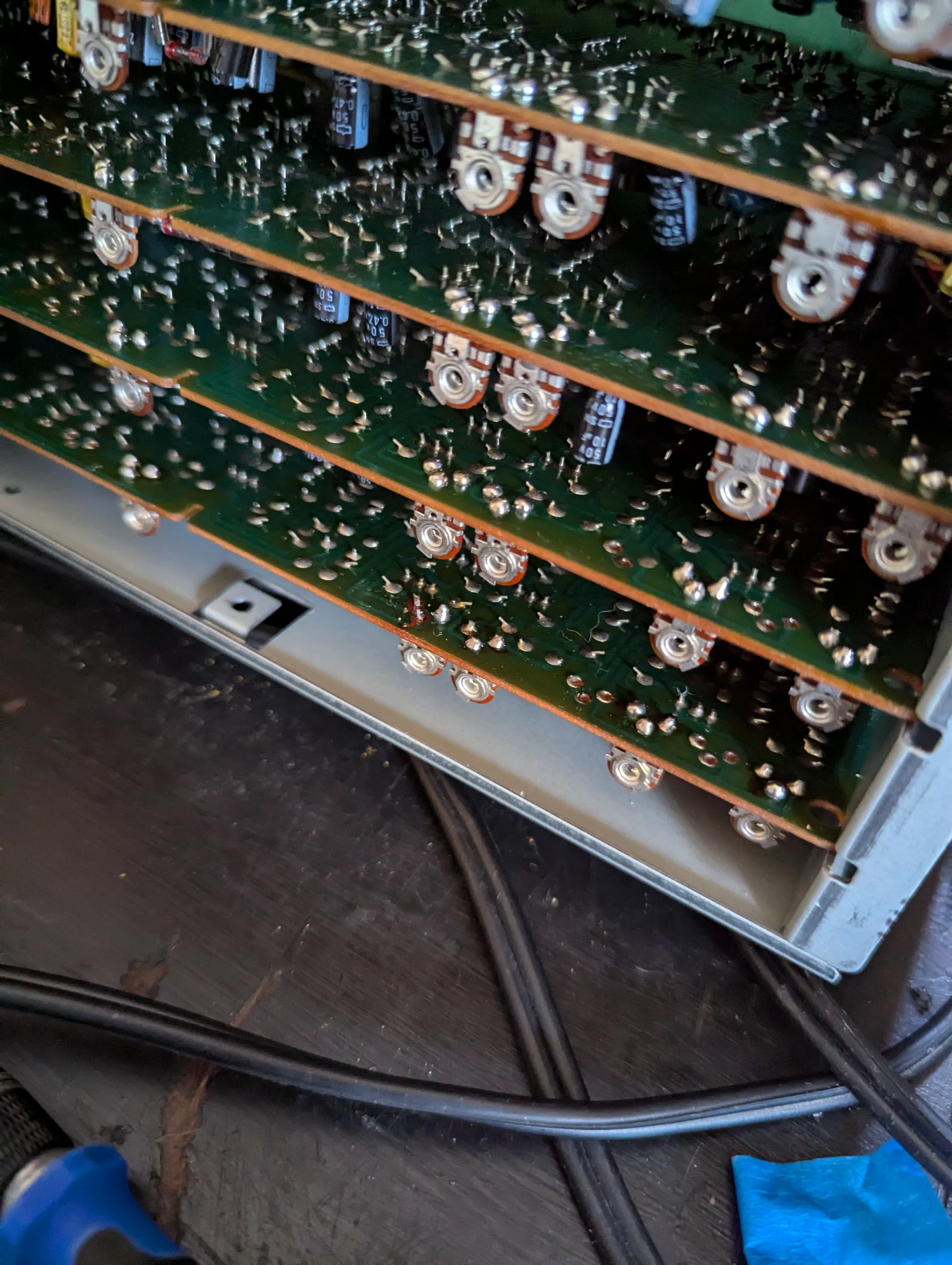

I started with the reseating/deoxit the R+P boards since it was the least invasive job. This is where I discovered the source of the problem. Channel 2 VU meter wasn't working so I sprayed deoxit in the adjustment pots (R141) and started to fiddle with it. It would jump whenever pressure was applied to the pot with my thumb. I decided to try the same thing on a channel card that had bad sync & repro (R122 & R120) playback. It worked! the sound would cut in and out when pressure was applied. If I put enough pressure the channel would stay on.
So this is where I'm at now. I think either the pot or the connections have gone bad. I reflowed every circuit joint that had that style of pot on it. I figured it probably happening to all of them. It partially fixed the problem. It's easier to find the spot where they don't cut the audio signal when applying pressure. I can set them there but it seems like a temporary fix.

I think the joint themselves on the board are bad and I'm worried that if I keep messing with them it's gonna eventually break the circuit. I desoldered one of them just to take a look. The solder joint ring and some of the circuit freyed.
Im not too acquainted with this symptom. Either the flux eroded the joint, bad oxidation, the old solder tore up joint, or I did. Attached a pic of the bad pot connection. Channel 8 bottom 4th from the left.

Those trimmers will out-last any other potentiometer on that machine. They are not the problem.
I recommend you find some scrap PCBs to use for practice with your soldering.
What type of iron do you have? What type of solder are you using, composition and diameter wire? What are the specs on your solder tip, type and size?
You’re applying too much solder, too much heat, and I suspect your tip is too big. You have to be careful with phenolic resin PCBs. You have to be careful with everything, but particularly those types of boards. Too much heat or for too long and the trace delaminates from the board and can become fragile and break off. You fried it. When you reflow solder joints you maybe add some solder, and if so just a little bit. You’re adding 4x or more solder than the factory joint. Who knows…maybe somebody shoved on the trimmers too much and cracked a solder joint or trace, but you have to assess that and then pick the right fix. If it’s a broken trace you have to remove a little bit of mask from the trace on both sides of the crack and then bridge the crack with jumper wire and solder it in. But I would not suspect bad trimmer resistors themselves. Cold solder joints, maybe, bad relays probably…but let’s figure out your equipment and supplies first and you should do some practicing to minimize the amount of time heat is applied.

Soldering is definitely not my fortay. Mostly PCB proto board for Arduino projects. First time reflowing on an old board. That trim pot I took out and I definitely overheated when desoldering. Ill be doing some practice runs before I tackle the motherboard.
I got them all working besides the fried channel 8 trimmer. When I say them I mean the three trim pots that were causing issues on each board. VU, sync, and repro gain adjustments. They're just delicate. If they get bumped they can cut out.
I agree that it's not the pots themselves but most likely the joint and trace connections. Thanks for the input, I'm kinda in the grey when it comes to points of failure. I'll take a deeper look for making any more modifications.

If you still have signal cutting in and out if you bump the trimmers, there may be damaged traces.

I read the manual. So the tip temp is fixed at about 900 degrees. That’s too hot IMO. So, again, if you’re going to continue using that iron, you’ll have to work quickly. Where do you set the power knob? That controls the wattage. If it was me I’d make sure I had a right-sized tip (like maybe something around 1/16”?), and I’d set the power control to maybe 2 to 2.5.
For bridging broken traces I like to use trimmings from electronic components. Like when I recap something, for instance, and trim the tails of the new cap after soldering it in, I like to save some of those trimmings for repairs…basically it’s just small gauge tinned solid core wire. For longer jumpers, like for really compromised traces or missing pads, I have a bunch of wire harnessing from dead devices…24AWG tinned stranded hookup wire. So any small gauge wire if you need to install a point-to-point jumper for something that’s really messed up. I hope that’s helpful in some way.
