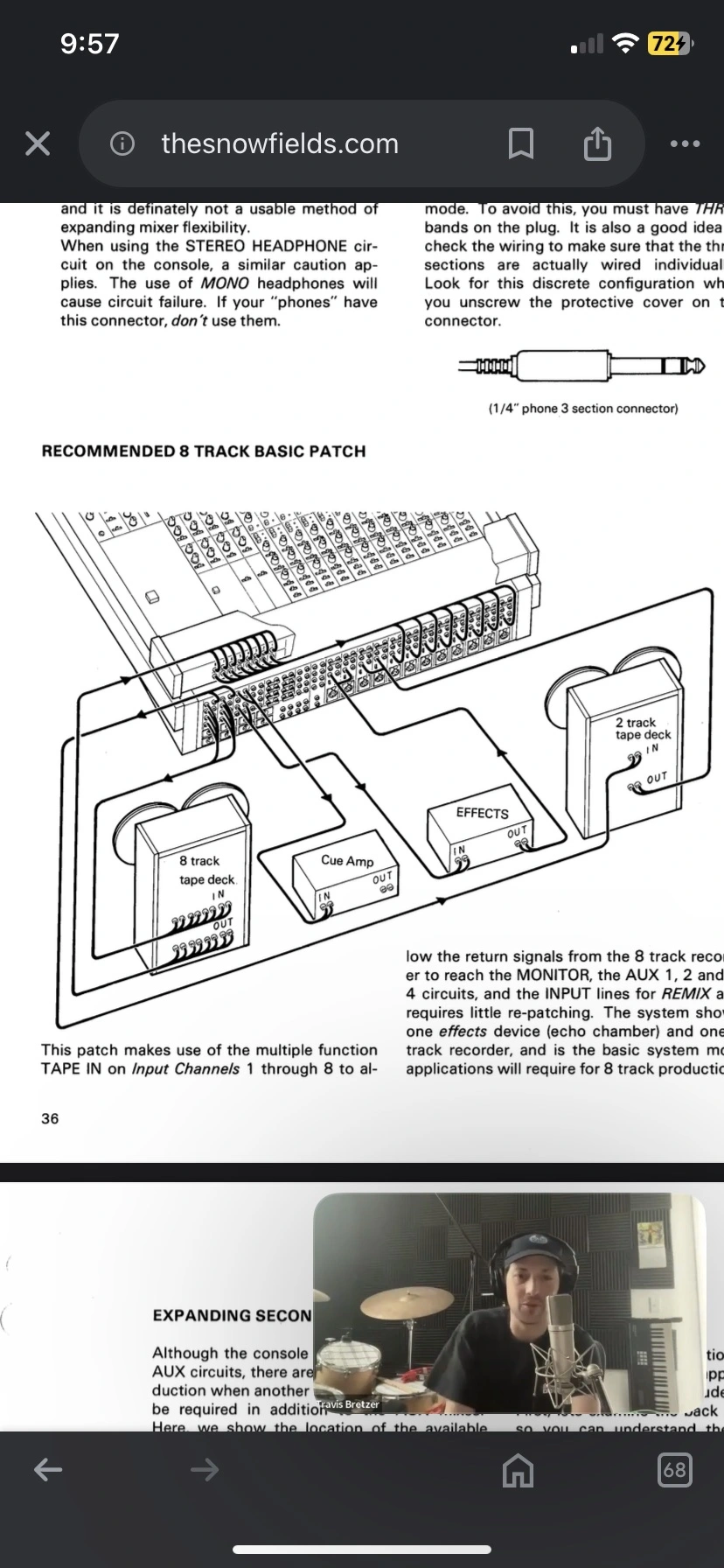

i’m also using a samson patchbay, and i’ve tried the normal, half normal, and “middle” positions and it hasn’t effected sound. here’s a diagram of my patching scheme, as layed out in the m512 user manual. i’m only referring to the patching between the 8 track and the mixer, not the 2 track or other devices.
though, if someone could tell me how/where to connect an interface to digitize a final stereo mix, that would be appreciated.

as i’m reading the user manual for the m512, the patching scheme that i lifted from the manual makes it seem like there’s some extra patching adjustment or device needed to “remix” in this patching scheme. does that mean that i’m set up to track instead of listen back to the tape deck in that configuration? oh boy, i was excited about getting a big ol console with knobs galore but if only i properly knew how to patch the way i want.

I don’t know how you have your 38 inputs connected…if it was me, and what was intended, is the 8 PGM group outputs connect to the 8 tape machine inputs, and then of course the tape machine outputs connect to the channel 1-8 TAPE inputs.
The STEREO A/B outputs are actually intended or are setup to be your CONTROL ROOM and STUDIO feeds respectively…that’s how they’re setup, but they labeled them “STEREO” I think just to promote flexibility. But STEREO A connects to your control room monitor speakers and then STEREO B goes to the speakers in the recording room…STEREO B carries talkback faculties so you can communicate with the talent. So then to your question about how best to feed your 2-channel computer audio interface…I think some people use the STEREO A output to do that and that’s perfectly fine, but notice there are actually two output jacks for each PGM group. So I’d have one set 1-8 going to the 38 inputs, and I’d use 2 of the jacks from the second set (like PGM 1 & 2) and connect that to my master recorder (which in your case is your audio interface). Don’t get twisted up in “how does that work…how can I have PGM 1 & 2 outs connected to track 1 & 2 inputs on the 38 AND to my interface?” Process-wise you won’t be multitracking to the 38 and mastering to the computer at the same time. First you multitrack, and then you mix down and master. The advantage of using the PGM outputs vs the STEREO outputs is there’s a whole host of amplifier stages you eliminate by using the PGM outs. So it’s a cleaner and quieter access point for the signal. Using the PGM outs to feed your multitrack and master recorders is also great because every input channel can be routed to one or more PGM groups. Think of the groups as an infinitely variable and flexible internal patchbay and you patch using the assign switches and PAN controls on each input channel. And furthermore the M-500 series with its monitor mixer allows you to monitor those groups and create a submix that’s independent of you PGM mix. So that’s how I’d do it.

my bad once again. i think too narrowly about this stuff. and yes, i’m using the PGM outs to get the signal to the tape recorder. i do run the tape machine outs through the meter bridge upper rca connections (EXT IN), which then run an rca-to-rca snake from the meter bridge outs (FLB) to the TAPE IN sections.
