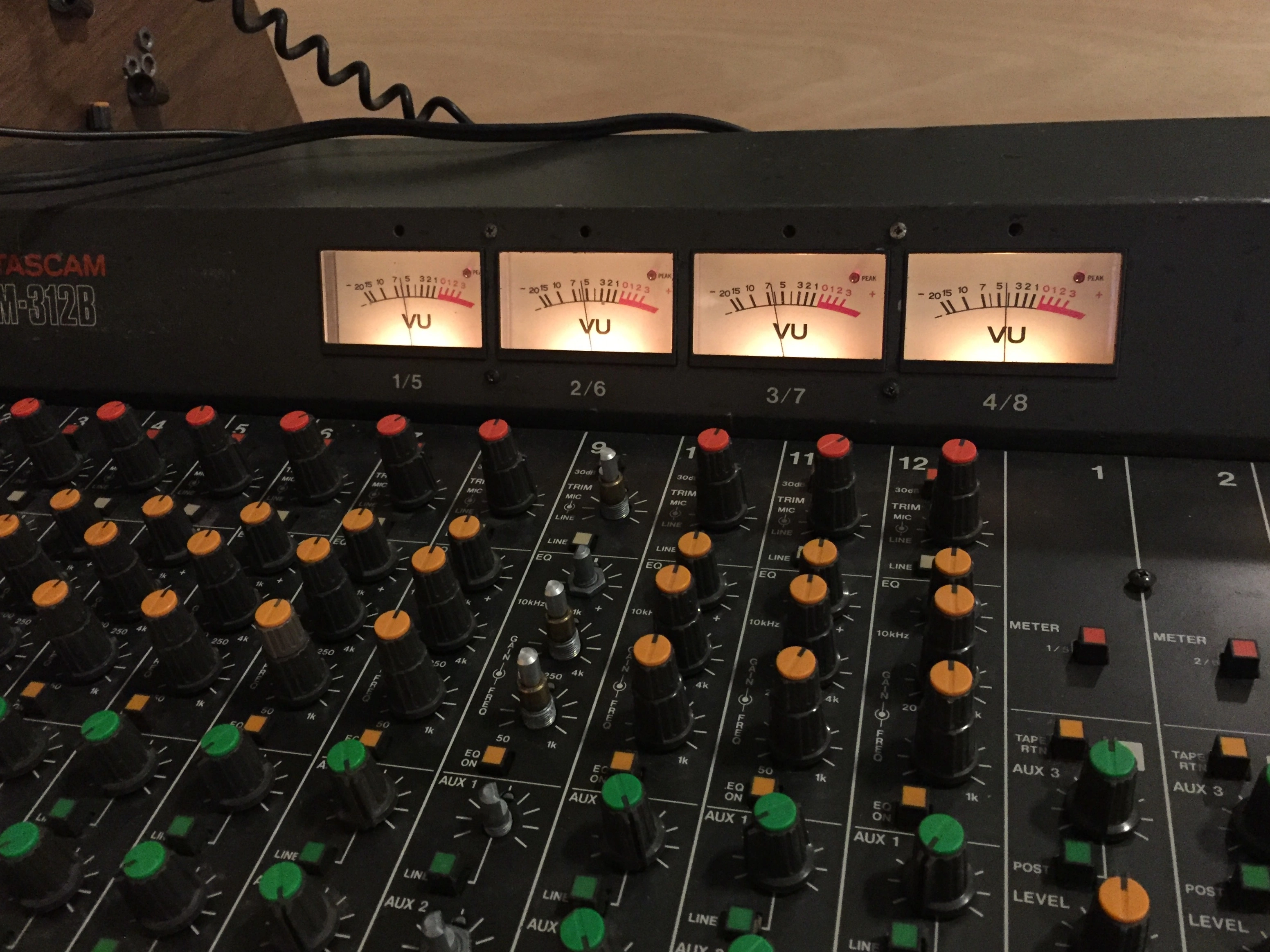

Yeah. I’m trying to figure out the meter problem. Let me know specifics when you replicate what you did last night, because in looking at the circuit, the only way the switch could source the opposite of the other buss PCBs is if the wires from the TAPE IN jacks (they go to terminals 4 & 6 on the BUSS PCB) were swapped. TAPE IN 4 should go to terminal 4, and TAPE IN jack 8 should go to terminal 6. The meter source switch just taps into the signal paths of the respective TAPE IN jacks.
channel 5 line in----> assign buttons 1,2,3,4 latched------> meter function switch 1/5,2/6,3/7 latched- meter function switch 4/8 unlatched -----> all meters function
channel 5 line in----> assign buttons 1,2,3,4 latched------> meter function switch 1,2,3,4 latched -----> meters 1/5,2/6,3/7 function. Meter 4/8 does not function

The Meter issue is resolved. As you probably figured out, it was user error. TAPE RTN 8 was latched. As soon as I unlatched that the meter worked as its supposed to.
It is interesting to me though looking at the block diagram, it looks like latching TAPE RTN 1,2,3, and 4 should have the same effect as latching TAPE RTN 5,6,7,and 8 but it doesn't.

AHHHHAAAAA!!!!! ----Because I am only sending the signal to program busses 1-4!!! (....I was typing out all this when it occured to me....)
I'm sorry to waste your time on this meter thing Cory, but believe it or not this is a mental milestone for me... :facepalm:

I think of it this way...the meters aren’t PGM GROUP meters or TAPE IN meters per se...they are the pre-level control *monitor mixer meters*. Each of those meters sources whatever is being sent to the respective monitor mixer level control. For instance for meter 1/5 when the meter source switch is latched, it is sourcing whatever is at the monitor mixer channel 1 level control...pre level not post level. If the TAPE RTN 1 switch is unlatched, then the meter is sourcing the PGM GROUP 1 post group fader sum. Latch the TAPE RTN 1 switch and now the source is the TAPE 1 jack. Same goes for when the meter 1/5 source switch is latched...still PGM GROUP 1 post group fader sum if the TAPE RTN 5 switch is unlatched, but match TAPE RTN 5 switch and the meter source is TAPE IN 5.
So consider thinking of it that way...the meter source select switch isn’t a shift switch for the TAPE IN jacks, it switches which monitor mixer channel the meter is sourcing (and remember it’s at the point just before the monitor mixer channel LEVEL control), unlatched or “up” it’s the upper row of monitor mixer channels...latched or “down” and it’s the lower row of monitor mixer channels.
The default source for each pair of monitor mixer channels is the PGM GROUP they line up with. But you can independently source a pair of TAPE IN jacks on each vertical pair of monitor mixer channels. On the M-312 and M-320 you also have those additional AUX busses, one on each monitor mixer channel row. And they are switchable PRE/POST monitor mixer channel LEVEL control. This is pretty powerful!
Another thing to note that I was maybe a little confused about earlier and hopefully didn’t add to any confusion is the TAPE IN jacks *always* connect to their associated TAPE RTN source switches in the monitor mixer...it doesn’t matter what’s plugged into LINE IN jacks 1-8. The LINE IN jack 1-8 normalling is a convenience so you can plug your tape outs to the mixer tape ins and have them automatically connected to BOTH your monitor mixer and the input strips for mixdown time or cue feeds during overdubs (using the AUX 1 LINE source switch, yah?), but be able to plug in outside line sources to the LINE IN jacks without having to unplug anything from the tape deck outs.
So for your setup as far as the meter sourcing, you’ve got the best of both worlds since you are using a 4-track...if you have your tape outs connected to TAPE IN jacks 1-4, then if it was me I’d always latch the TAPE RTN 1-4 switches, and now my meter source select switches when up monitor tape returns, and when down or latched monitor the PGM group’s post fade.

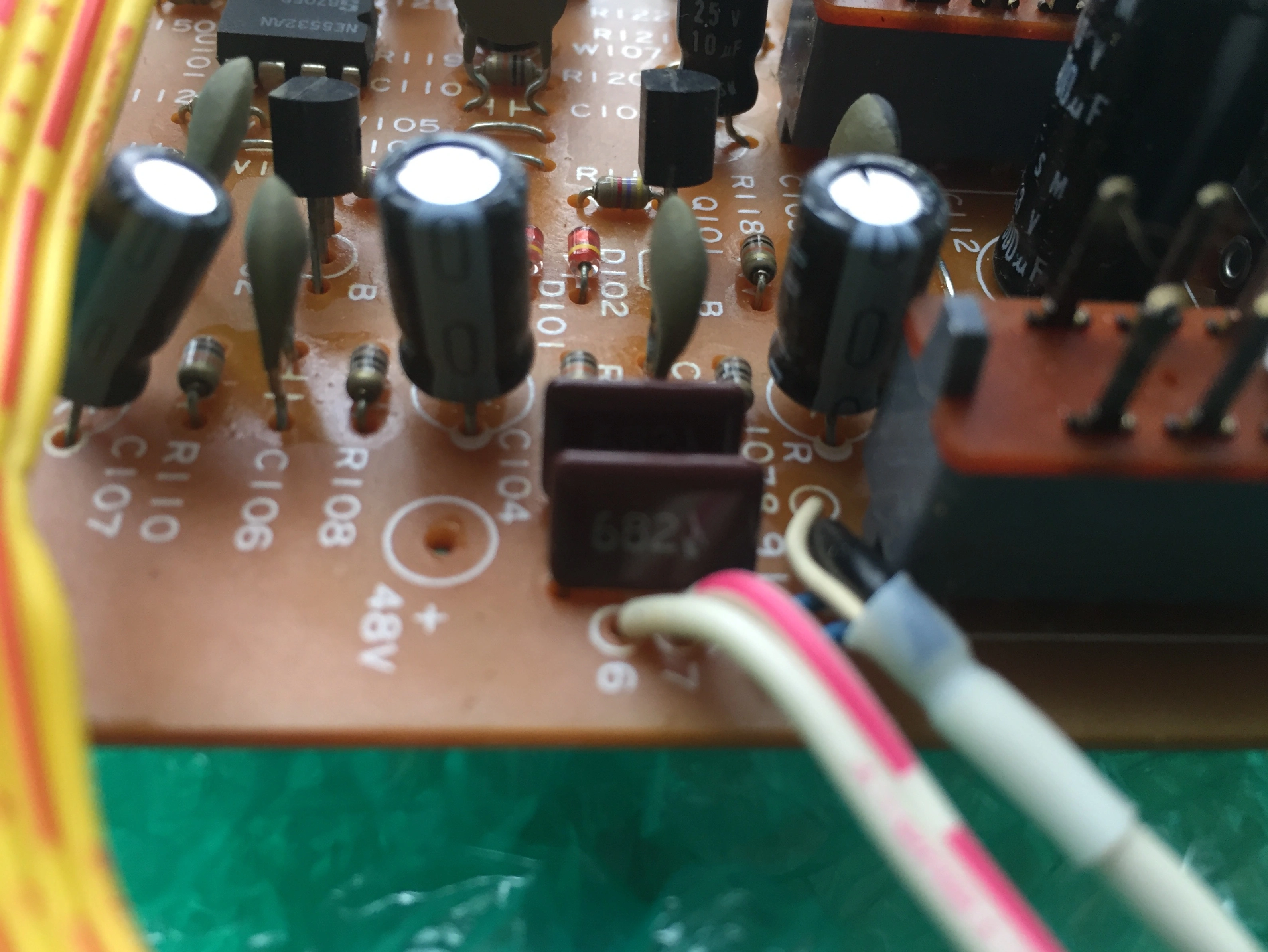

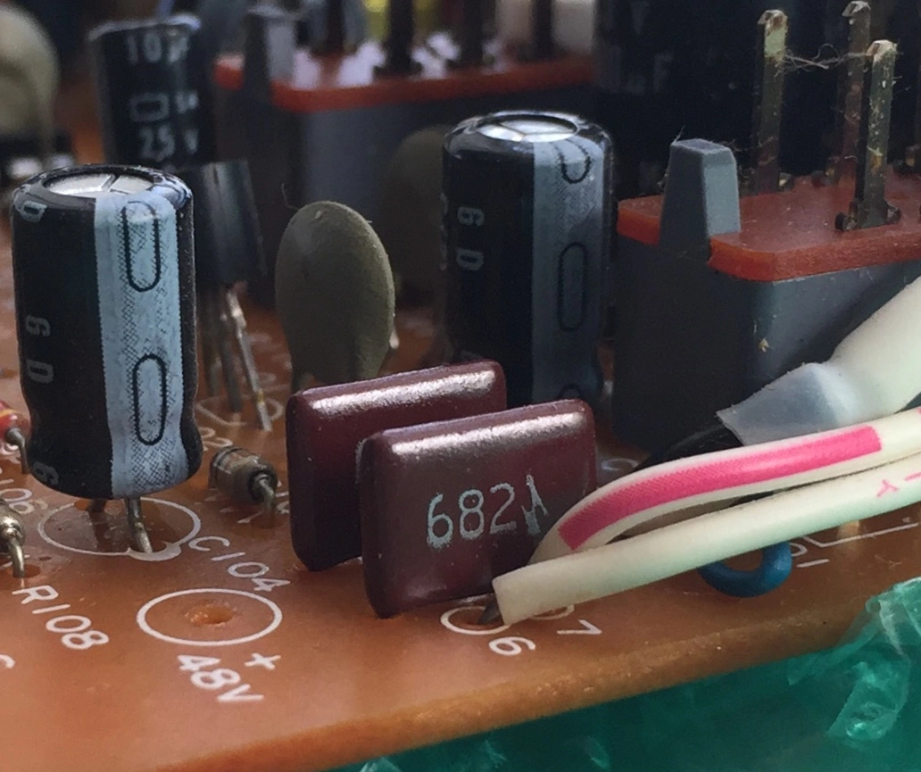

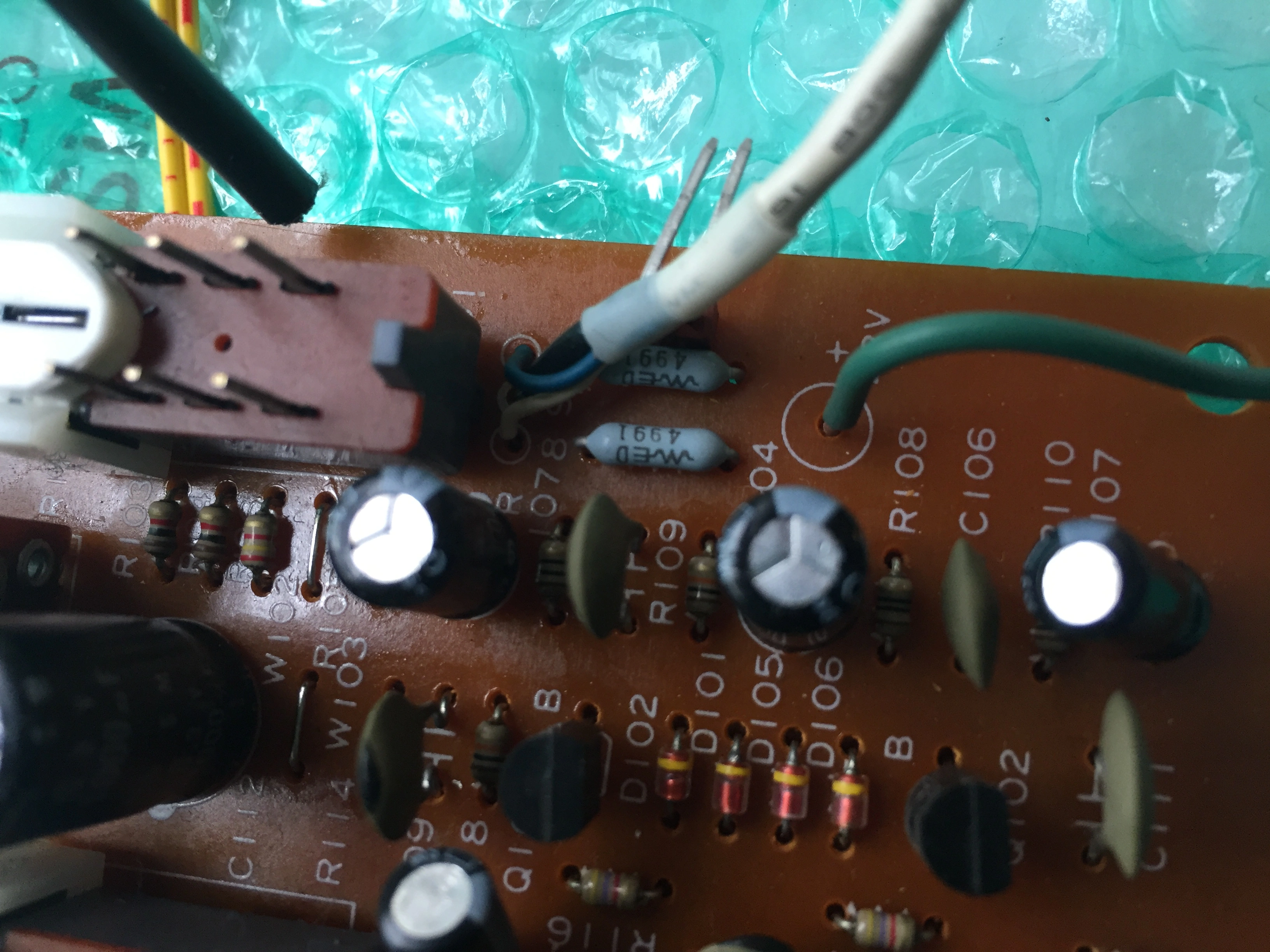

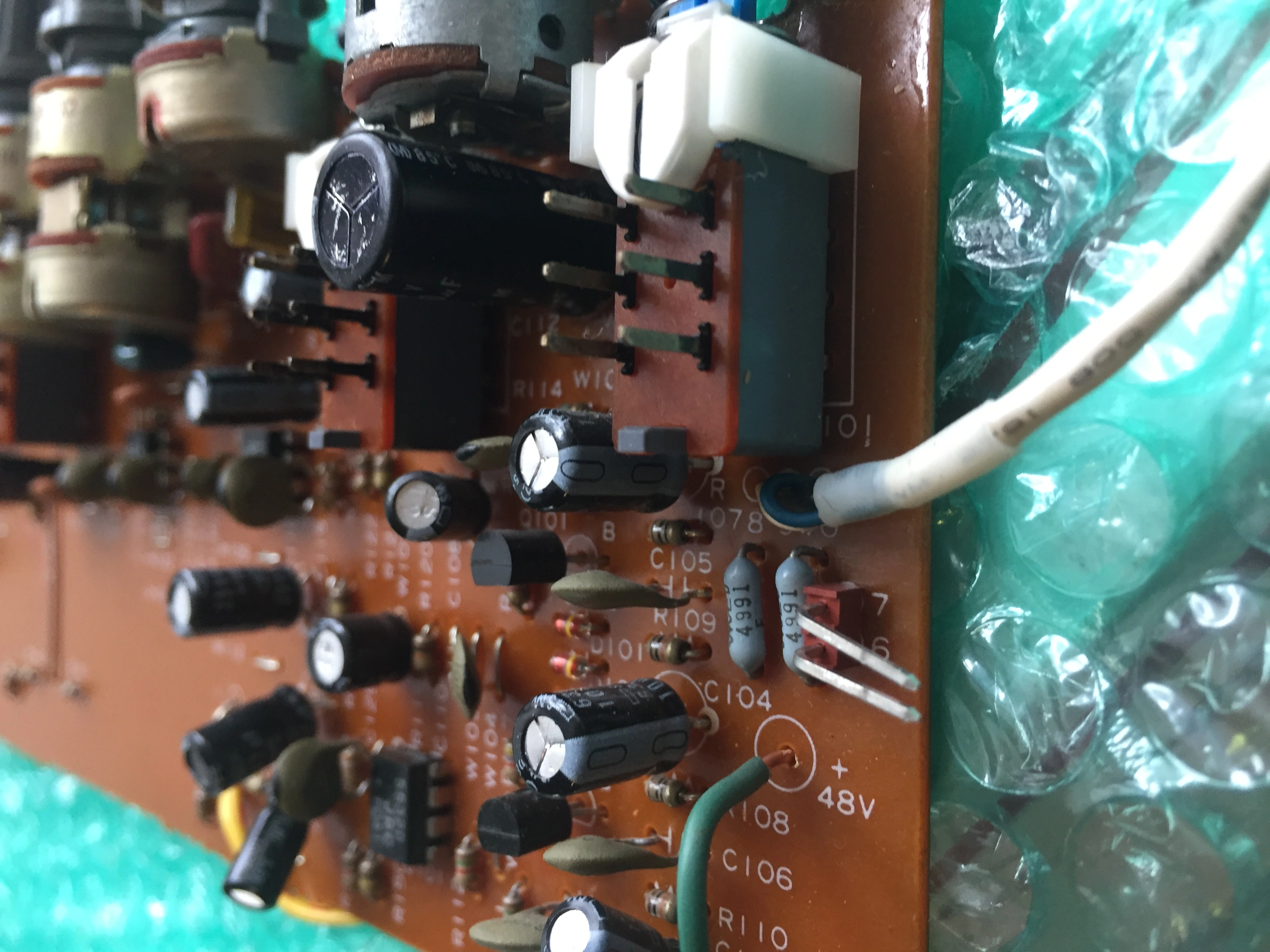

I was looking at putting my replacement input card in and was looking at the mods that were done. Here's the replacement card:

I looked in the schematics and couldn't find those resistors (?) anywhere. I assume, I'll need to replace those blue ones with ones like were originally like the mixers right?

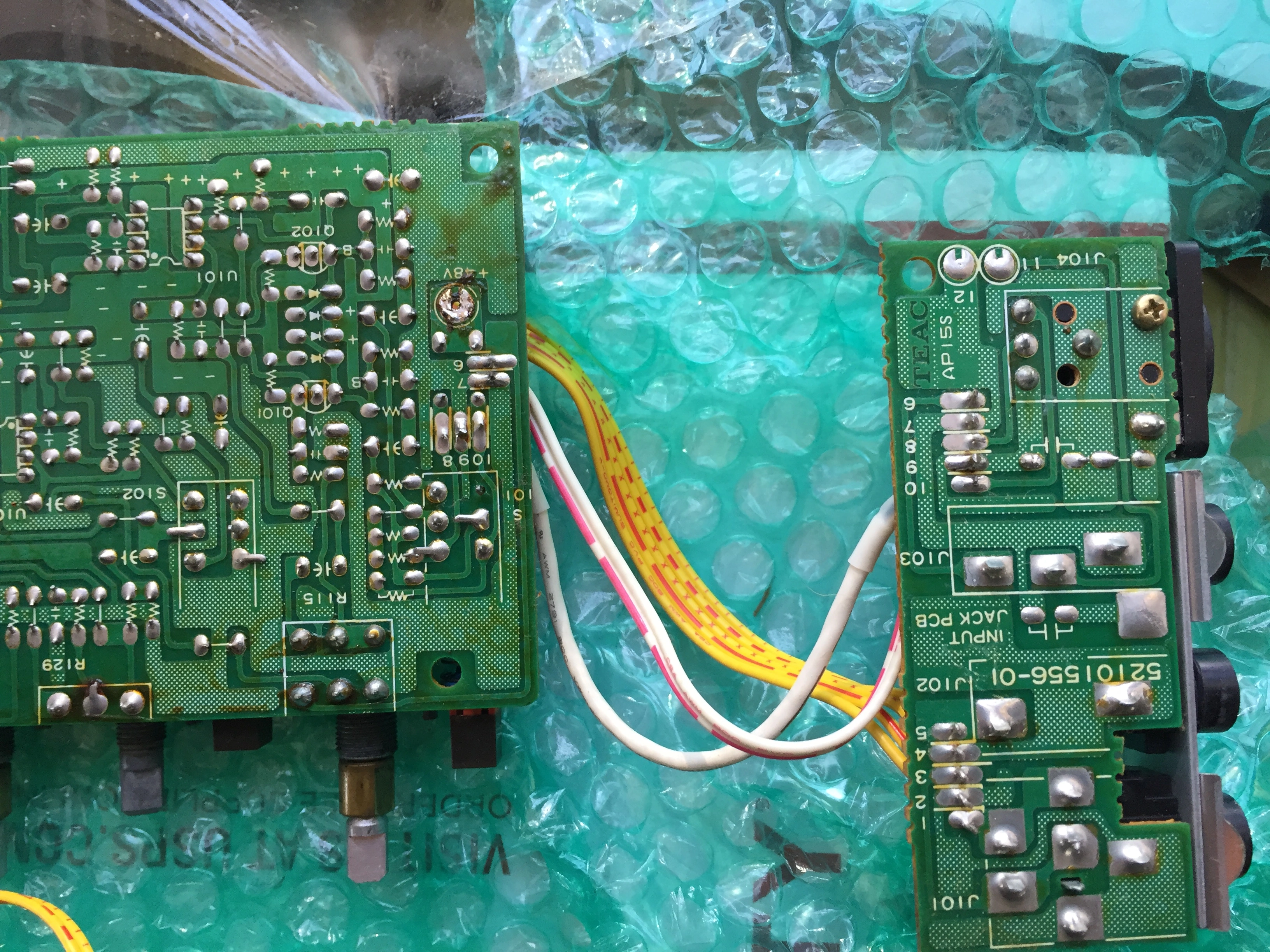

and here's the one I took out of my 312
Those resistors are not stock. And the parts they replaced I don’t think they were resistors.
I forgot about those. I’m away from the M-312 for a few days. I don’t recall what those resistors were doing there from memory. Can you tell me what the labeling says on the board for those parts?
I need to see what the parts are and what they are doing in the circuit.

Those resistors go between the Phantom power connector and terminals 8 and 10 on the card right? Where the hot and cold conductors from the mic jack connect (pins 2 & 3 of the mic jack) right?
You can’t find those resistors on the schematic because (I’m guessing) you aren’t looking at the M-300B supplement...you’re looking at the schematic out of the original M-300 (not B) manual...no phantom power on the non-B M-300 mixer, so no phantom resistors. And you won’t find them labeled on your spare card because it’s a non-B card, and somebody added them. But the *only* difference between the non-B and B version input PCB is the phantom connector and phantom resistors.

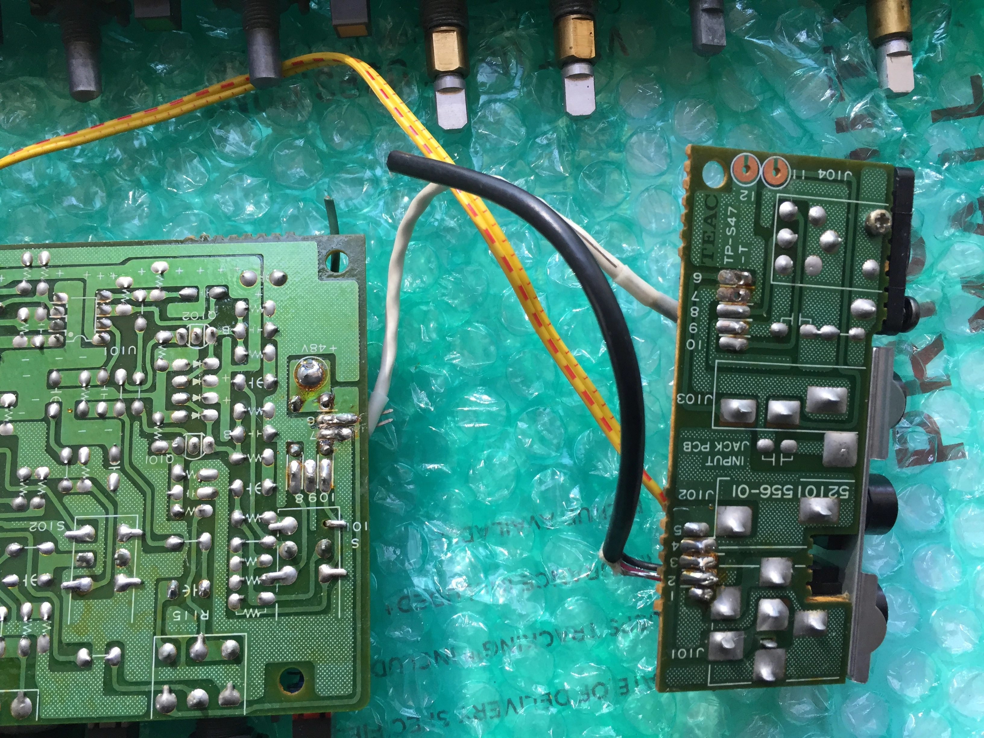

Can you put up a pic of the solder side of those blue resistors?
They used decent quality parts.
Measure their resistance. 6.8Kohms right?
On the replacement board, each resistor measured 2.97 Kohms
It should be a high enough resolution that you can zoom in.
Just for comparison sake, I measured the resistance on the original board and they were 3.9 Kohms each, and here is the solder side of the original board I took out of the mixer.
I guess the shape of the components is throwing me a bit. The blue ones look like resistors, but the brown ones off the original board look like film capacitors? Again, its probably my lack of familiarity with the components

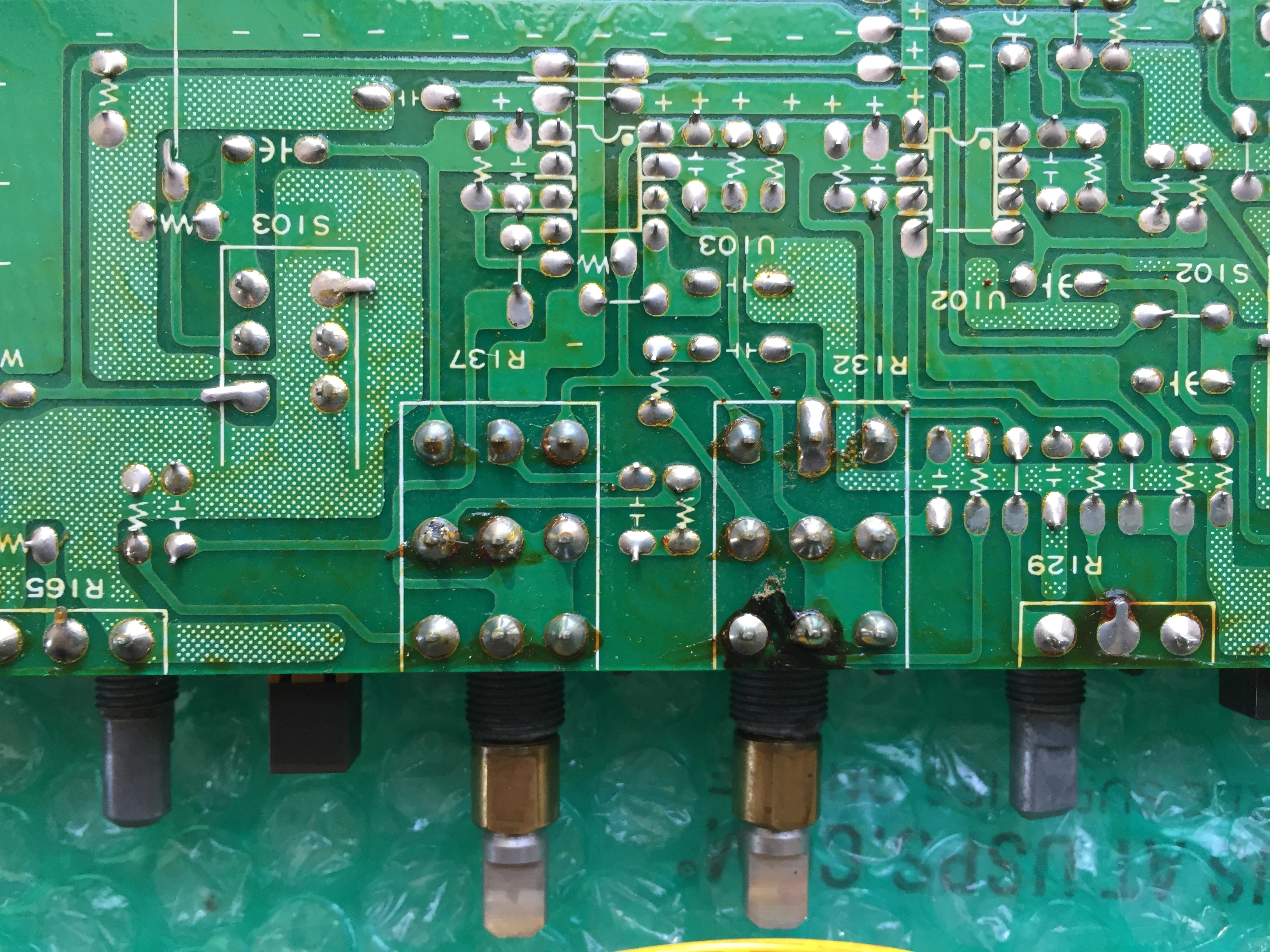

Another thing.... I inspected the original board more carefully and noticed a blackened area right where the equalizer pot that is squawking is. I don't know if its coincidence or not.....Here's a pic:
In the upper part of the blackened area, I scraped away some of it to see if the board was damaged underneath.... it doesn't appear to be.......
Can you put up a better picture or two of the phantom power resistors on the stock input PCB?
They are resistors...you wouldn't be measuring 3.9Kohms if they were caps.
Looks like the replacement board from the M-300 is the same as the M-300B.
You should be fine with those replacement resistors...no need to replace those.
That blackened area, I'm pretty sure that's just from soldering...blackened varnish. There's nothing that would be flowing through that potentiometer that would heat things up like that, so I'm pretty sure its just scorched varnish. If you want, gently take a small flat-blade jeweler's screwdriver and scrape the stuff away and put up another pic or two.

Those resistors just look different because they are older metal film 1/2W parts. I think those are decent quality parts, but so are the replacements on your replacement board.
