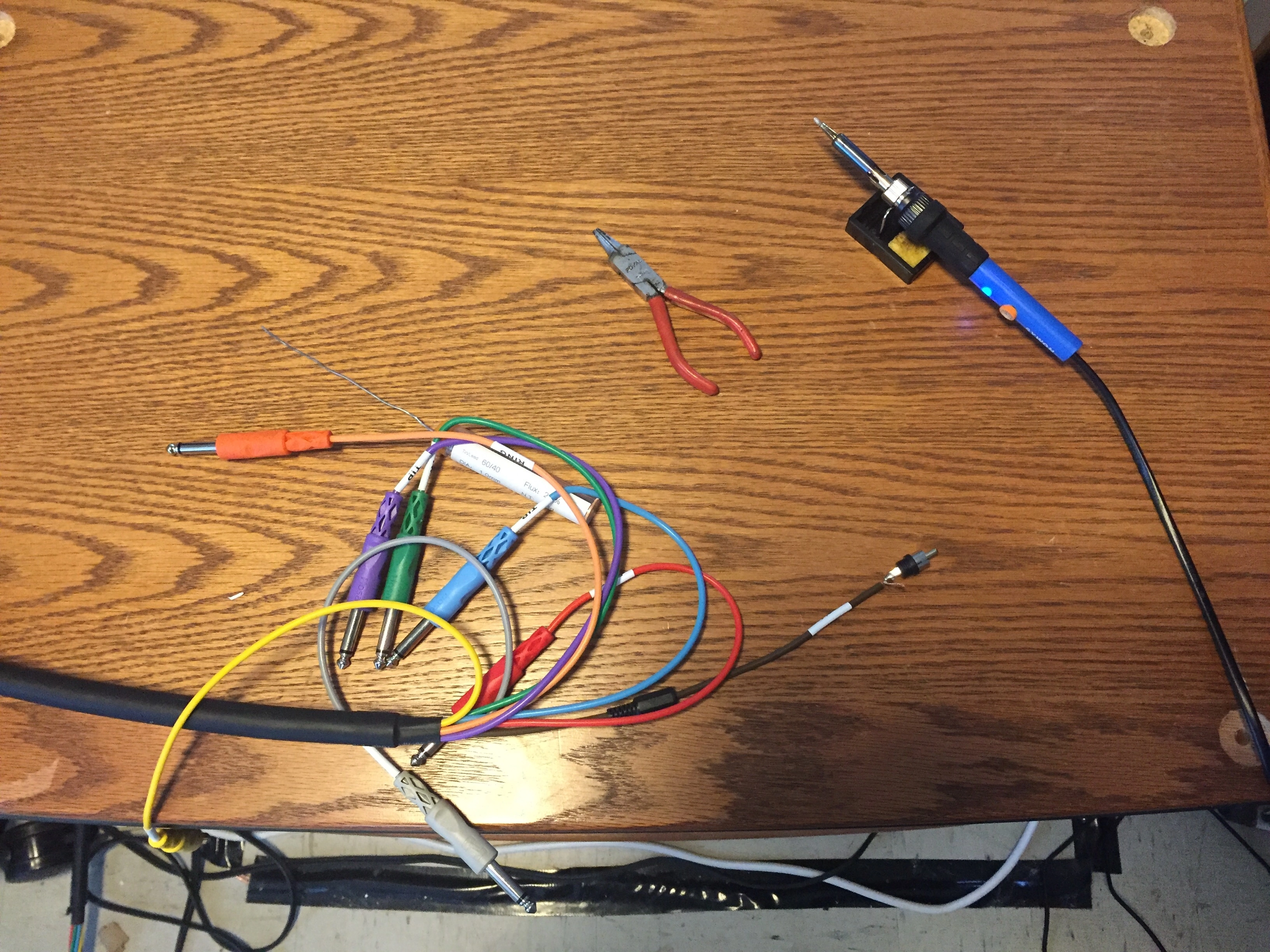

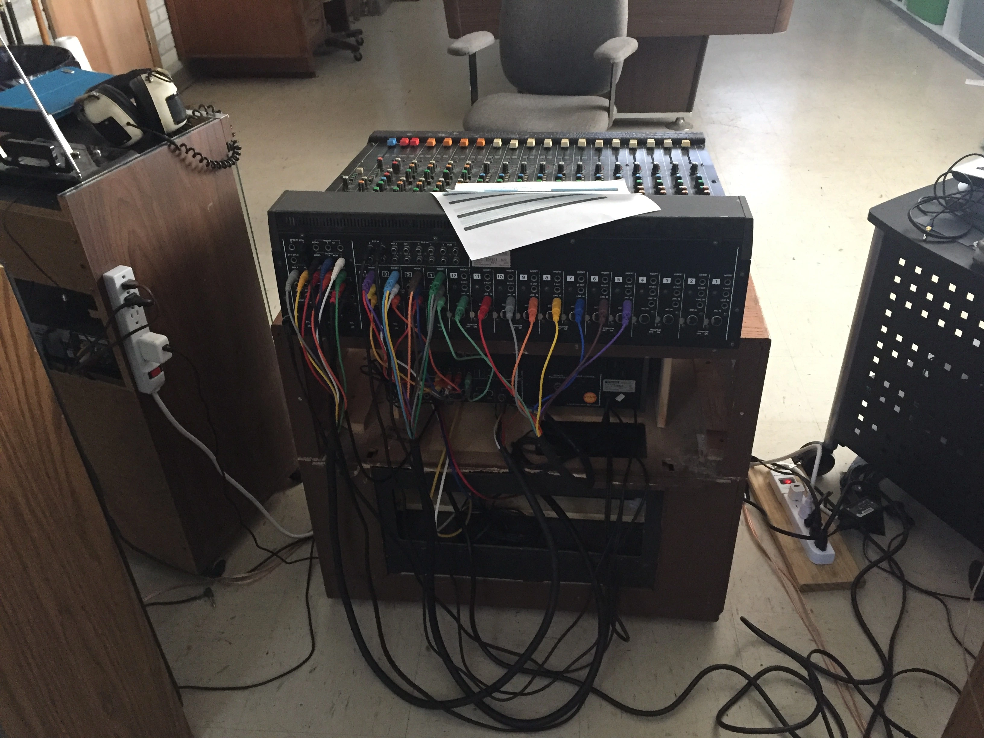

Before I started that, I was doing this.....
I learned a couple of lessons here too..... don't use the cheap chinese RCA jacks (either they are way to fragile, or I am not a gentle man....) and get a vice for doing solder work...... Vice grips aren't the answer (.....although one vice grip working as a stand holding the other vice grip working as the vice was better......) :D

I often just lay a hand tool with rubber-coated handles on the wire to which I’m soldering the plug to hold it in place. Alternatively I have a suction cup base vise with rubber padded jaws to hold small work without damaging it. The jaws of the vise attach to the suction cup base on a ball joint so the vice head can be positioned pretty much any way I want it.
ALSO...I use these for cable-mount RCA plugs...chuck-type strain relief...really like ‘em:
Neutrik Rean NYS373-0 RCA Plug Connector Black Shell

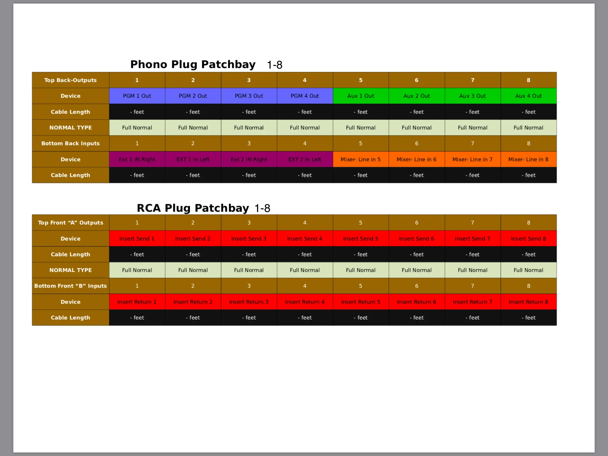

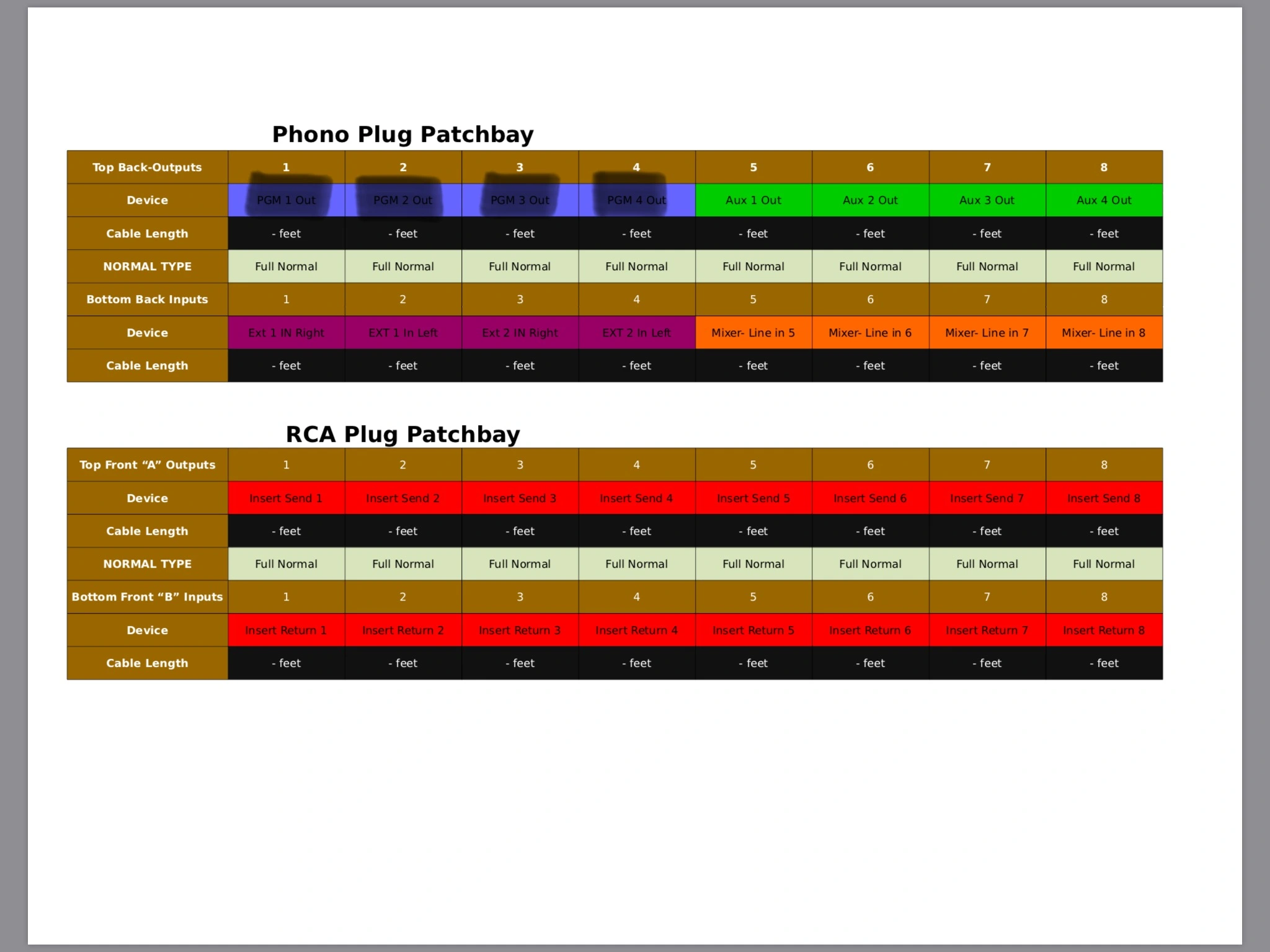

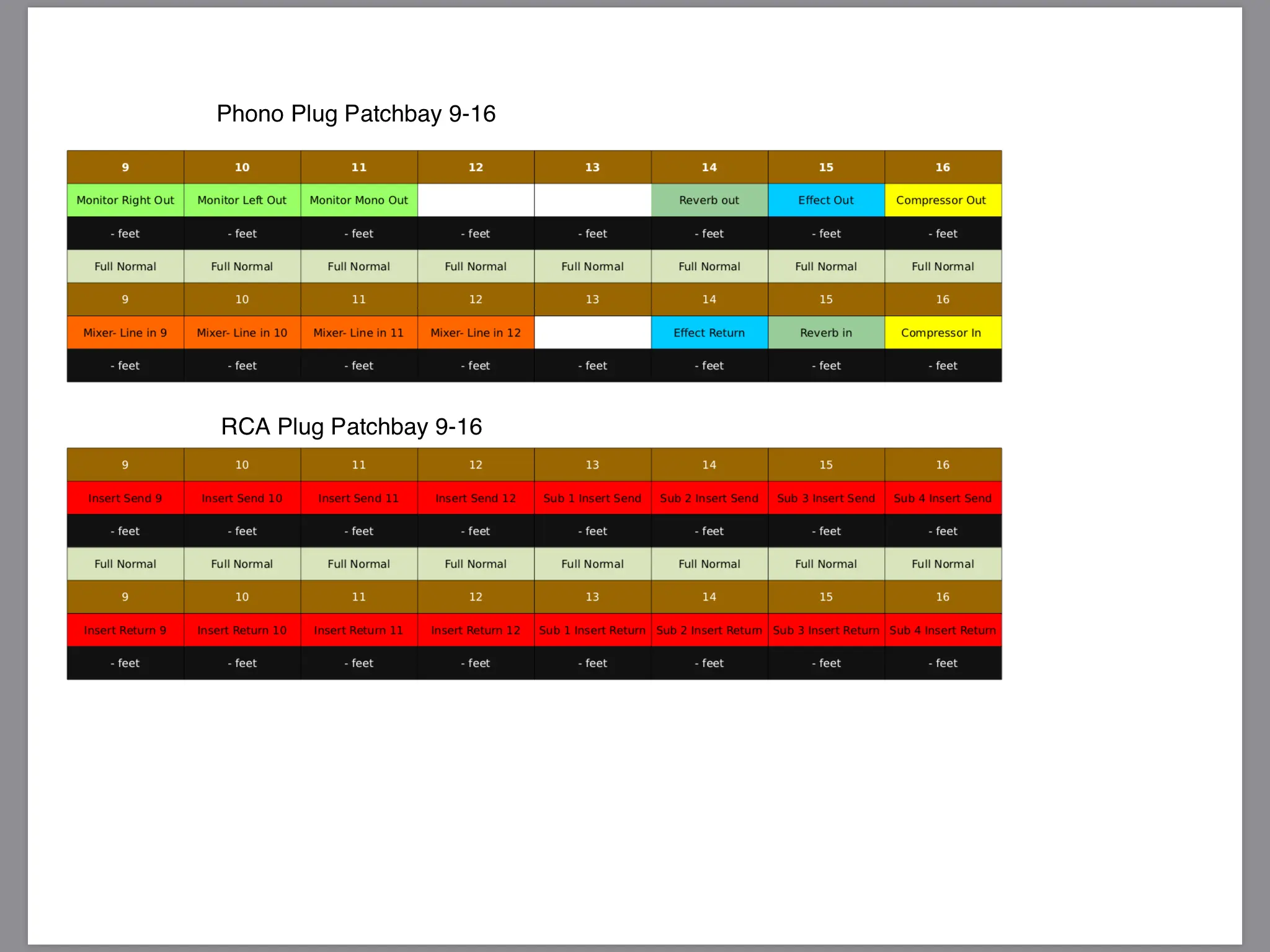

In the meantime..... Here's what I have kind of drawn up for the patchbays (which I use as an interconnect diagram). I understand what you're saying about the inserts, so I have the one whole patchbay dedicated to them.
I might have went overboard with the PGM outs and the Aux outs, but I want to see how I can use them (headphone mixes etc.....)
If anyone see's anything that they would do different, please let me know.

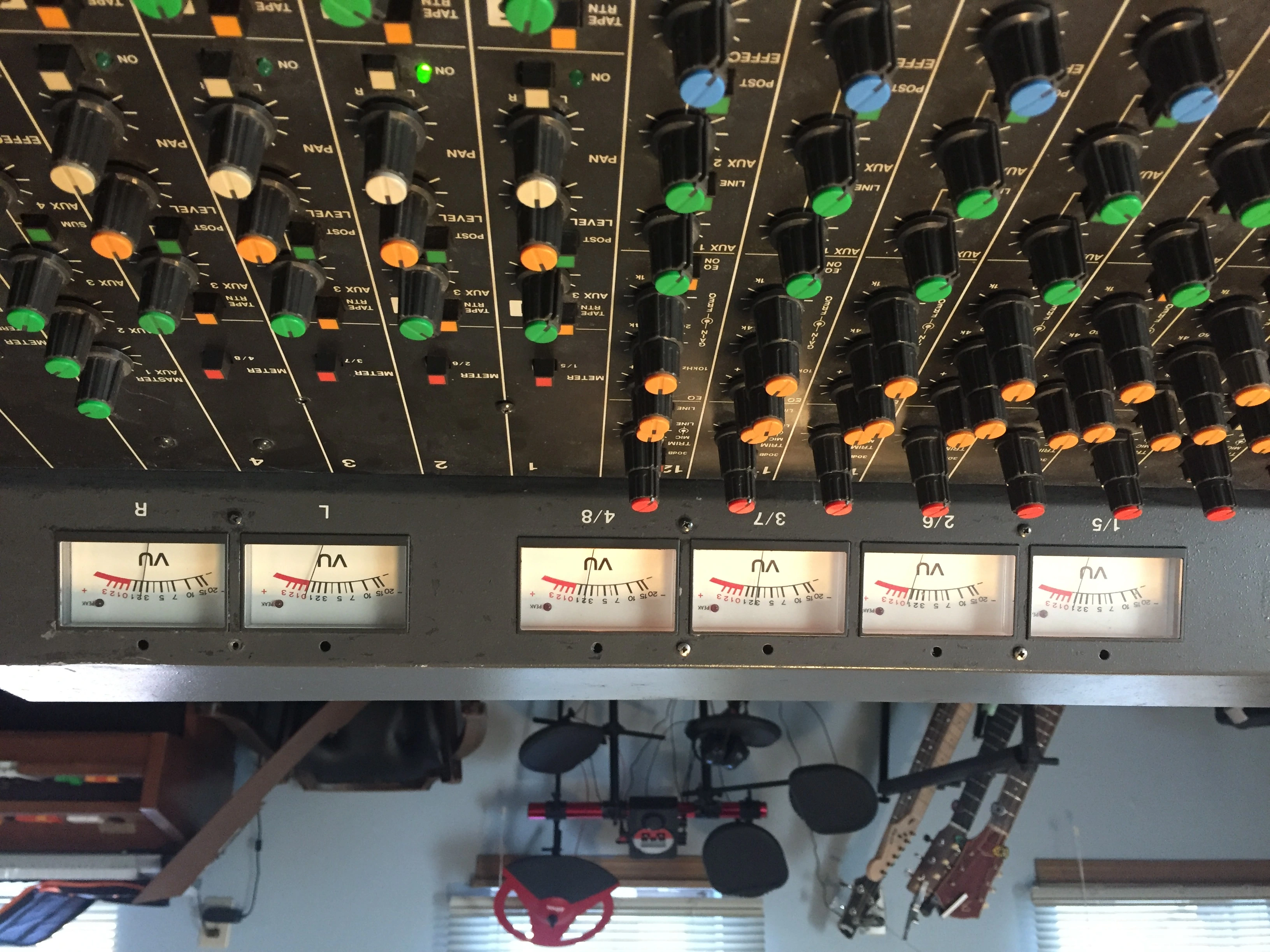

A Picture of almost doneness..........
I'm hoping this is it for the short term..... I'm going to put her through her paces tomorrow (I'd do it tonight, but my wife sings and I play guitar for her......)
My goal was to record in February and I do believe I'm going to make it!!

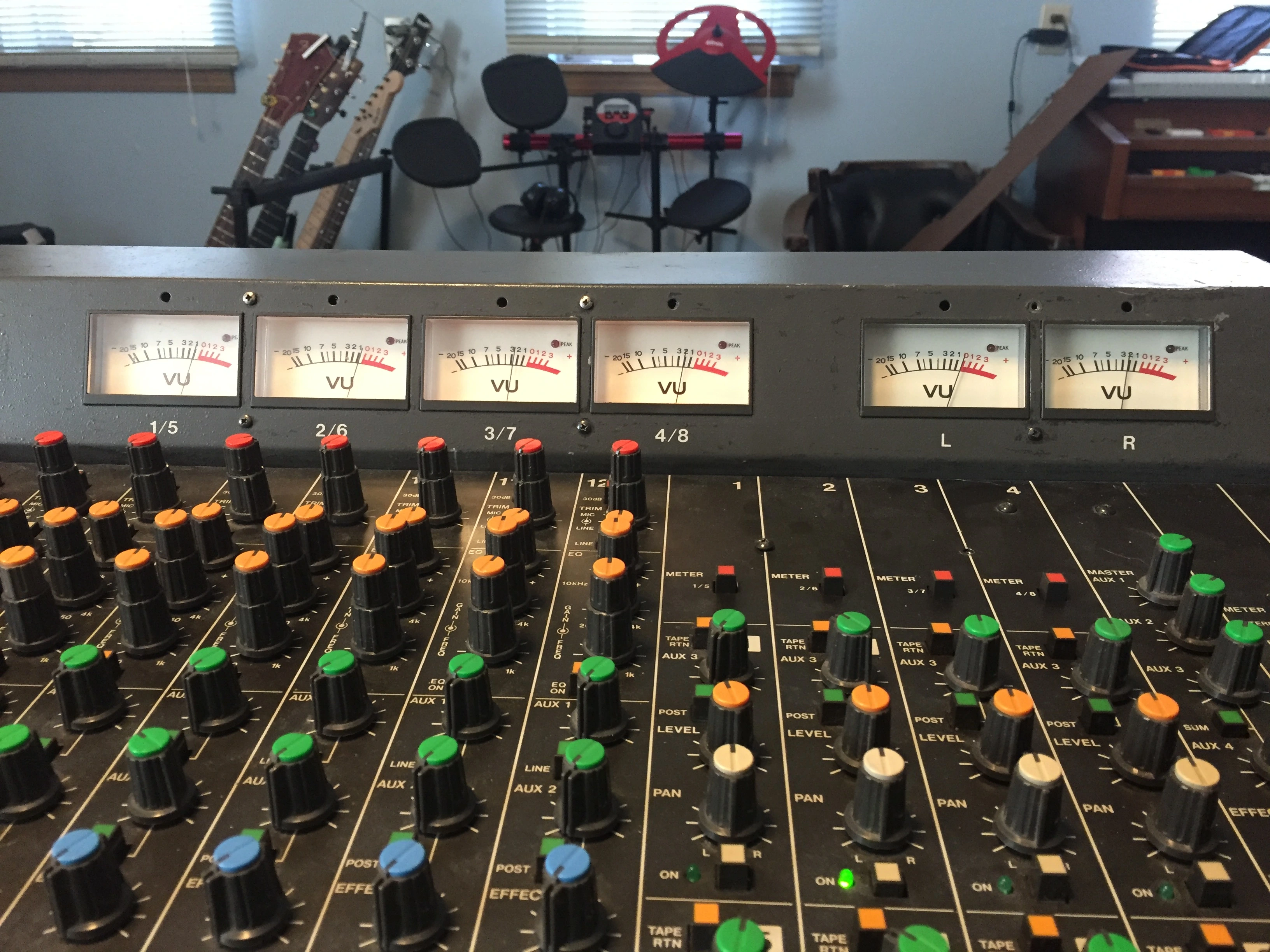

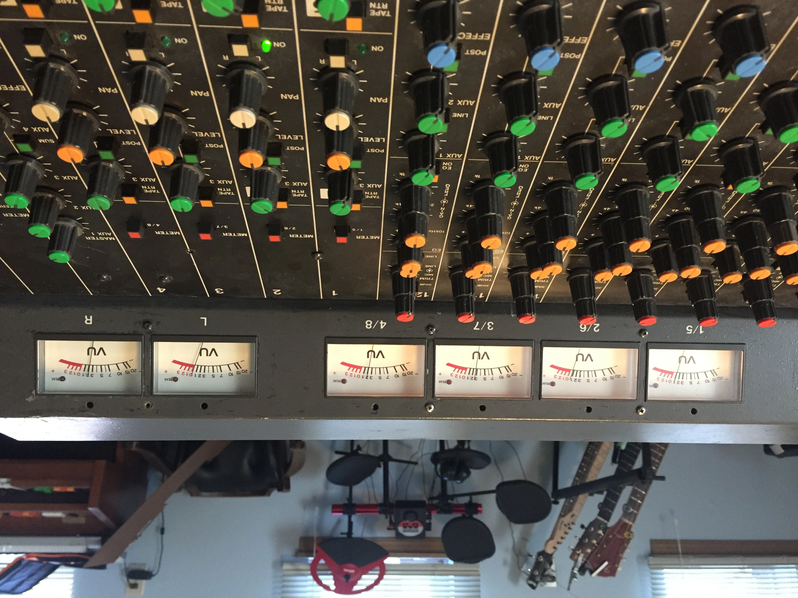

Once again...... thanks to the masterful coaching of one Mr Beats, I now have a fully functional mixer.... It's not 100%, but at least it all works.... two days before recording starts!!!! Thanks again sir!!!

Sonthe big question is, did you drop in the replacement meter assembly, or did you use the salvaged 4558 opamp and swap that part out on the original meter amp board?
And what issues remain? I lost track...just curious for AFTER music month.
